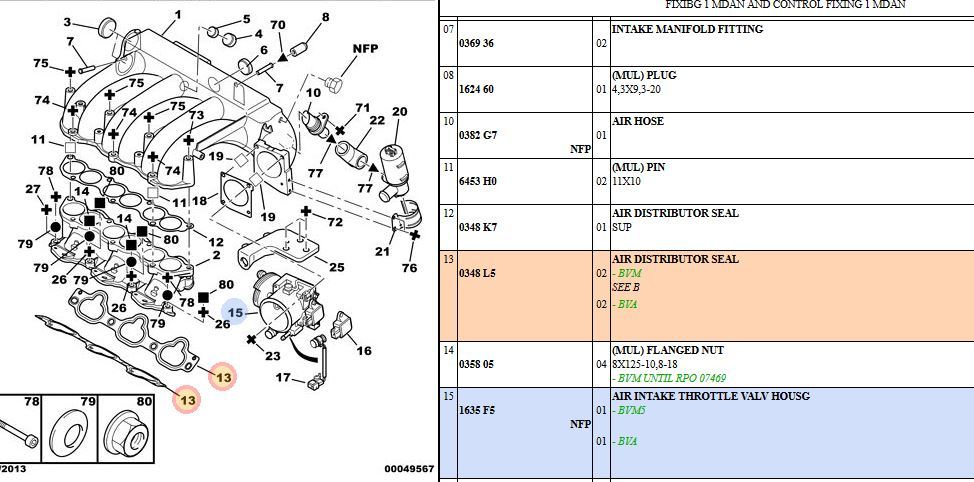

FYI,
Air intake seals (intake chamber to engine intakes, 00348L5 x2) for the V6 engine are NFP..........

Re: I am an Activa owner...a V6 and I am an addict
That's a bit unhappy-making, especially as I really need a set..
It's getting slightly worrying just how much now is going NFP for the V6.
Having said that, with care and the kind of gaskets they are - steel with squishy O rings - they are reusable...

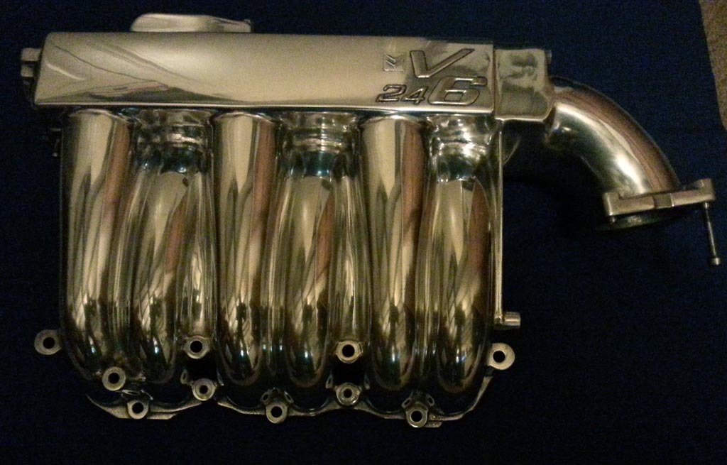

Well, I think I will call that finished.....OCD strikes again !
sorry for the slightly s**t pic

I like the logo on it Alasdair. How did you do that?
- Posts: 11838
- Joined: 28 Mar 2013, 21:05
- x 1996
The V6 and 24 comes from the engine cover, I am reworking this (to original spec/colour) as it is a bit scratched up so they had to come off that.
I now need to think how to do to that
The small aluminium chevron badge is from a Key fob

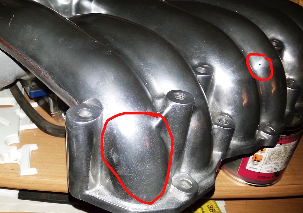

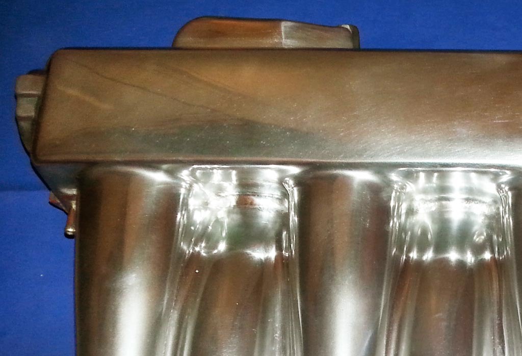

Below are examples of the deep contaminant pits in this casting...the alloy is PANTS and very thick but it is up to the job. As it is not really significant and was not designed to be polished so I cannot see any problem with it being used to be fair.
This shows how deep they are, I have flat sanded the top to reshape/square-up and even with this there are loads of pits that need taking out by hand
This was taken as I was working in the deep areas. Again, the casting seems to have a lot of body here so I was quite free in going in with a metal burr and stones to open it up and smooth it visually, it makes the next stage MUCH MUCH easier to fine polish with a small flap burr (insert a wet/dry strip into a long split pin and insert in a drill) and sanding sticks. (Obtain from Finger Nail supplies....great things and cheep)
Internally it is quite horrid with mismatched shape between the inlet/throttle body, flash and thick raised mould seams, the normal flaws with production castings. Now I have the seals/gaskets I will start the reshape/matching of that next back to the manifolds/throttle body. I only plan to smooth 60/70mm deep into the chamber as well as knife edge the internal bank/air splitter.

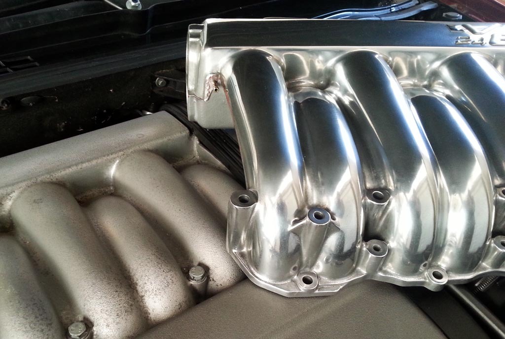

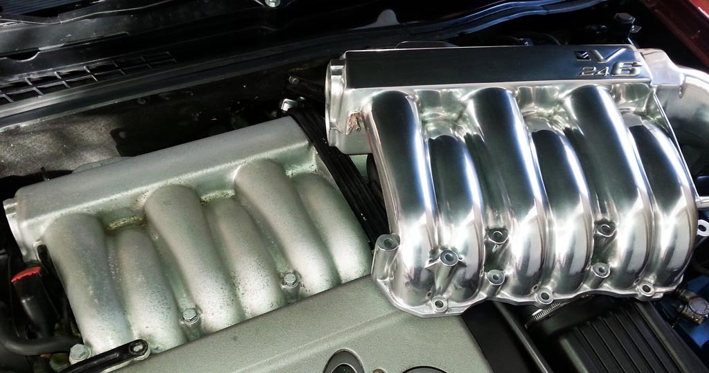

Some "Before & After" shots to show the contrast
FYI, the undersides are etch primer/silver paint btw....
