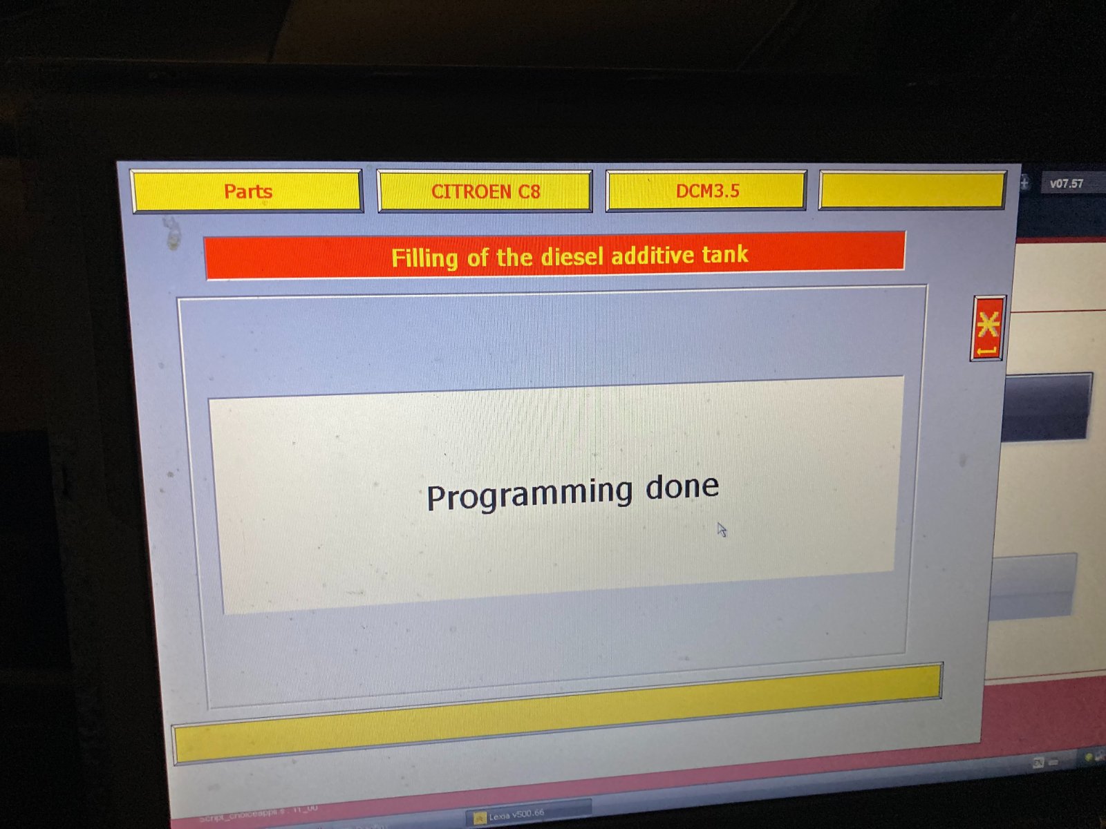

On our most recent drive to the Czech republic and back (1200kms each way) we had the ominous message on our C8 2.0L Hdi FAP "Warning : particulate filter at risk of clogging". From as much as I can ascertain :
1) This is related to the Fuel Additive system in the car - or Eolys.
2) I bought the additive (blue cap so powerflex) - filled it with 3L
3) Took an old laptop , did a fresh install of Windows XP and installed as best as a I could diagbox 7.57
4) Employed the interface I bought off ebay and plugged her in.

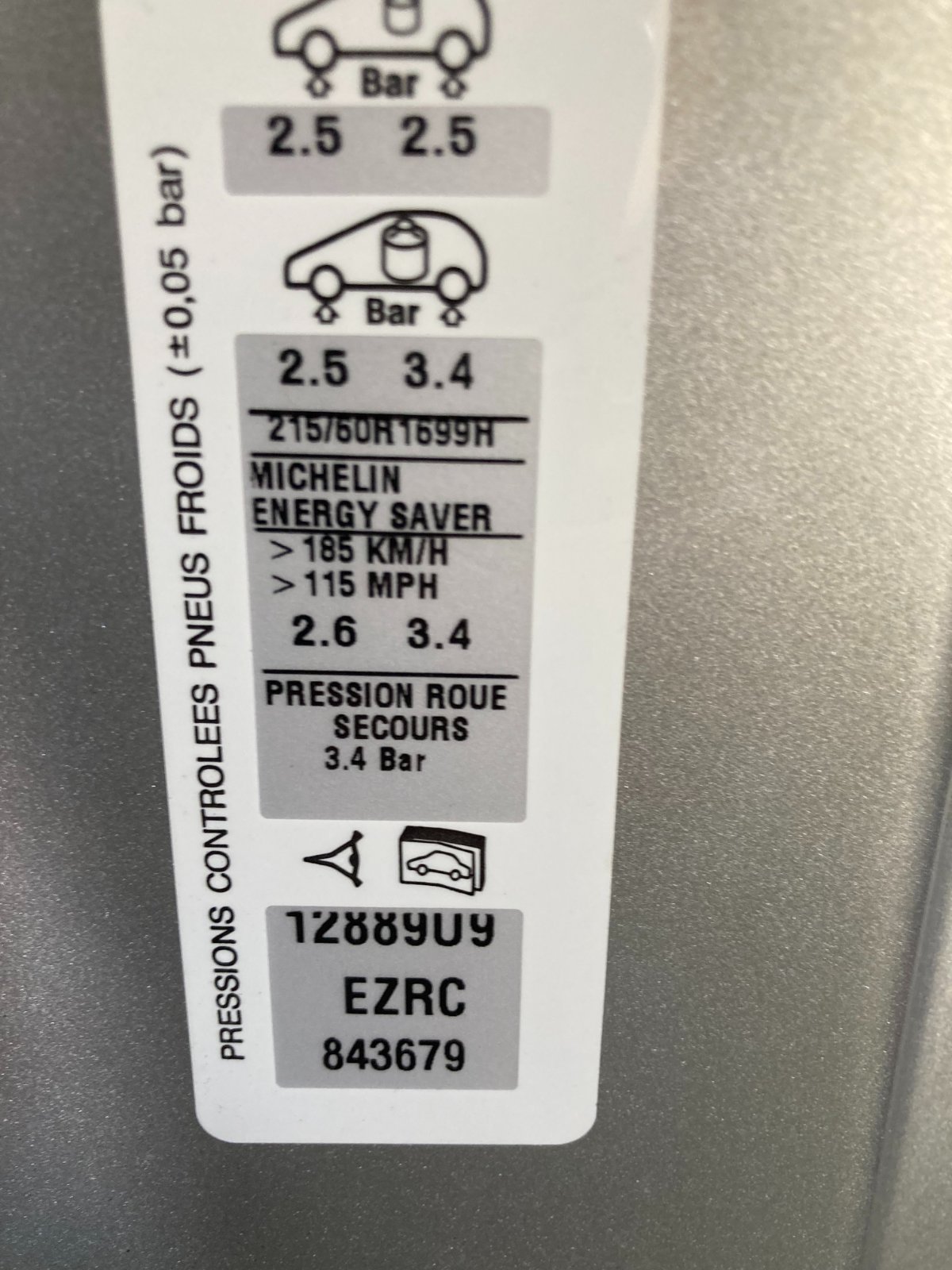

5) Found some menus under "Personalised maintenance" which seemed relevant although I COULDN'T FIND THE RPO NUMBER - although I did look up advice here that said it's on the A pillar - see picture - so I just used "88909". Is that correct ?
6) Within the menu for "filling of the diesel additive tank" I just entered there and immediately got the message "Programming done" - I thought I had to enter the volume I filled and mileage values.. Thanks for your help.

12889 is the RPO

Thanks a lot Marc, I tried 12889 - didnt seem to make much difference in diagbox. I was heartened to see it detected the VIN automatically. Did i get it right diaboxwise with that refill message ?GiveMeABreak wrote: 14 Jul 2024, 16:56 12889 is the RPO
Risk of clogging is not the additive level - that will generate a separate message. This means the filter has been unable to regenerate (despite multiple attempts by the engine ECU) likely as a result of stopping and starting or too short journeys that are preventing the exhaust gas temperatures from reaching the requirements before the filter can regenerate.
When this happens, it means you need to go for an uninterrupted drive of at least 40 MPH for 10-20 minutes (and I'd suggest you keep in 4th gear) to get the engine up to temp to allow a complete regeneration tot take place.

I put 3L into it - so not sure that qualifies as "refilling it" - it wasn't empty but after the 3L went in I still had nothing come out of the overflow hose. However thanks a lot for the help and the advice I'll get another 3L and put that in too - Is it correct that the tank's capacity is 4.5L as I read elsewhere here?GiveMeABreak wrote: 14 Jul 2024, 21:37 Yep, as long as you actually did refill the additive tank - if you didn't, then this will give inaccurate info to the engine ECU, so when the tank does actually need refilling you won't get a message and this can cause damage to the additive pump if it is allowed to dry-run. So now that you've actually reset the additive counter, I strongly suggest you top it up with a refill kit (unless you have topped it up), then you won't have to reset it again.
Thanks as always ,
rob
- x 6945
Re: Eolys?
No, DON'T add any more! 3 Litres is the max, you've probably topped it up now, that's plenty to see the car through the rest of its life!
