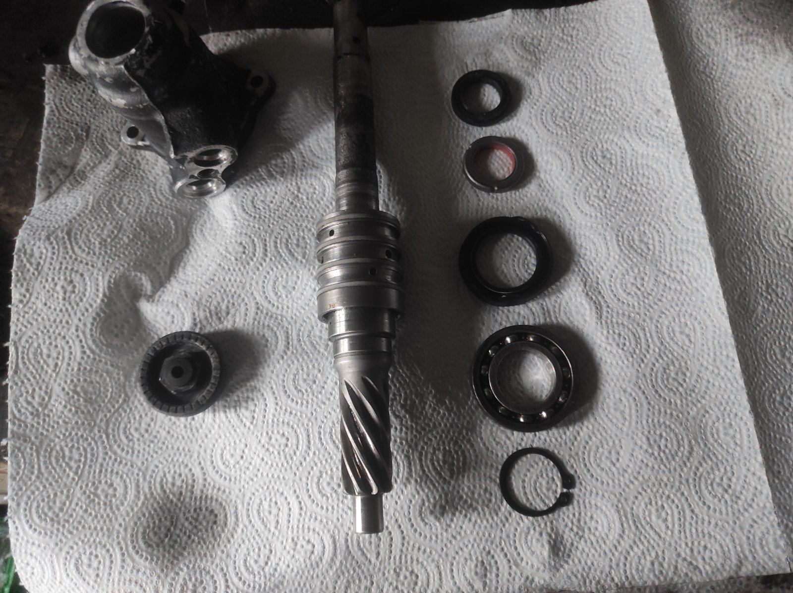

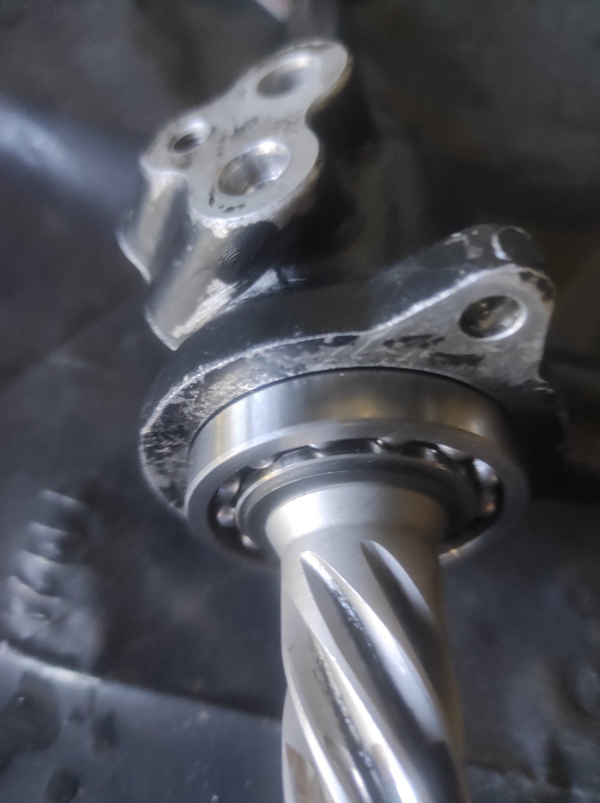

This is the pinion exploded, the bearing kept snagging every third full rotation for some reason. I couldn't get seal off without damaging it because of its placement.
Darren

Bearing 16005 is very slightly different dimensions:
25x47x8 = ignore me, just reread and realised the dimensions quoted were for the mystery second seal Not the bearing!

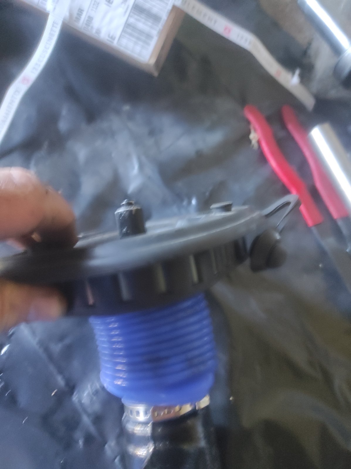

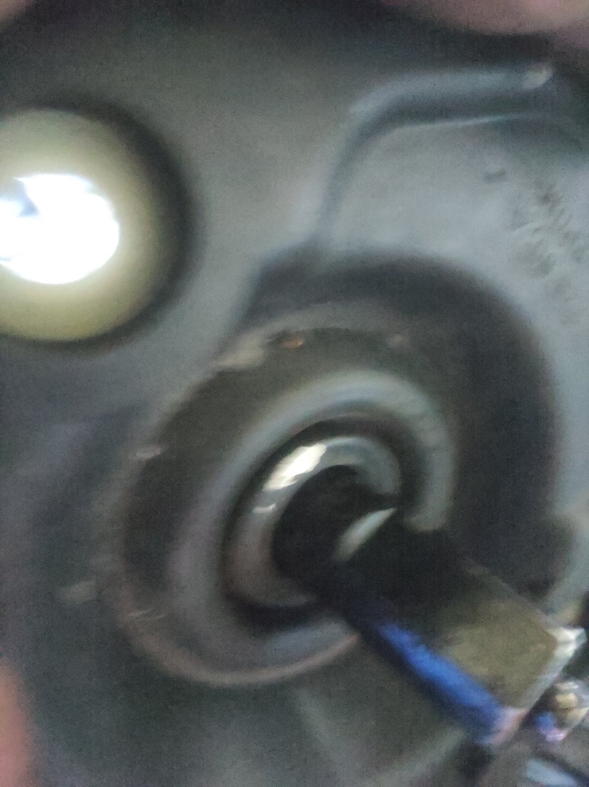

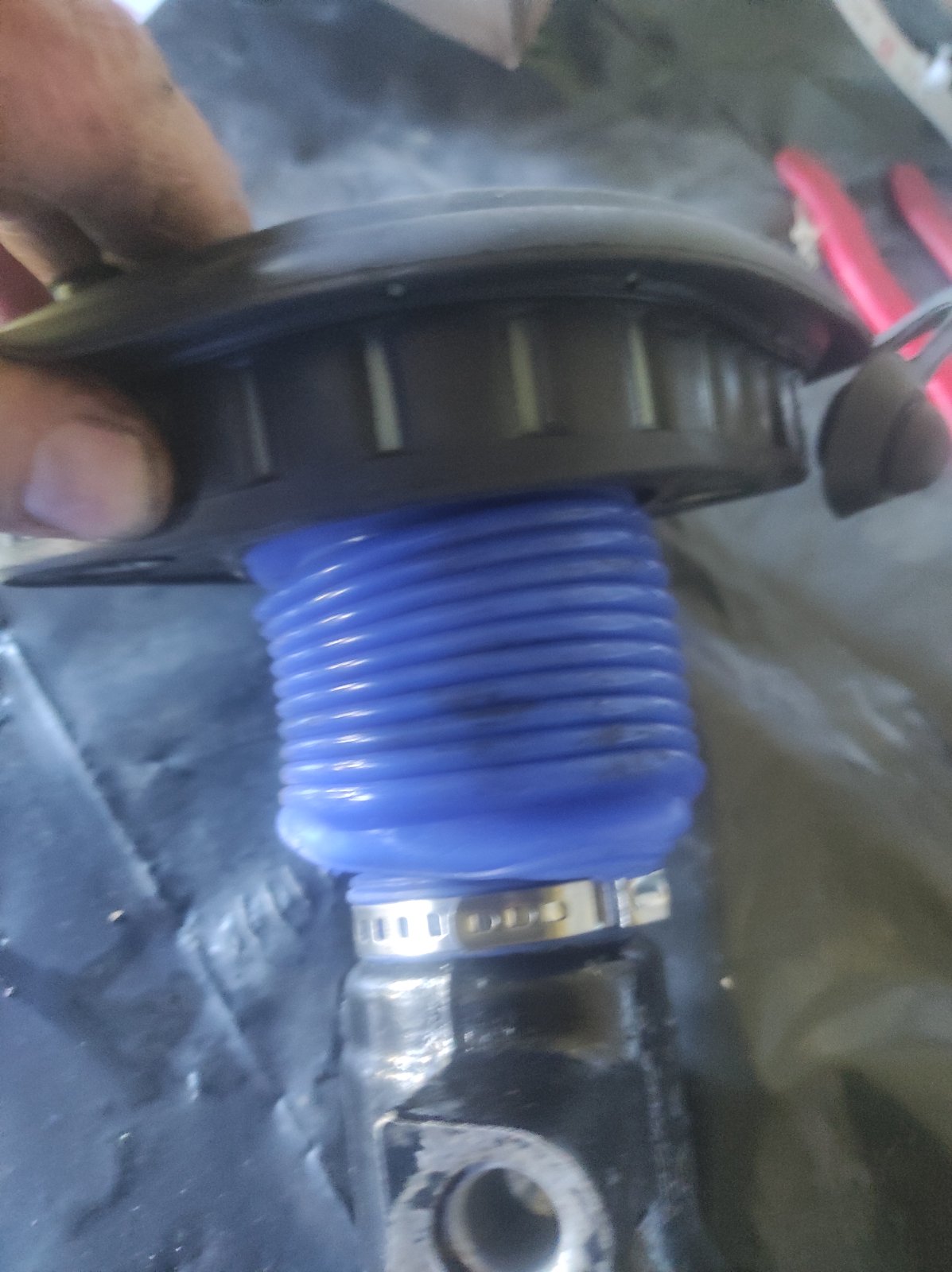

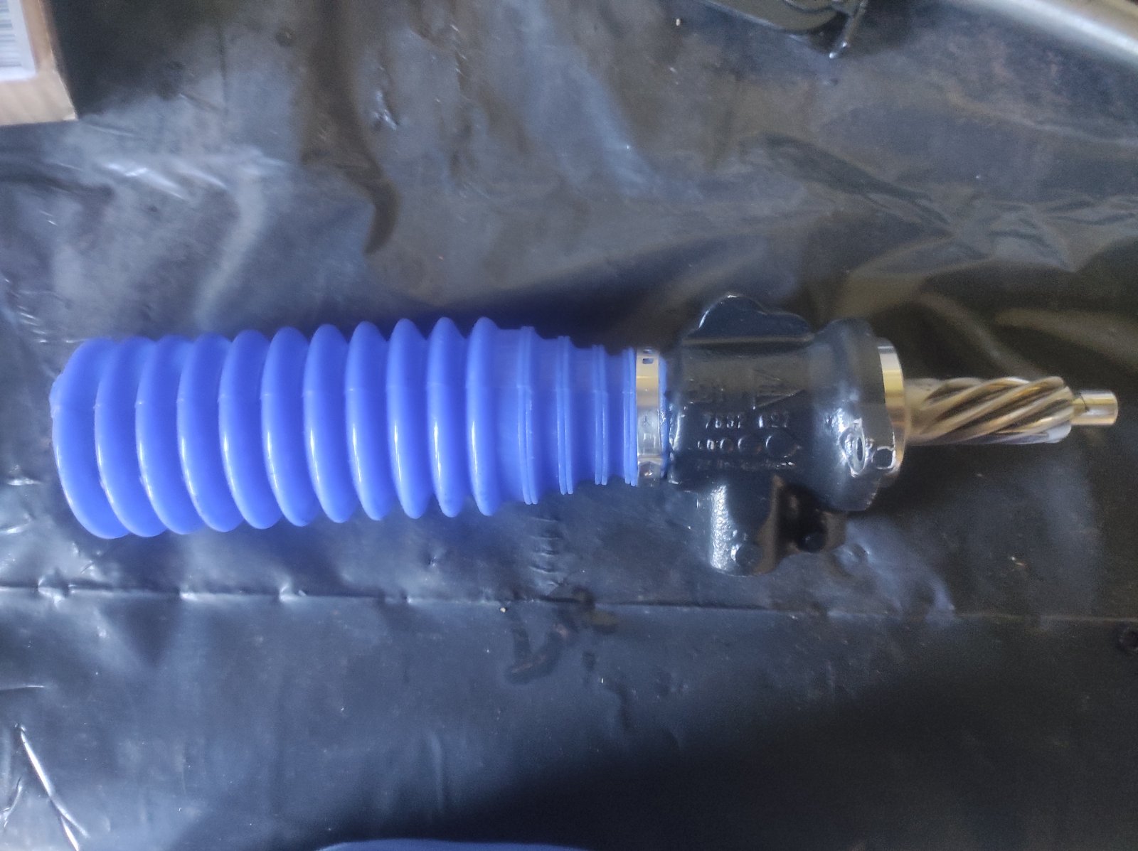

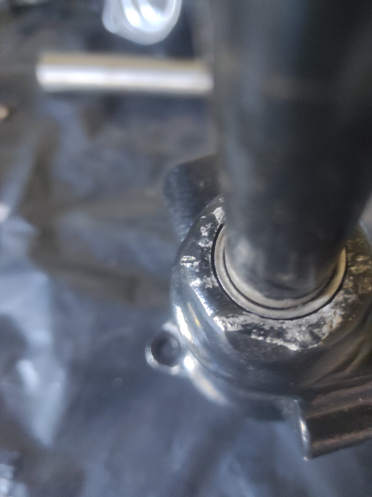

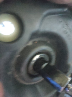

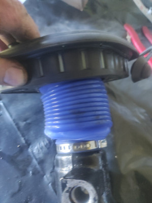

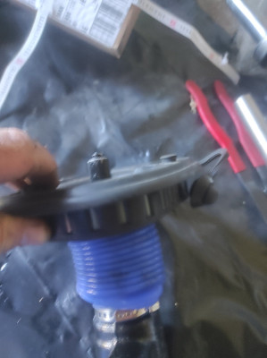

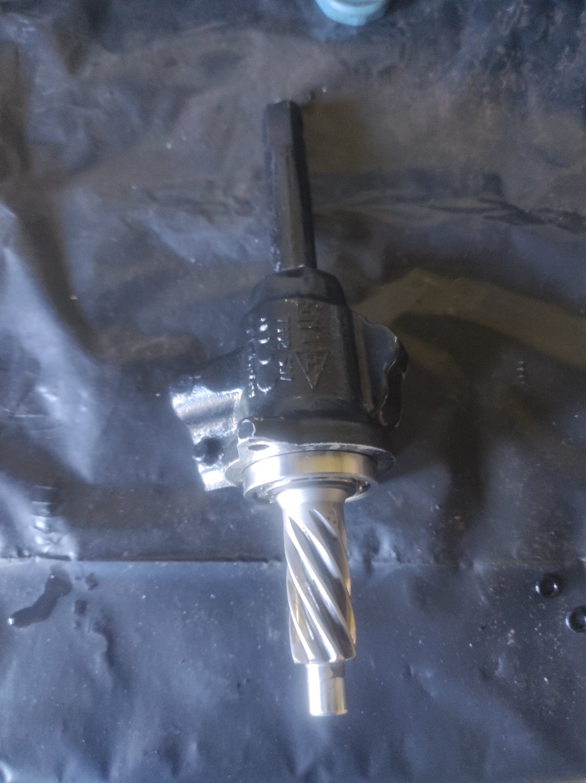

Hi All, Some photos of my rebuilt pinion housing and what I am using to protect the shaft.it also shows how it will sit against the cabin bung for want of a better word I didn't turn down the shaft on the lathe as it didn't need it and I just cut the nub off the housing with a sabre saw and ground it down 😁. The photos have uploaded in reverse order.
Darren

That looks great! Is the jazzy blue thing a steering rack gaiter or something else? Recognise the CV boot type metal clip, but never seen a blue rack boot :)

Hi Matt,
yes it's a very Salubrious colour for a rack gaiter but it's silicone, might withstand temperature and flexing a bit better I want to CV clip the top to the bung aswell if I can.

Unread post by Jay-Bruce »
I actually thought that the blue item was a shock dust shield when I seen it? Anyways, nice build Darren.
