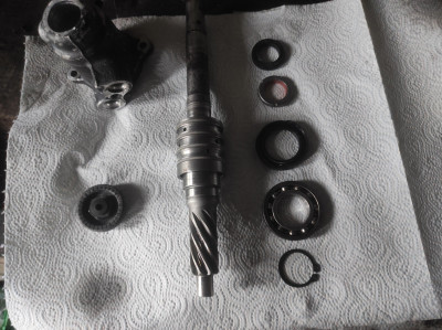

Re: C5 X7 Steering Rack - Again!
This is the pinion exploded, the bearing kept snagging every third full rotation for some reason. I couldn't get seal off without damaging it because of its placement.
Bearing 16005 is very slightly different dimensions:
25x47x8 = ignore me, just reread and realised the dimensions quoted were for the mystery second seal Not the bearing!
