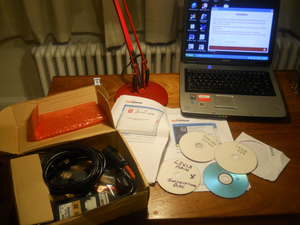

A while ago I bought a second hand Chinese Lexia copy & an old laptop running XP. Today I installed the disk, but didn't get as far as connecting to the car before it got cold & dark. I now have a couple of questions; I have 4 discs labeled Lexia Main installation disc (I used this to install), Lexia, Lexia V35 & Lexia V35 Zip files. What are all the other discs for?
Also I had hoped I'd be able to enable the CD Changer port on my daughters Peugeot 207 so she can connect her phone for music, but a screen shot shows a screen with only Citroen models on it. I had thought I'd be able to do Pug as well is that not the case or is there a work around?
