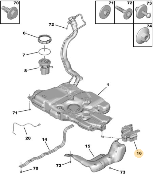

For the Eolys additive and your vehicle build date you require 'Powerflex' additive. You only need to top this up when the warning and message tells you on the screen. But remember, the tank is hidden under a heat shield next to the fuel tank and is gravity filled. You also need a professional level diagnostic tool to reset the additive counter or the engine ECU will not know you have done this.

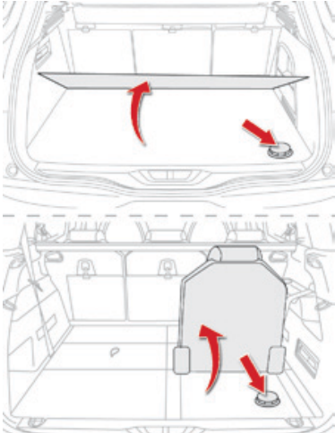

This is where you should find the filler for the Adblue (shows for 5 and 7 seater):
This is where the additive tank is for the Diesel additive (Eolys) shown at (16):

I buy 2 liter is this enough?GiveMeABreak wrote: 08 Jul 2024, 17:36 Ok, so the first link is for Adblue only (never put that in anywhere other than the adblue tank)
The second link is fine too, that's powerflex for the diesel additive tank.

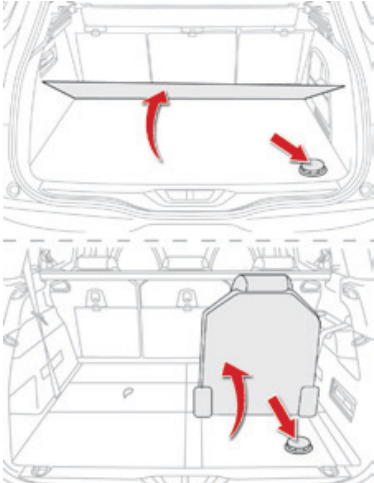

You should top up a minimum of 1 litre - but can add more until it's full.
