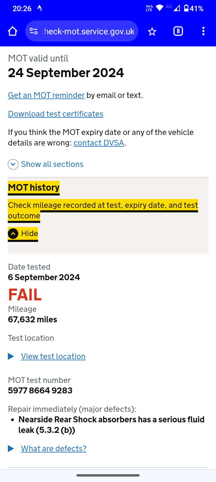

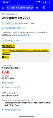

Surely not brake fluid, how about shock absorber oil?
- Posts: 12599
- x 1490
Re: Confessions of a Citroholic
That's the one. Appears the shock has failed somehow at the bottom, poss corroded through - never seen this before. I think I have only had one damper replaced over all the cars I have owned(*), and that was because the bush was stuffed at the bottom.
As expected
It could have had the decency to wait till after the test - as the 3008 did last year when it broke a spring immediately after the test - like on the way home!

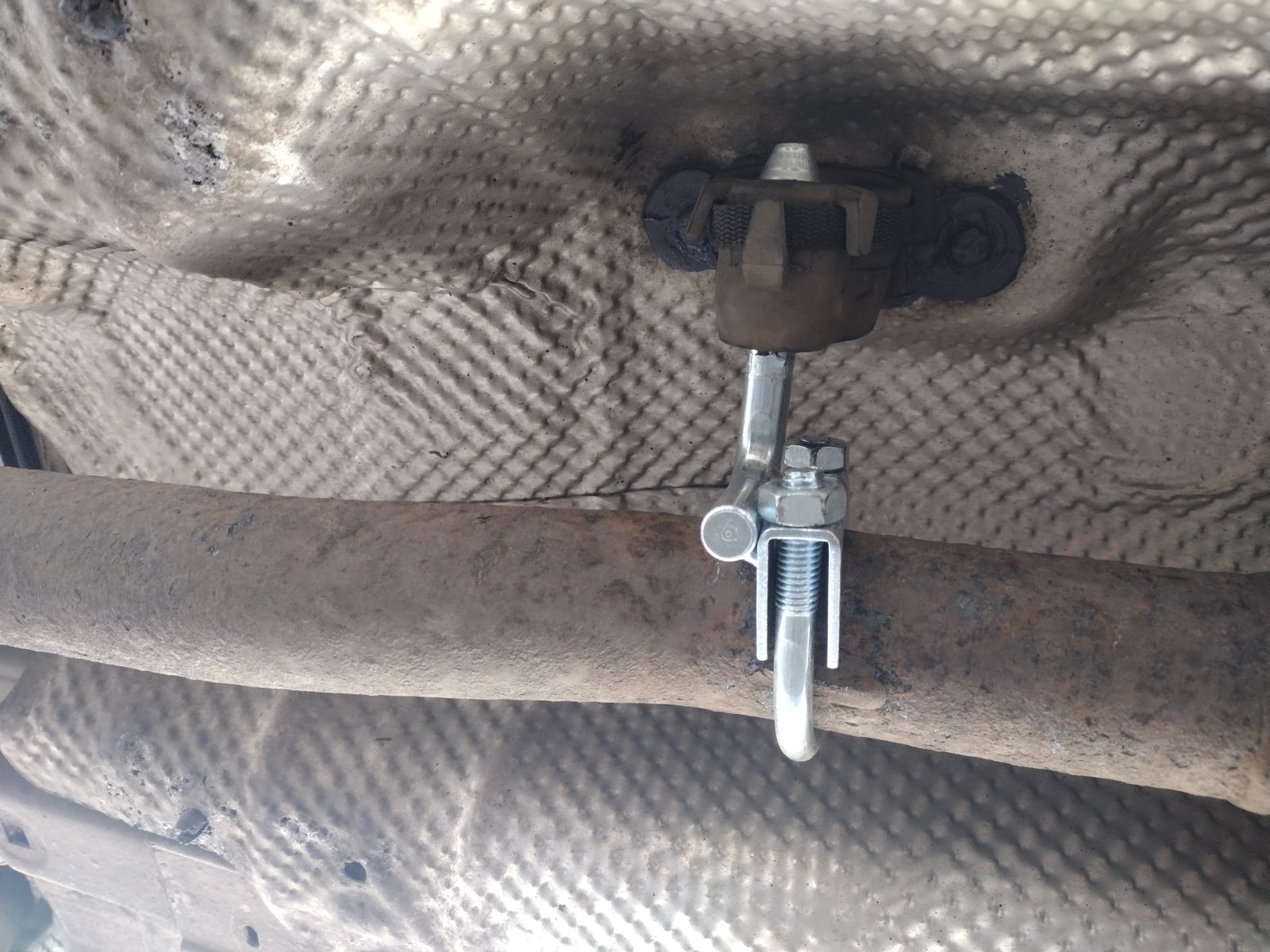

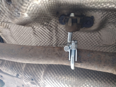

My wife reported that something was hanging down under the C4 - turns out to be the small heatshield on the edge of the adblue tank. It has rotted away where it is riveted on - I had previously wired it back on as one of the 3 fixing was broken, but the other 2 have let go - it was only still there because I had wired it on! Now wired on in 3 places... However whilst under it on the ramps I noticed that both side of the front undertray were broken and hanging down, so these have been cable tied back on - but also the centre exhaust mount has broken off the pipe. Don't fancy trying to weld it back on, I've had a go at making a clamp round the pipe bolted to the old support, but not right yet, will have to try again. This bit of pipe is available as a repair section and was fixed a while ago when the joint broke off at the front - however, it contains the NOX sensor, so replacement is potentially an expensive day out if the sensor won't come out!

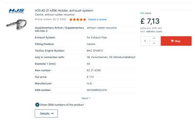

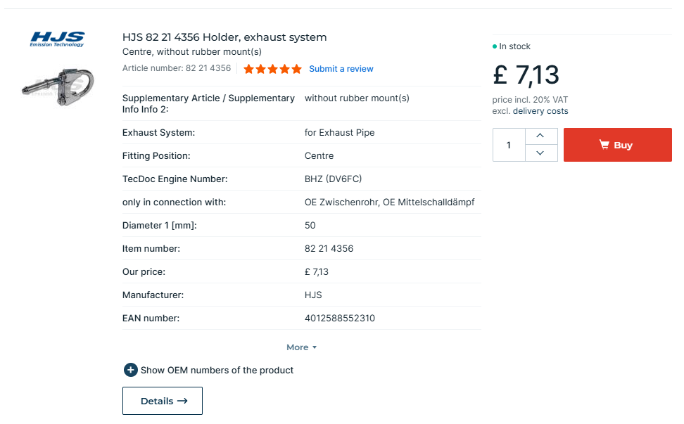

On the C4 I found that Autodoc do a repair clamp for the exhaust so I have ordered one
So I've ordered one. Postage was more than the clamp, but couldn't find it anywhere else easily.

The £7 clamp is a good fit, and easy enough to install, although I did have to remove the rubber and cut the end off the old clamp to remove the pin as it had a massive swage on the end.
