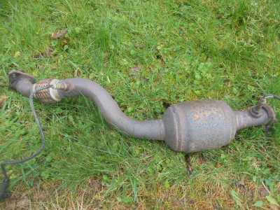

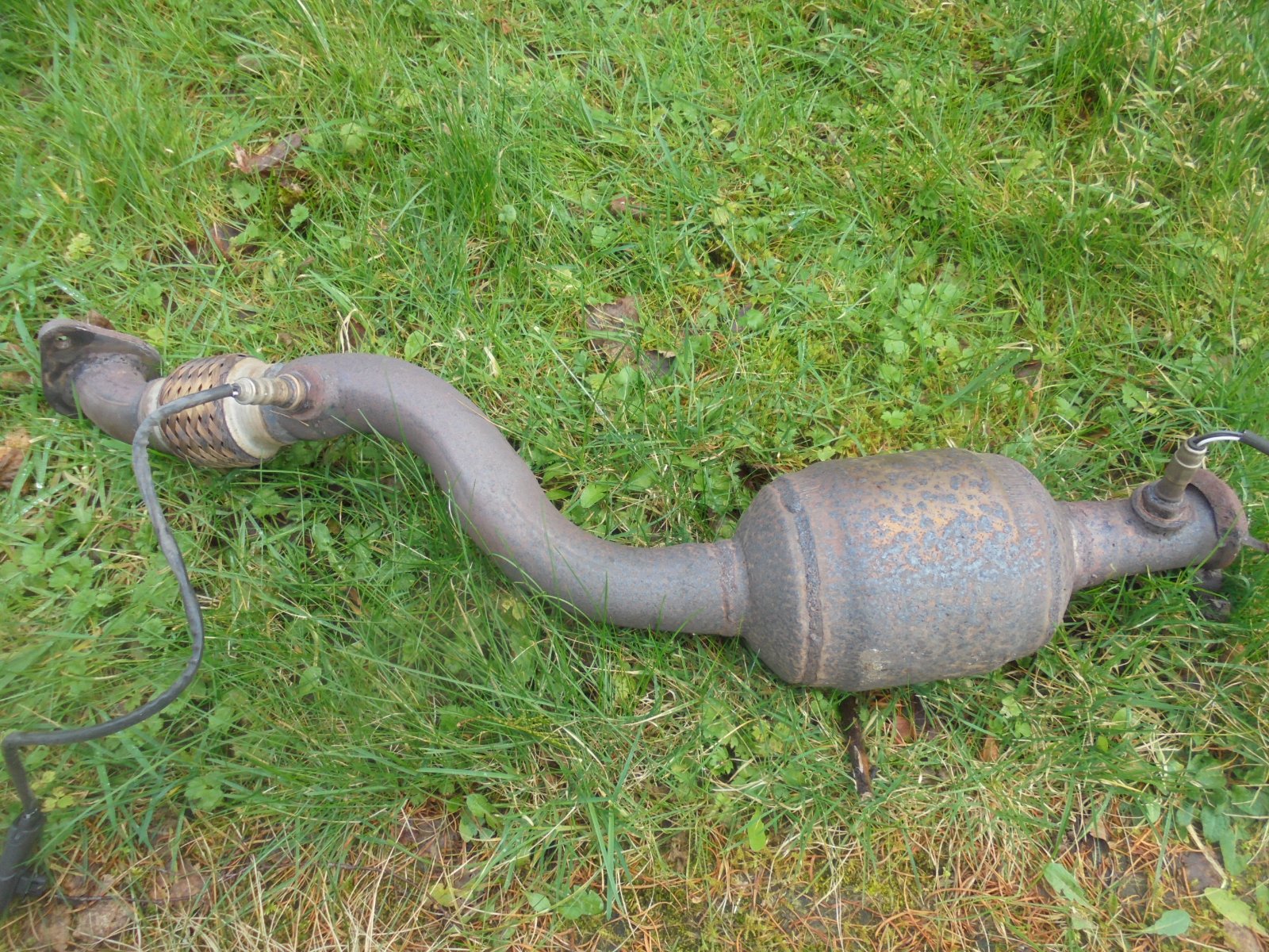

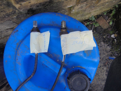

The first part of the job is now off the car and on the grass.
The upstream O2 sensor looks decently removable, the downstream one less so.

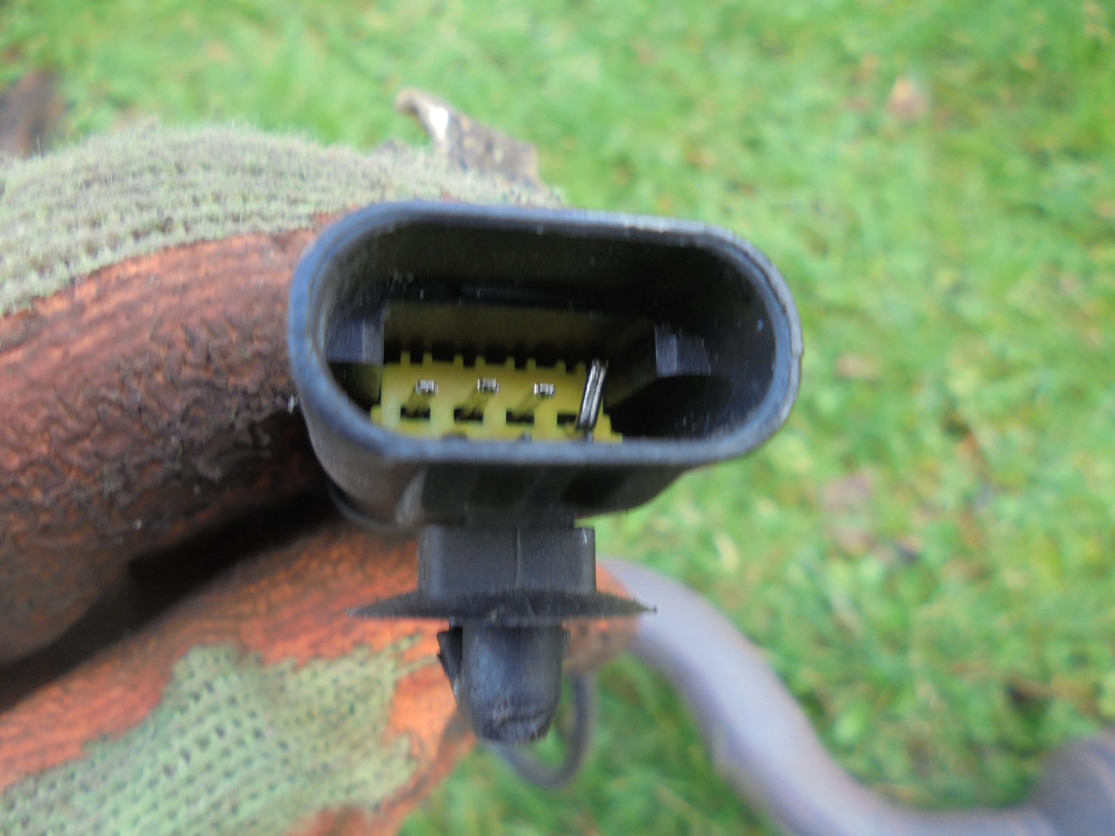

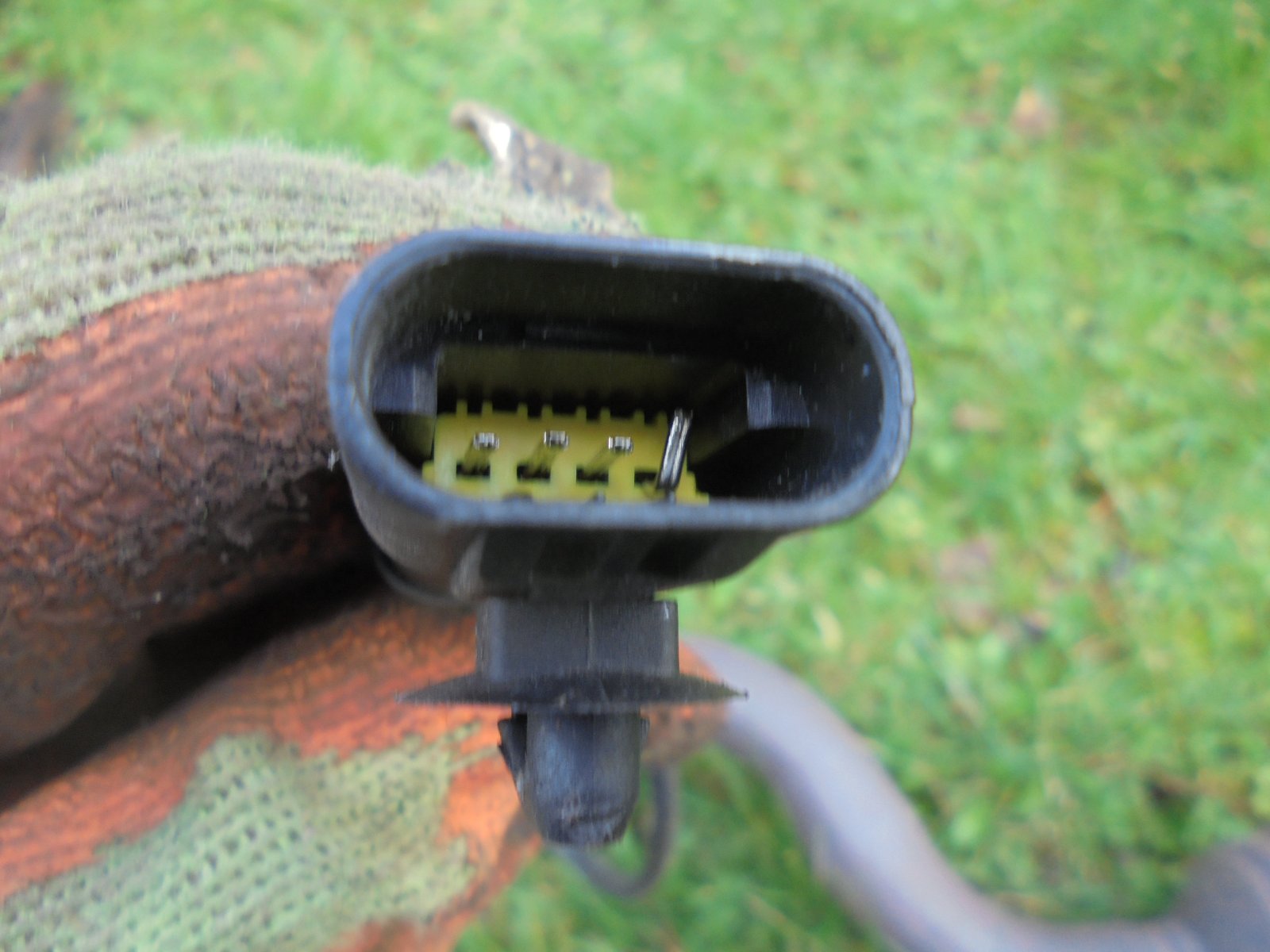

the Upstream plug at the end of the wiring looks to have been mangled somewhat on one of the pins. More likely on assembly than on removal. May well have caused some gremlins.

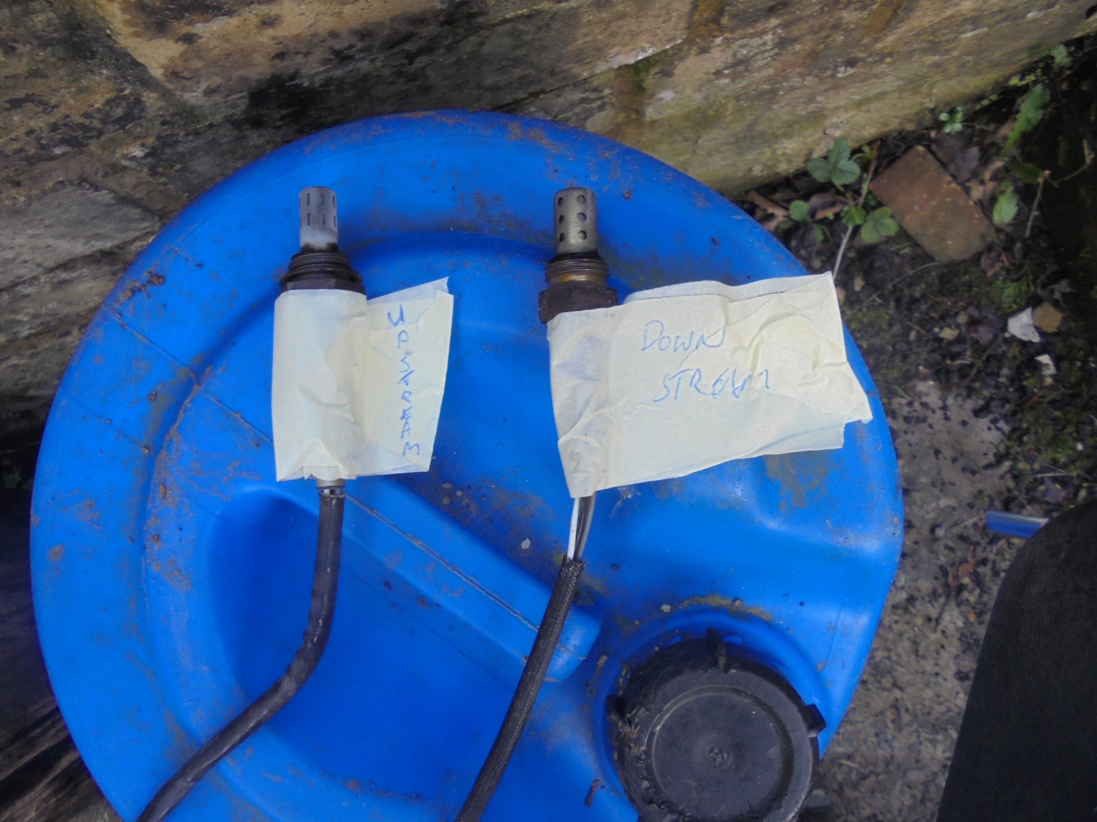

The sensors are out, new ones or reuse that is the question?
- Posts: 21356
- x 8161
Re: Bargain Basement Motoring
Now they are out they won't be too hard to get out again if they don't work properly, so I'd carefully clean them with brake cleaner and then insert with a dab of copper grease and try them. If they work you'll save splashing out!!

Thanks Mick, Yes it was quite a surprise when a reasonably sharp blow with a hammer on the end of a 22mm spanner loosened those sensors so any necessary replacements could be done quite easily.
Not sure if a simple resistance test can prove whether an O2 Sensor is good or bad..
On looking at the evidence of my dismantling I could probably have got away with a more bargain basement result ie one clamp renewed between the cat and centre pipe..
Major goal is to get it through that fast idle emissions test at the next attempt, The last test was done with an obvious leak of exhaust gases at the cat/centre pipe join, simply fixing that , may well get the emissions pass needed on its own.
A couple of new O2 sensors might further assist, and that damaged pin on the old upstream one may even be contributory factor to that emissions test initial fail.

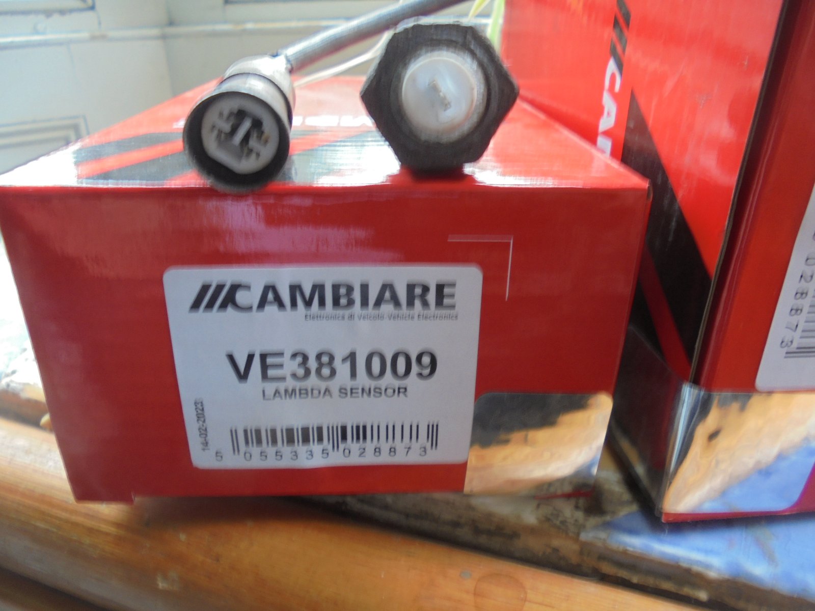

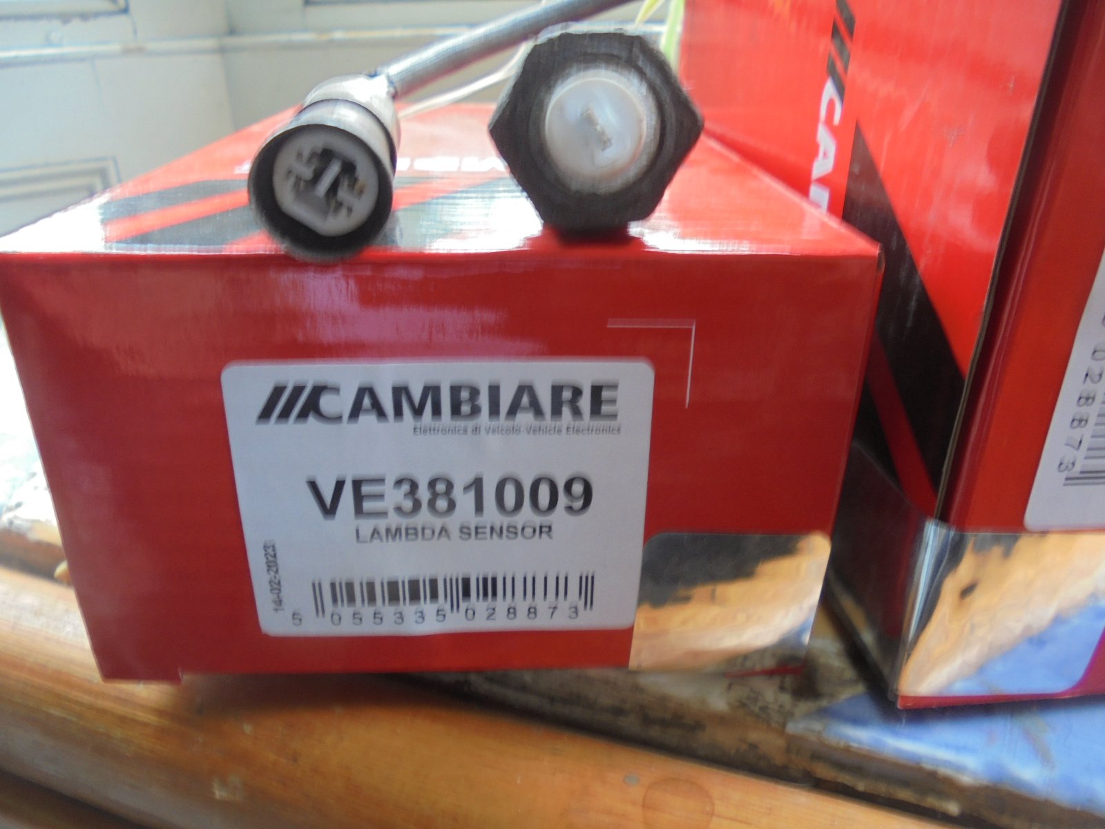

Not me Jim, I've gone for quality with those CAMBIARE sensors, right wiring plug, £43 each from the local car parts shop. (Yes I've never heard of them either but right now they'll more than do particularly if in their newness they get the emissions back in the pass zoneCitroJim wrote: 28 Feb 2024, 10:02 Oh, and don't use cheap eBay ones. They last no time at all in my experience...

The sensor is, in effect, a small weak battery that uses oxygen as an 'electrolyte'. The downside is that it needs to be very hot (>800 degrees I believe) and hence the need for a heater around it.
Pleased you have good quality ones
