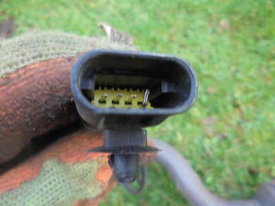

The first part of the job is now off the car and on the grass.
The upstream O2 sensor looks decently removable, the downstream one less so.
the Upstream plug at the end of the wiring looks to have been mangled somewhat on one of the pins. More likely on assembly than on removal. May well have caused some gremlins.
