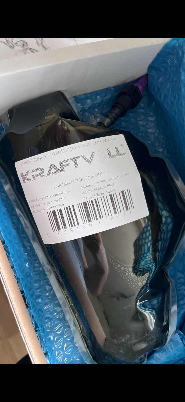

Sent another eBay order not as pictured on the listing. Ffs.GiveMeABreak wrote: 18 Apr 2024, 15:59 No, it's not good enough and is not as described. Make sure they pay the full postage for returns for that reason as it is not what you ordered and they are liable for return postage. If they don't have what is advertised then here's a supplier that is showing the correct part number:
https://www.ebay.co.uk/itm/373419721794 ... BMyvewm95j
I get really peed off with these abysmal sellers on ebay that think they can send any old crap out and get away with it.
Would this work for my C3 Picasso?

Re: Eolys?
Unbelievable!
At the end of the day they are in breach of the selling regulations as they are advertising a genuine PSA product from the photos, with official part numbers and packaging, yet are deceitfully selling an inferior unbranded 'who knows what the hell it is' alternative.
I'd report them as such and get them to pick it up post paid.
I really cannot advise as that's not want it says - none of the info on the label confirms this is Powerflex and therefore I can't advise you on this - really sorry, but this is the problem with ebay sellers thinking they can get away with anything.
I'm reluctant to advise further, but this Amazon link has the stuff with the filling kit for £28
https://www.amazon.co.uk/DPF-Additive-P ... B0BTRTQ3GY
