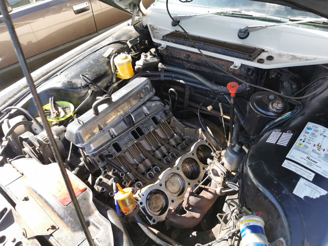

Starting point today:
Ish. That's a photo from a week or two back, but you get the idea.
Couple of hours and a small amount of swearing (mostly at the bracket the throttle linkage/kick down cable attach to) later...
Note that some of the intake manifold bolts are different, so keep them in the order they came out.
The choke cable end is really frayed so definitely wouldn't be going back into the linkage on the carb if I took it out, which is why the one carb is just tucked in the corner. There's plenty of length of cable available to keep it out the way so I figured I'd just leave it alone rather than adding to my immediate to do list - though the cable does want changing longer term.
Can't really see anything useful looking down towards our offending valve.
At least not that I'm able to interpret.
It's not something obvious like a bit of rag having got sucked into the intake anyway, so the head will have to come off to investigate and resolve whatever is going on.
That will be the next step. I'm not touching the exhaust manifold bolts, the join to the downpipe has clearly been apart relatively recently (the bolt is still shiny) so it will be getting split there.
I was really quite surprised with how clean things were under the intake gasket/valley cover given that these engines don't exactly have a reputation for internal cleanliness.
Again kind of wishing I knew better what the story of this car was. I almost wonder looking at this whether this engine has had at least some rebuild work done (the water pump and timing cover gaskets externally look bright enough to be essentially new), and it then just sat around for a long time before developing this problem when fired up eventually. I did note when it was running that there was very little apparent blow by.
Nothing really found yet, aside from a surprisingly clean looking engine anyway. We'll know more when the head comes off.

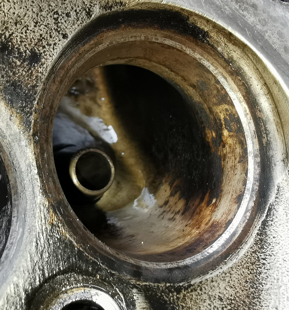

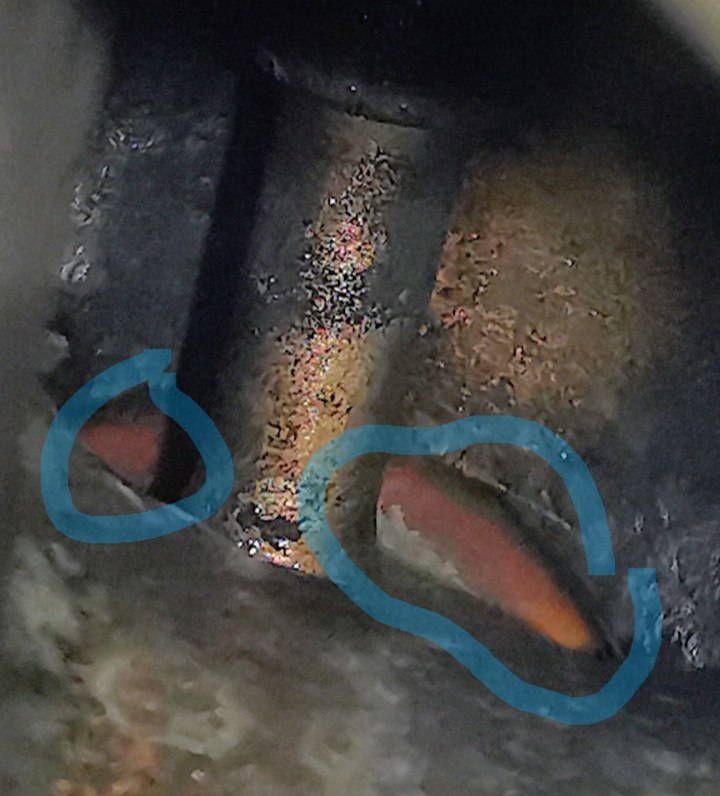

Those manifold bolts look to have tales to tell: one with a slot cut on its head and the other with a bonus extra penny washer!
I too like the "stabbed cardboard" technique, though I'd have a very obvious "FRONT" label as pretty confident I could have it 180° wrong on reassembly. Unless you have a "top of Halfords box = front of car" rule in place :-D
Does look very clean in that valley.
Only thing I can't be sure about is the sort of "orange coloured ring" seen down that valve port. Otherwise looks pretty normal to me.
Follow with interest as to what you come across, it's a puzzle

This bit:
Orange ring
Orange ring

MattBLancs wrote: 16 Sep 2023, 22:24 Those manifold bolts look to have tales to tell: one with a slot cut on its head and the other with a bonus extra penny washer!
The ring of rust is indeed what has me curious. It may be as simple as rust on the valve seat if that cylinder has got wet (I'm assuming the valve seat inserts are steel). Guess we'll see.
The orientation of the box is that the tab sticking out the top of the box is the bonnet of the car. It made sense to my brain.
The bolt with the slot in is odd as the heads of all the bolts, including that one are in fine shape. So I really don't know why someone did that. The additional washer on the one is on the only one which sits in a slot rather than through hole. Uncertain if that one would originally have had a larger washer on than the others.

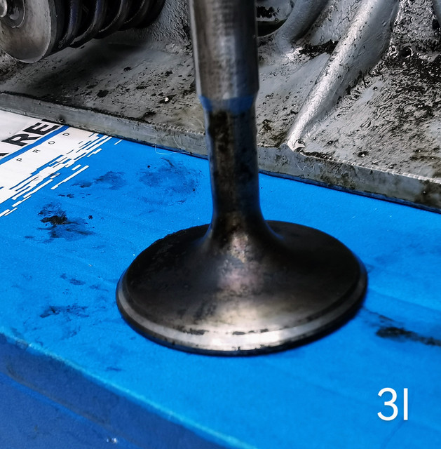

Rest of the valves are now out.
1. Intake.
1 Exhaust.
3 Intake.
Couldn't help but notice the cup in the valve head is rather odd centre...3 and 7 are both like this, 1 and 5 aren't.
3 Exhaust.
Possible historical evidence of a dropped valve in the head by this valve seat? Nothing on the piston, but I'm tending to think this is the old heads dropped on a far newer/rebuilt block based on my findings so far.
Including 5 for clarity even though you've already seen these.
7 Intake.
7 Exhaust.
The exhaust valves all have quite a bit of wear on them. So I'm inclined to at least replace tbose. Also notable that the wear line on them all is really close to the lip, whereas I'd tend to expect it to be nearer the centre of the sealing face as on the intake valves.
I do note that exhaust valves are available in 33 or 34mm diameters... could someone have put 33mm valves in here when the head was set up for 34s?
I'll dig out the calipers tomorrow and measure what's in here. Most likely I'll be getting a full set, just seems sensible for long term peace of mind.
