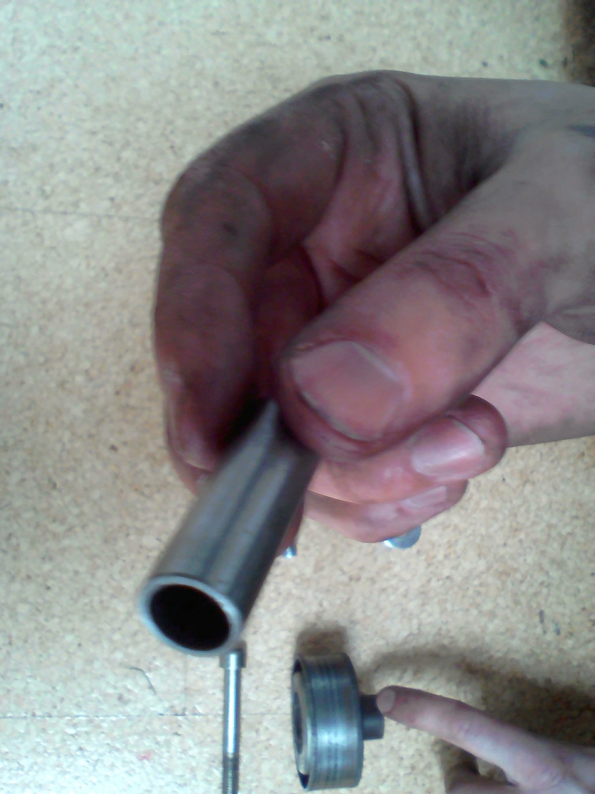

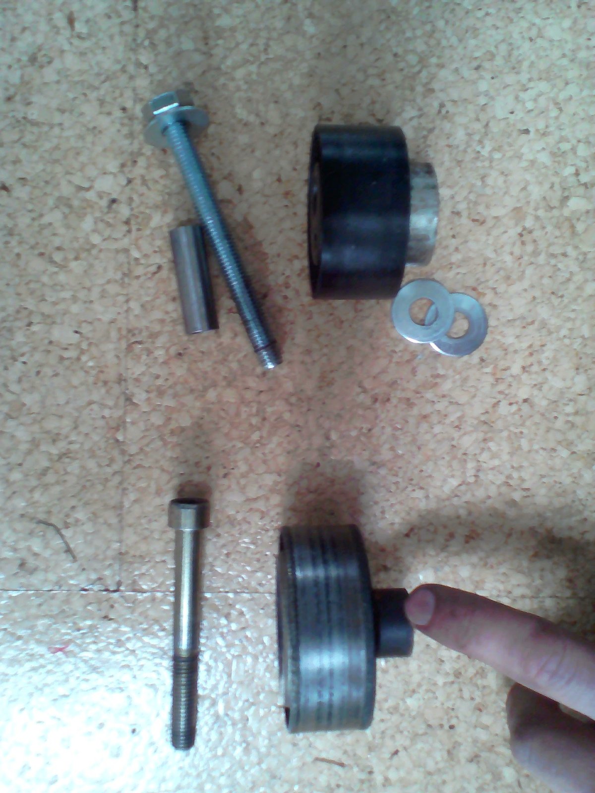

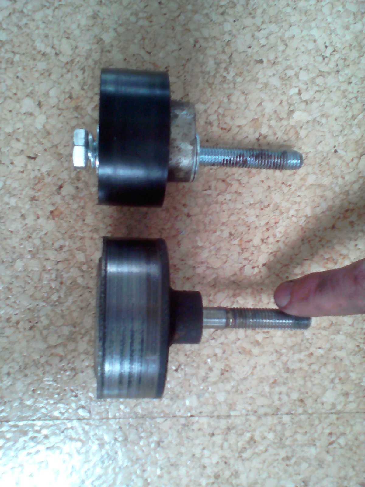

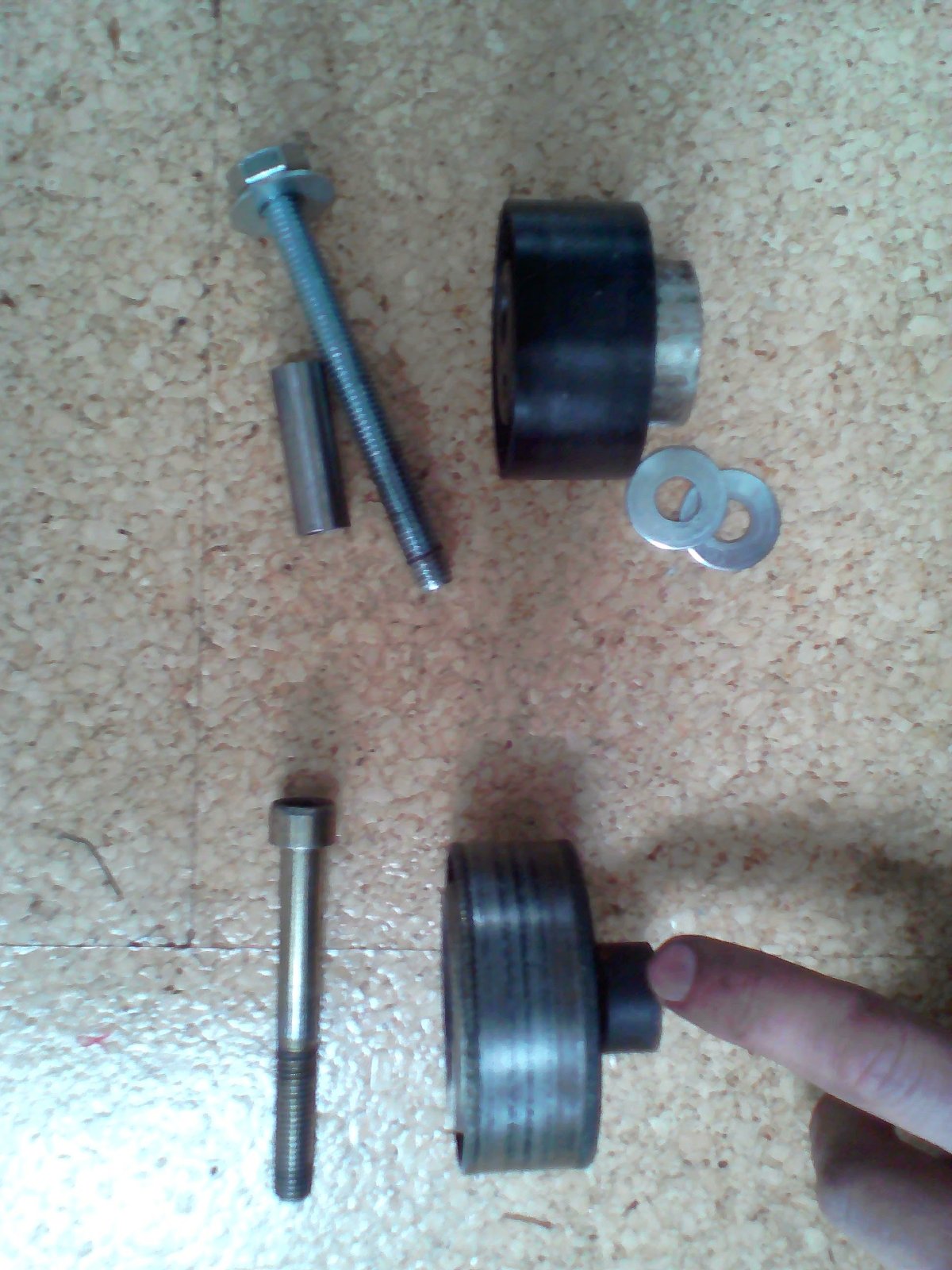

Auxiliary belt= check it's not a "stretch belt" = these have a fixed idler where a tensioner should be, need a special tool to drag it onto the crank pulley, and in my experience, then go on to squeal again shortly afterwards. Pain in backside and I still do not understand what problem they are trying to solve.
I converted my 1.6 HDi C4 to manual tensioner by use of a second hand Audi timing belt tensioner and a spacer tube (hole in tensioner 12 mm, secured by M10 bolt from memory) will see if can find a picture

Unread post by MattBLancs »
Two things:
1) wow, time flies!
2) Google photos is pretty amazing how quickly I can find 3 images from April 2018 at drop of a hat!
Modified tensioner:
Old fixed at bottom, and new (recycled timing belt pulley) at top 1
Spacer tube
Spacer tube
Assembly of each
Assembly of each
