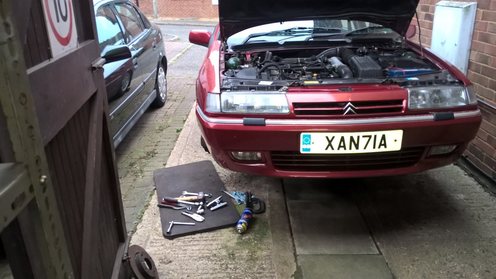

The Activa spannering has very much commenced
Really enjoyed it and realised just how much I've missed the spanners recently; it's still excellent therapy for me

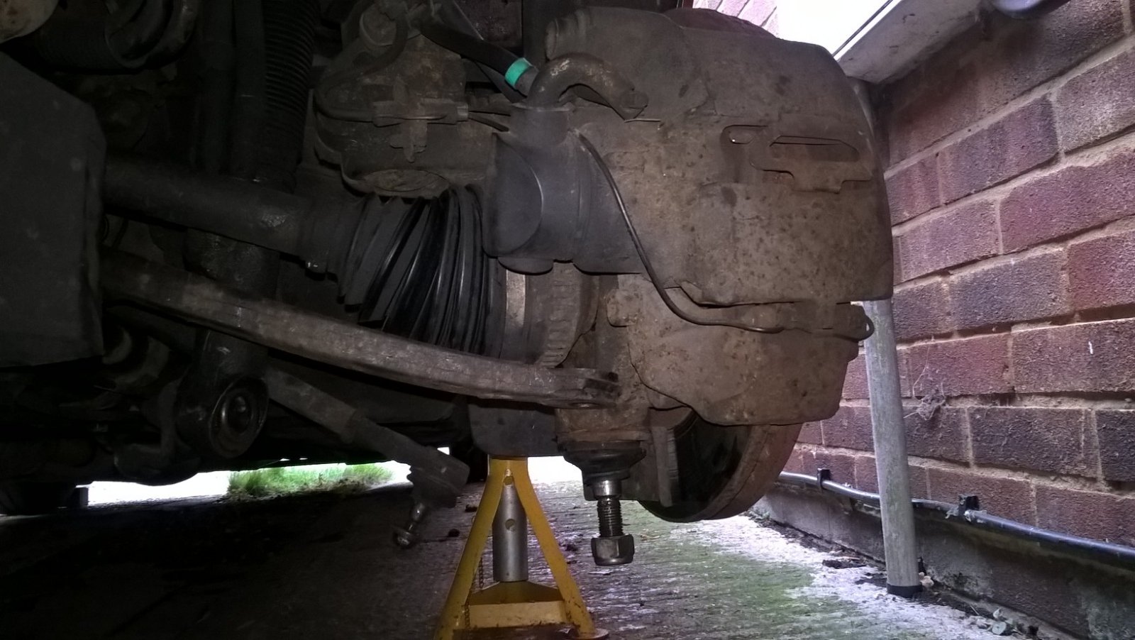

Hub nuts undone and balljoints split amongst other prep jobs.
I think the OS has the noisy wheel bearing... I recall swapping the other one a while back and I have one in stock. It will be fitted...
Some prep work done to swap to big discs too

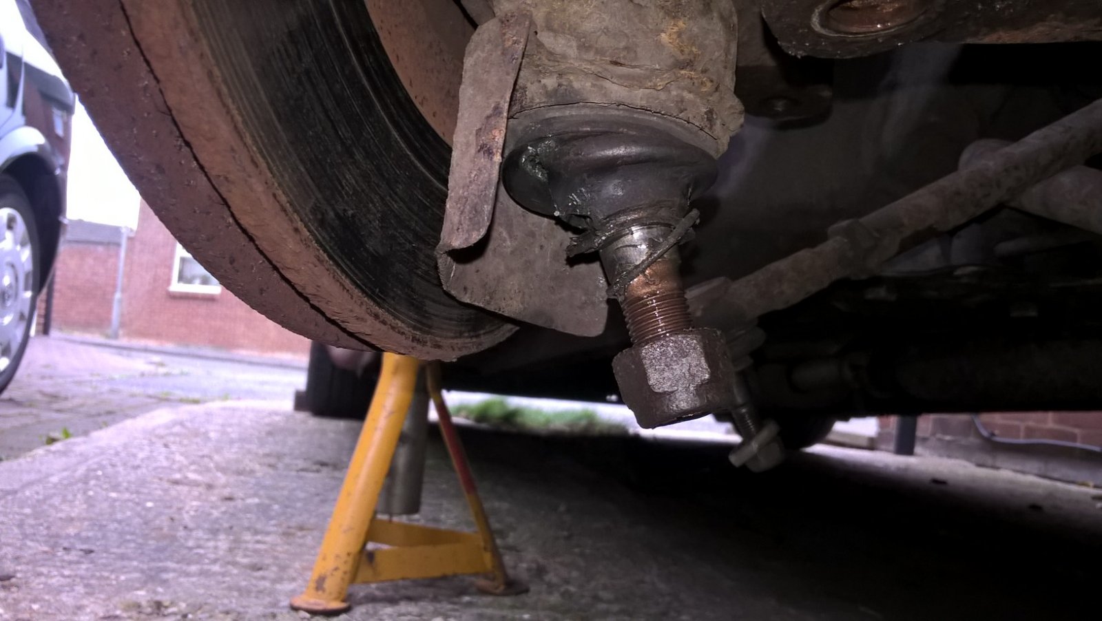

The position is assumed

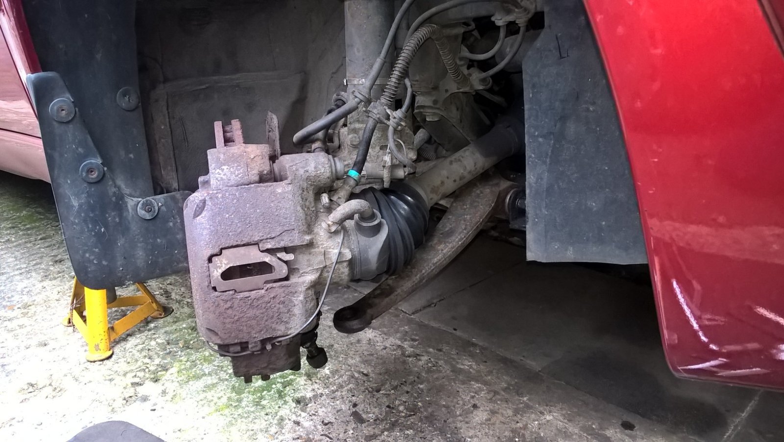

Front suspension split and ready for work...
The split boot...

Been a great day today
The split boot...

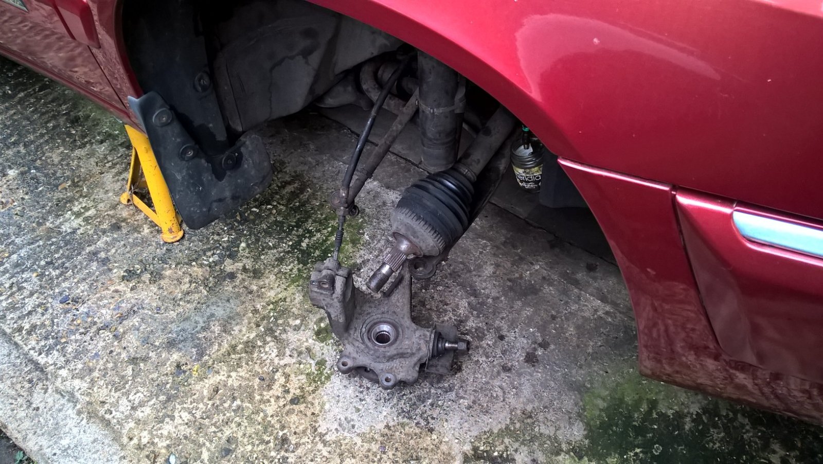

Offside dismantled completely and the hub is off and ready for a wheel bearing change.
I couldn't hear it at the slow speeds I drive but it's certainly a bit noisy and graunchy... I have one in stock...
Also started dismantling the nearside and now ready to extract the driveshaft with the split boot
