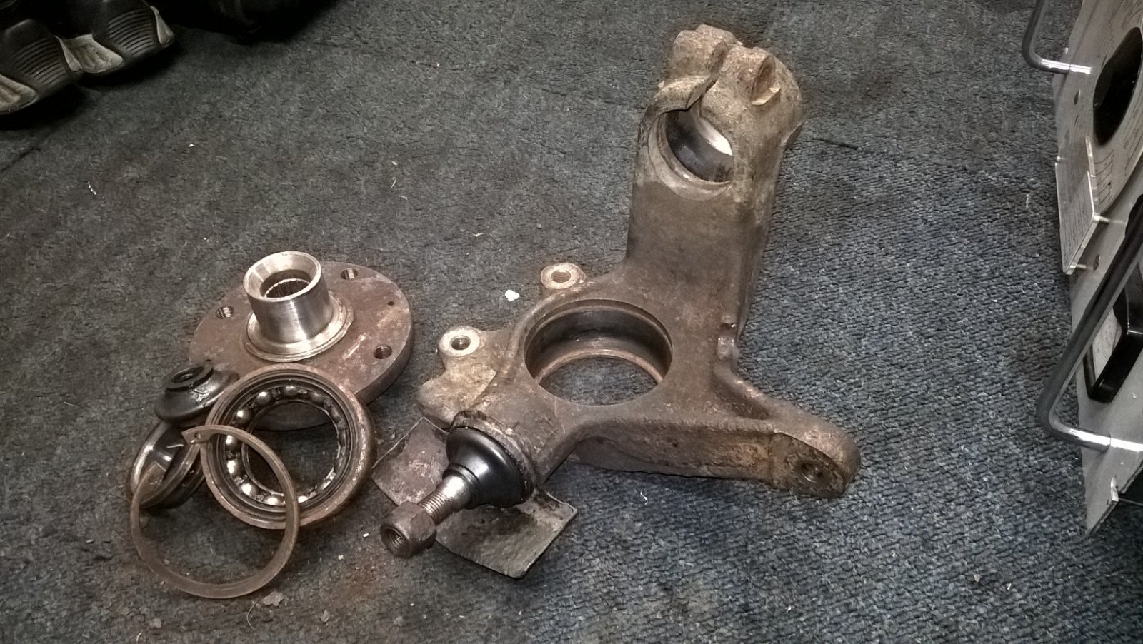

A bit more work done today on the Activa...
I pressed out the old wheel bearing - a job I love oddly enough - and prepared the hub for pressing in the new one. I think I just love using my hydraulic press and the most satisfying bang that occurs when the old bearing finally lets go and decides that yes, it will come out to play
Also fitted a new rubber boot onto the lower ball-joint... They seem to do the job and for just under £4 for a pair they're a good solution to a split one on an otherwise good joint...
I got a bit carried away and lost track of time. Now I have run out of time to get ready for a Redway Runners social run this evening
No worries as I'm really enjoying all this spannering work. Loving it in fact
I really do know where my true love lies...
Here's the hub all ready to receive the new bearing along with all the bits considered beyond reasonable further duty!

Coming along, Jim. That hub is in remarkable condition given its age - the ones off my 10 year old 307 were (a lot) rustier than that!!
Thinking about the boot - it's probably easier to knock the outer joint off and fit the boot from the other end, that way, you only need to cut the boot off the inner joint, and not even remove the can, so all the rollers can remain in place!

I think you'll love the Activa Zel. It is a totally different drive to Gabriel though... They may be both Xantias but there the similarity ends
Progress might be a bit slower today...I pulled a muscle in my arm whilst wielding a big club hammer and cold chisel at the bearing retaining circlip that was fairly well rusted in the groove
but today I do hope to press in the new bearing and get the new big brake calipers cleaned up and ready for fitting...
I'll be swimming first - with this arm it might be interesting - I might end up swimming around in circles
Richard, yes, I think the knock-off the outer joint will be the simplest and easiest way in the end... I'll be doing that job quite soon now but I need my arm to be OK as there will be hammers involved!!!
Generally the car is really quite rust-free. In my ownership it's never seen much winter use at all... Makes a difference I think... It certainly comes apart easily enough
