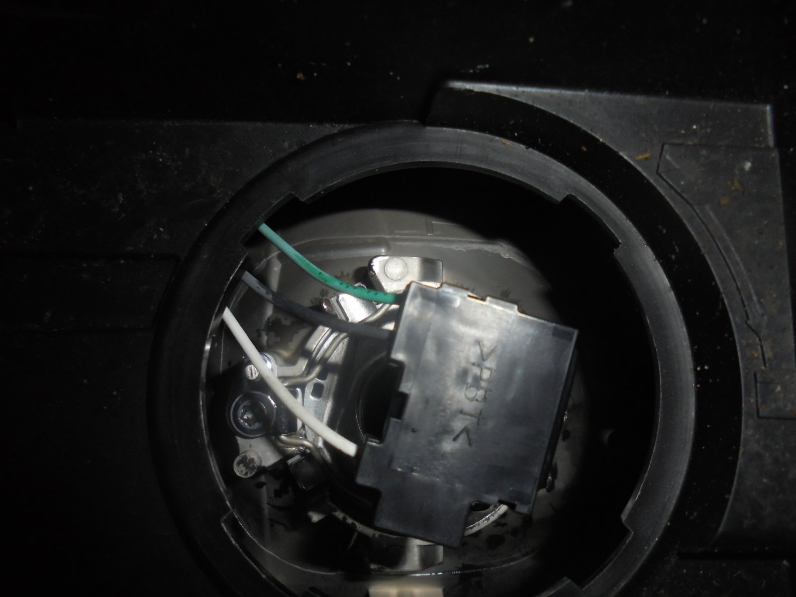

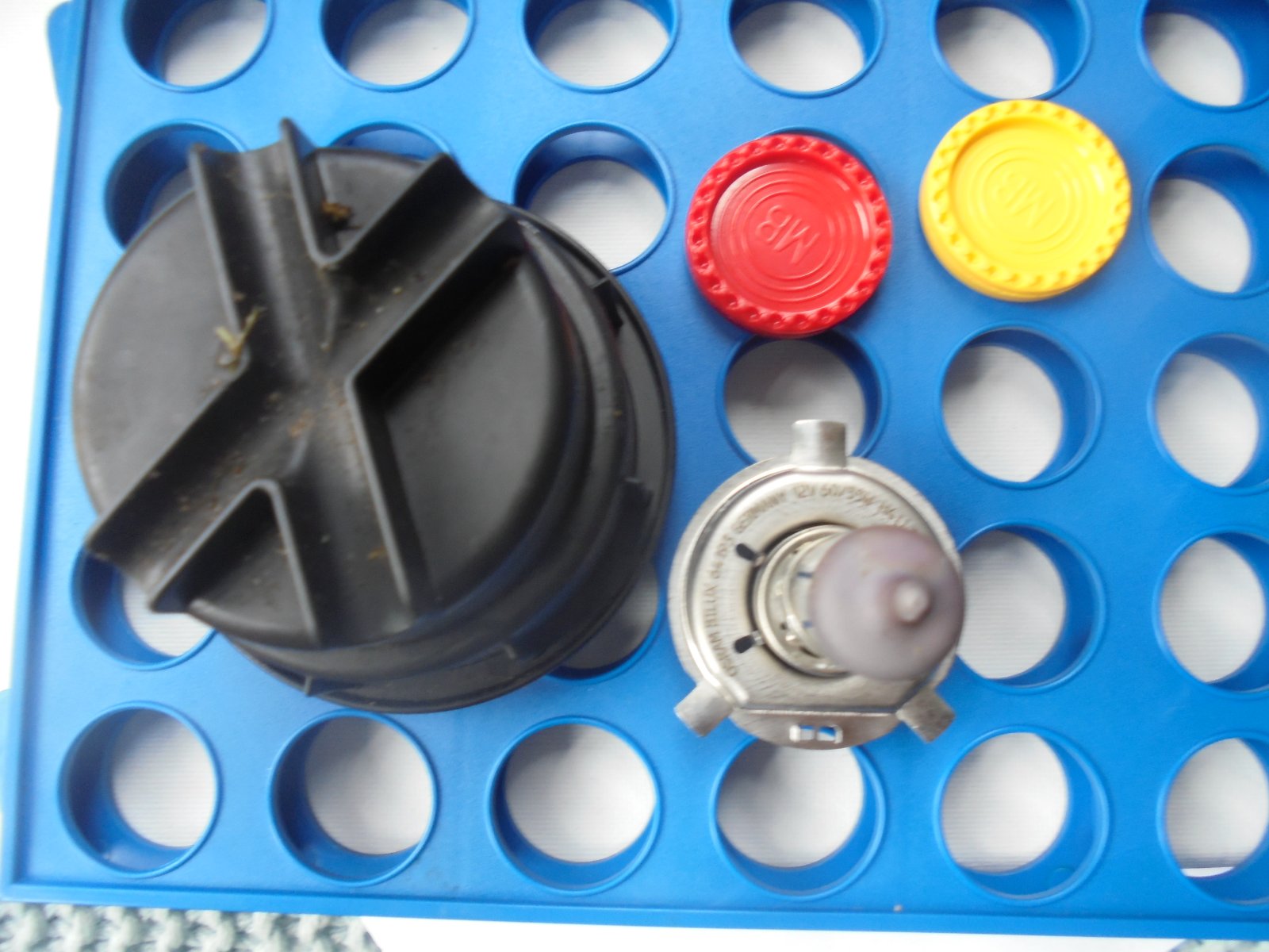

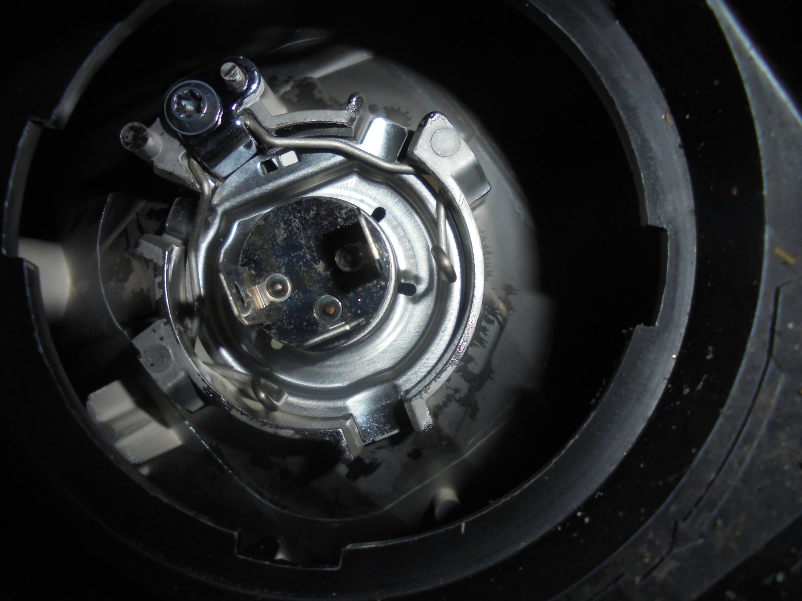

Yes definitely H13 in the specs but I remove it and find its an H4 :-D , removal in pictures.
Is an H4 equivalent to an H13 :?:
...and the bulb says OSRAM BILUX 64193 GERMANY 60/55W H4 U 37R E1 00801 w4v5

Looks like its going to be an internet thing for the H13, over the counter at TMS Motor Factors over £42 for one, and none of their outlets within 70 miles have any in stock, but can get them next day. ECP and GSF have no H13 bulbs listed at all.
Having just discovered the removed bulb was an H4, and the car passed its last MOT. This is the exact bulb as removed price under £5...

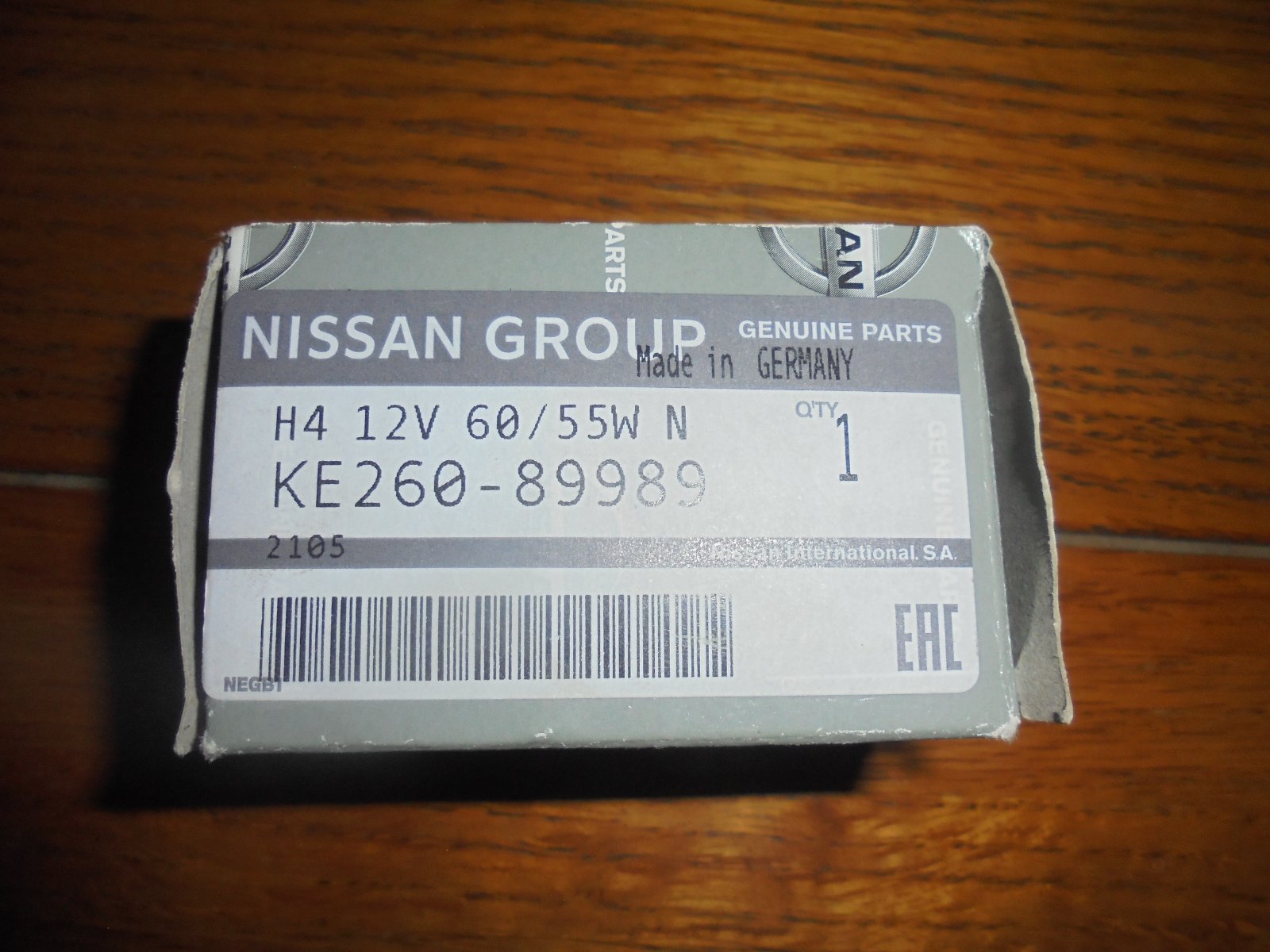

The plot thickens tried the local former Nissan dealer and the chap from the parts dept was very helpful. The spec for the H13 bulbs has been superseded and it's now the bog standard H4. Seeing as he was helpful the Falcon is going to pay over the top for one of his genuine Nissan H4's but under a tenner still. I like politeness and helpfulness to a degree where just occasionally I park my natural skinflint-ey-ness. :-D

H13 is a US spec, Powerbulbs thinks it should be H4, so I suspect if you look in a UK manual it will be H4.
Posts: 26425
Re: Bargain Basement Electric
The H4 has arrived from planet Nissan

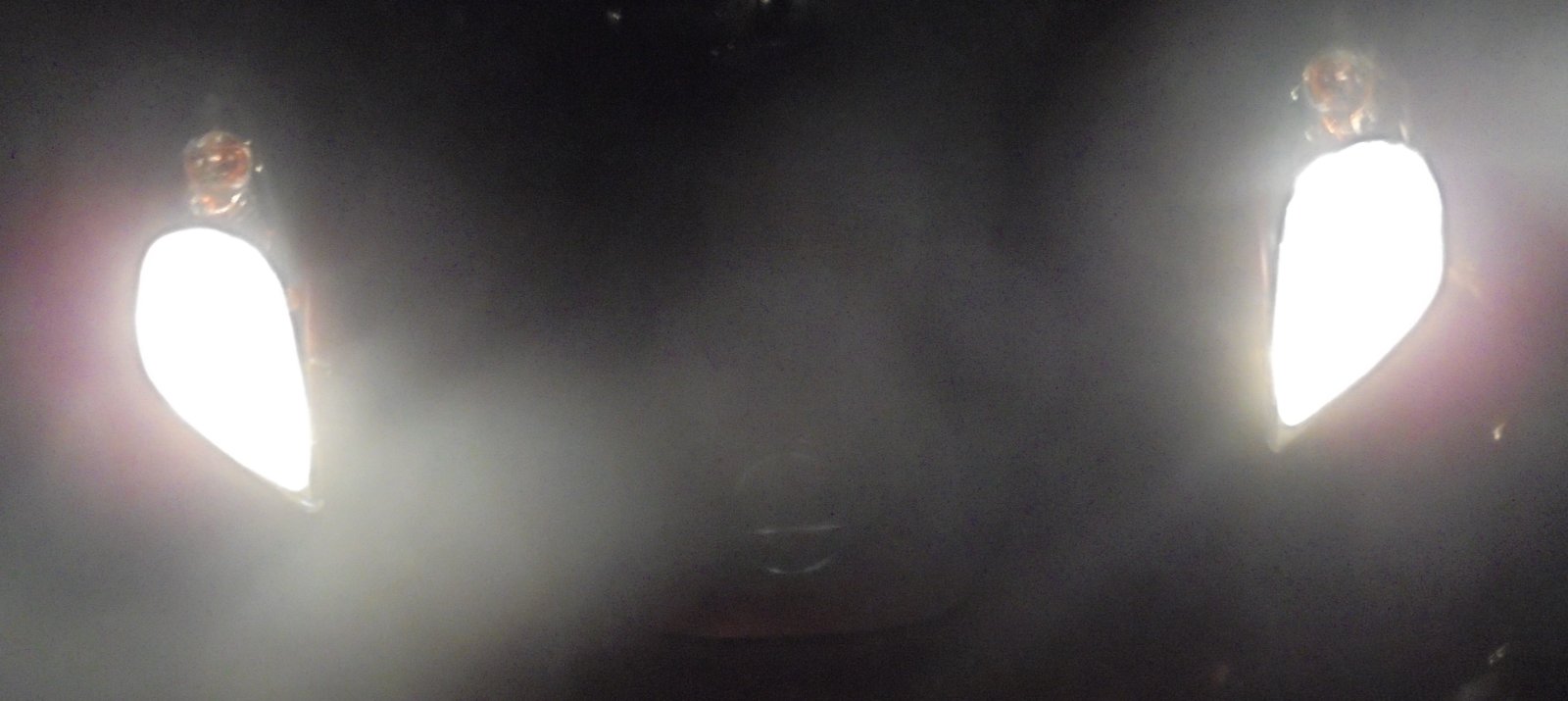

Job done, lights back to their brilliant best! :-D
