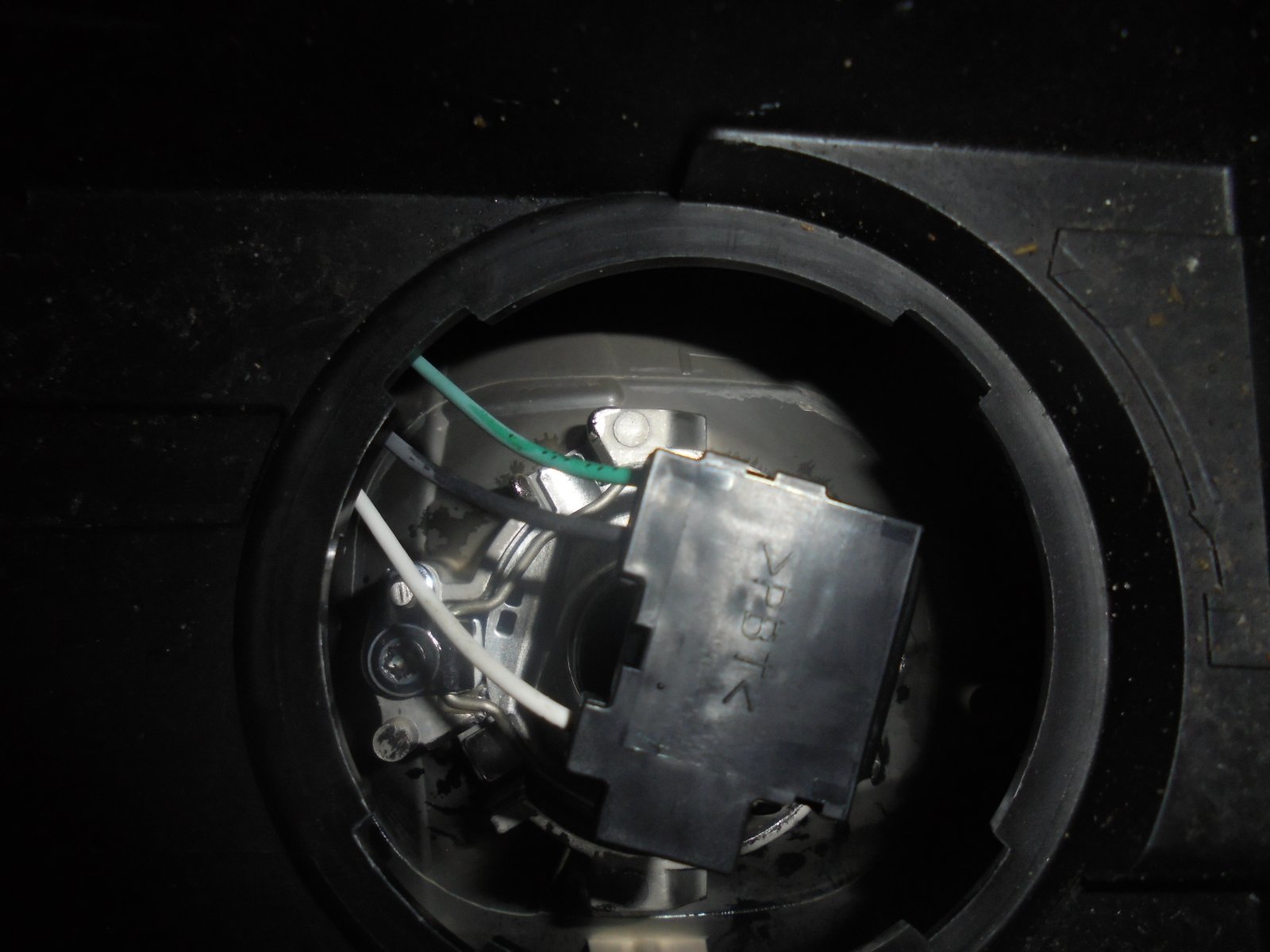

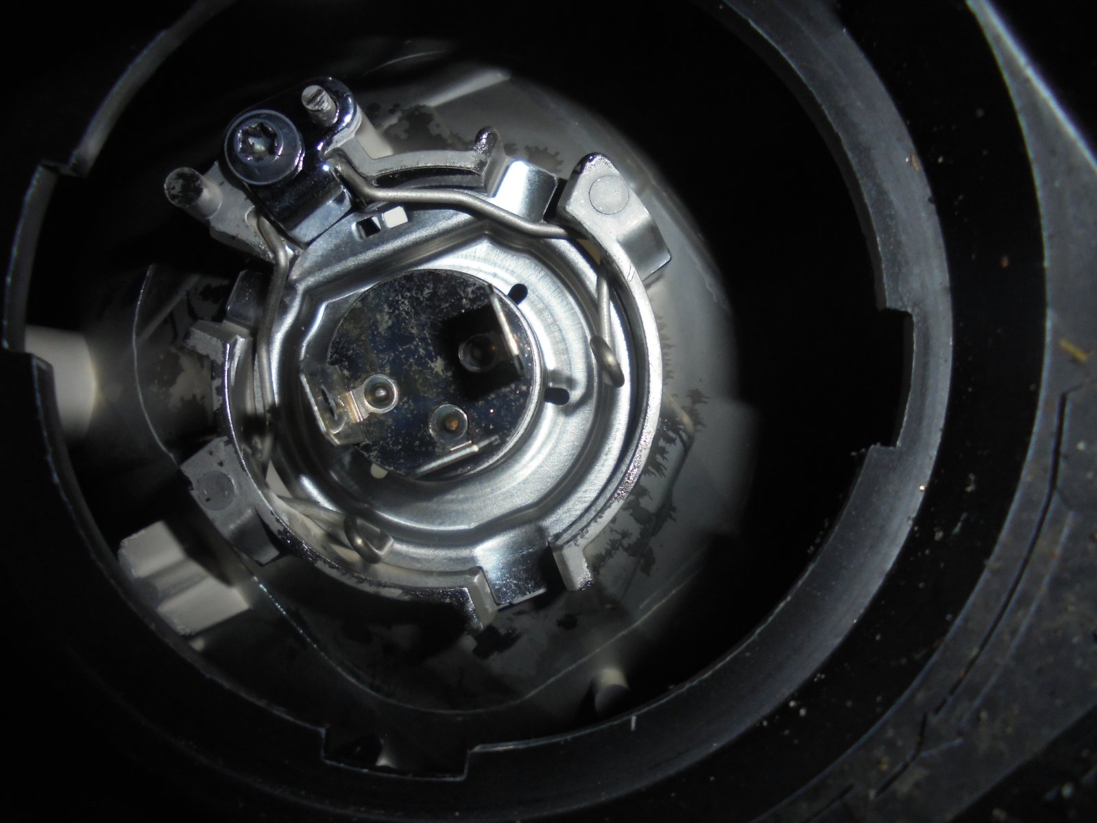

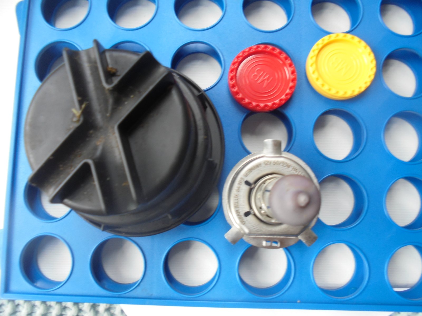

Yes definitely H13 in the specs but I remove it and find its an H4 :-D , removal in pictures.
Is an H4 equivalent to an H13 :?:
...and the bulb says OSRAM BILUX 64193 GERMANY 60/55W H4 U 37R E1 00801 w4v5

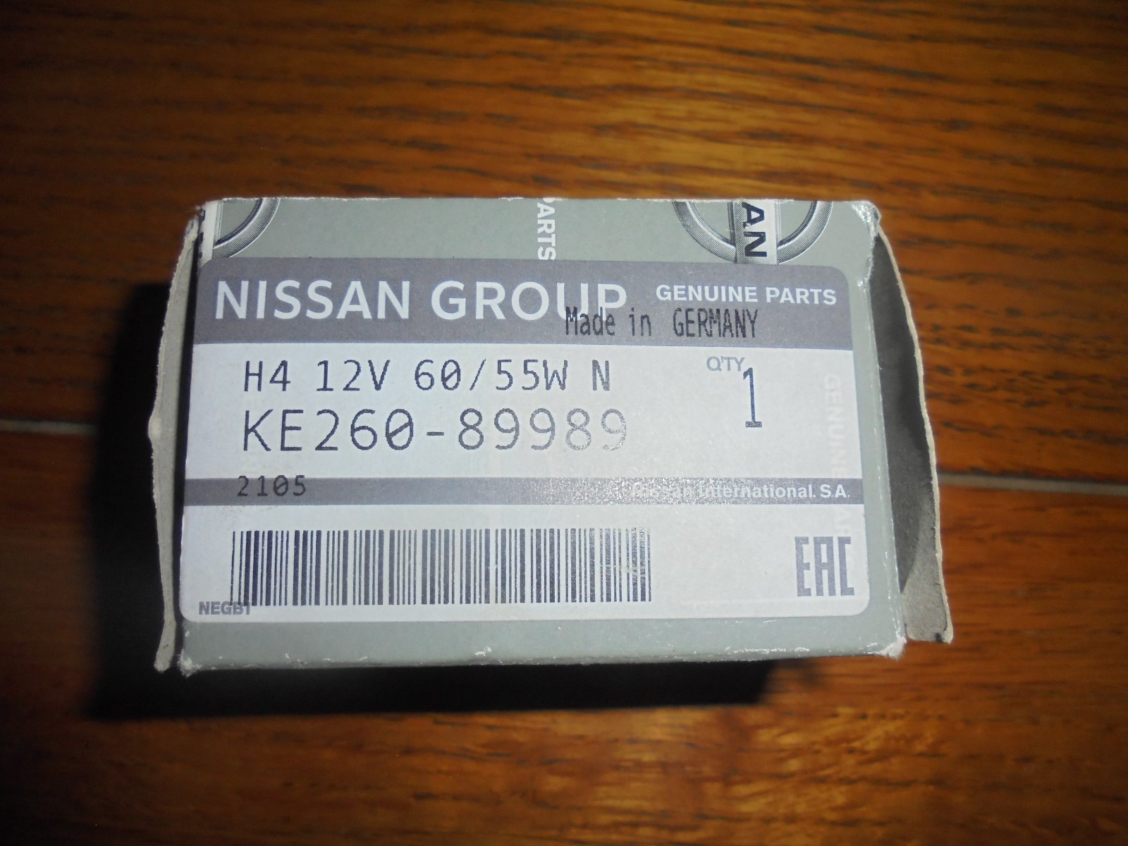

The plot thickens tried the local former Nissan dealer and the chap from the parts dept was very helpful. The spec for the H13 bulbs has been superseded and it's now the bog standard H4. Seeing as he was helpful the Falcon is going to pay over the top for one of his genuine Nissan H4's but under a tenner still. I like politeness and helpfulness to a degree where just occasionally I park my natural skinflint-ey-ness. :-D

The H4 has arrived from planet Nissan
