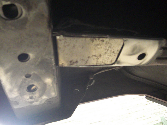

Got the week off this week anyway so now the citrohutch is pretty much done i thought id have an afternoon on the xm, got the welding 90% done on the back end, ran out of welding rods though which is a little annoying but very happy to be making some proggress, a picture something something something.............
Patch cut and in place
CIMG3665 by Deanxm, on Flickr

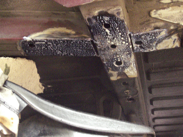

Alll welded up, ground back smooth with 2nd coat of rust cure
CIMG3671 by Deanxm, on Flickr

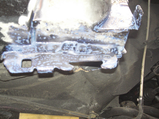

Strengthener cleaned, treated and tacked in place wih another coat of Brown cure
CIMG3672 by Deanxm, on Flickr

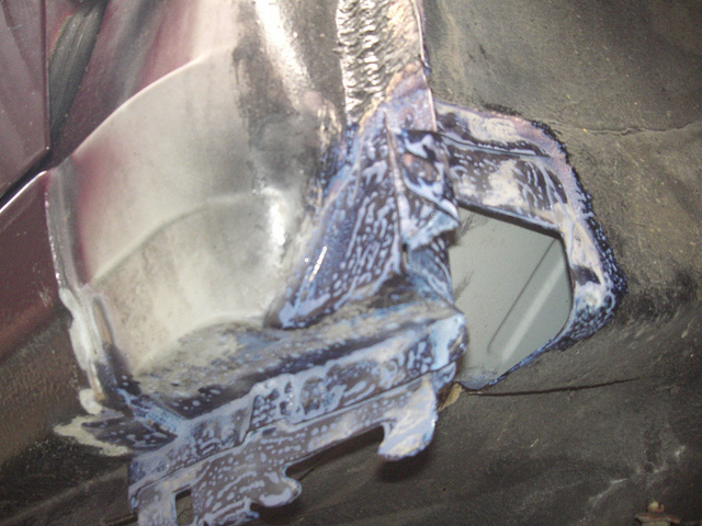

Front wheel arch with all the original stone chip/seam sealer taken off around the weld and a quick go over with rust cure to keep it clean till i can continue on friday.
CIMG3673 by Deanxm, on Flickr

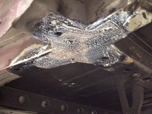

CIMG3674 by Deanxm, on Flickr

Gosh Dean, that's looking a top quality welding job
Excellent stuff!

Thanks Jim, im happy with the way it went, its been ages since ive welded 1mm and got a pack of 1.5mm rods for the job but they ran too hot so settled with 2.5mm which was fine but i only had 3 left, which is typical, the front will be good fun, the patch will have to be welded as it will have some interesting corners and shapes in it!!
