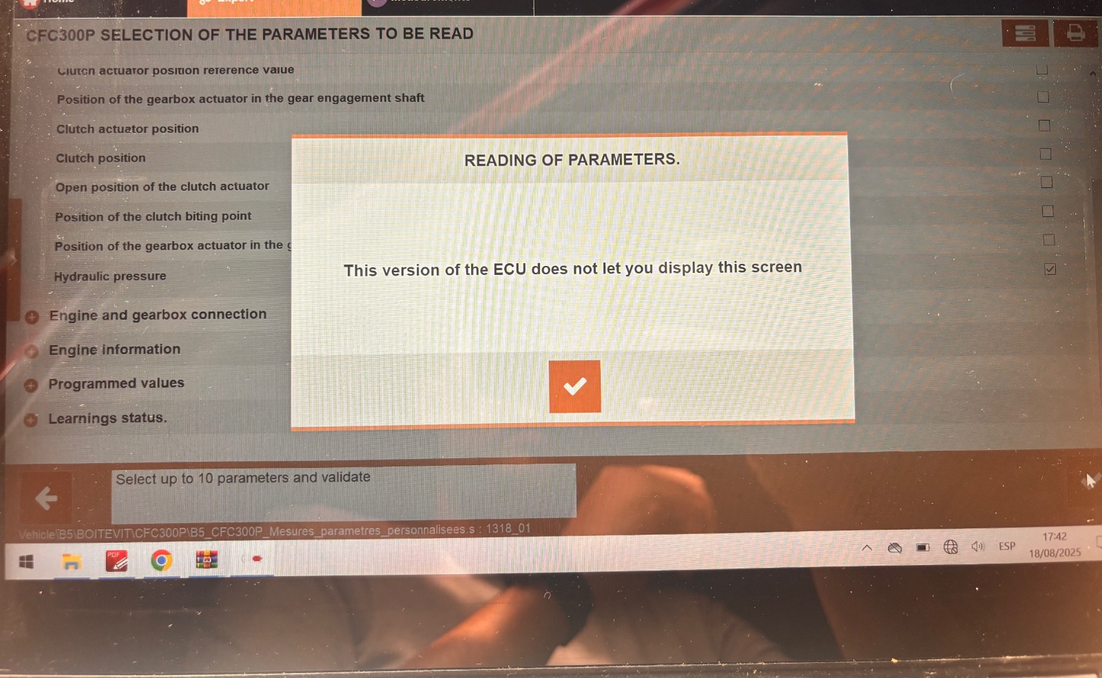

kalm007 wrote: 17 Aug 2025, 00:03 I think you have to use fewer torque. Because full torque is not so good for the transmission. And if you use fewer torque. Is there causes slipping in this case or only with full torque.
And can you take a picture what is the problem when you would like to mease the pressureof system. There is very imortant that the car can keep the 50 bar pressure.
This is the message I get when I try to measure the pressure live..

Posts: 21049
x 8084
Re: Citroen Grand C4 Picasso 2012 MCP6 error
You may like to edit your post and mask the VIN which is displayed on the screen. :)

mickthemaverick wrote: 18 Aug 2025, 17:43 You may like to edit your post and mask the VIN which is displayed on the screen. :)
Done, Thanks!
