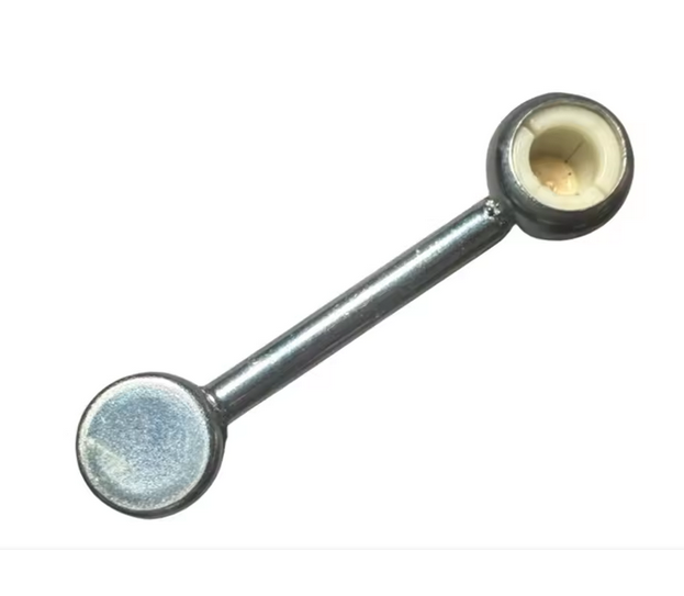

No need for all kinds of bodgery anymore. 5273.81 is now available from your favorite chinese slave labor peddler:Jay-Bruce wrote: 25 Oct 2023, 16:10 Thanks Marc - I've flashed a debit card at my dealer, but the parts guy said these are on back order with no ETA, so he'll chase it up in a couple of days, but he also advised that items marked up like that often don't come back into stock.

https://www.aliexpress.com/item/1005010198232227.html

Good to see they have replicated Citroen's crap weld at one end so it falls of after rusting away

Wouldn’t be surprised it they stole the photos. Will reply with what actually arrives.

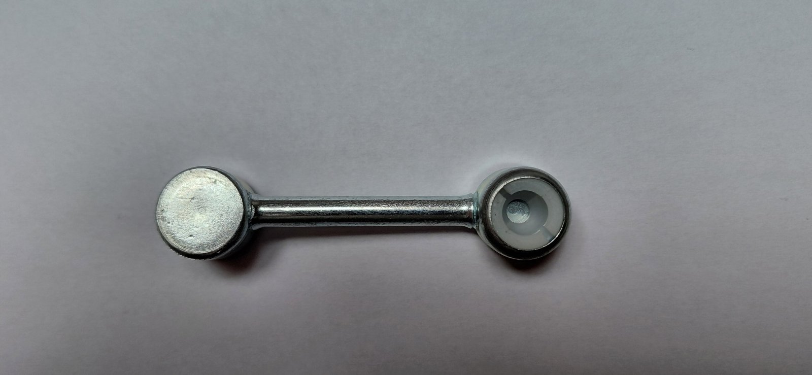

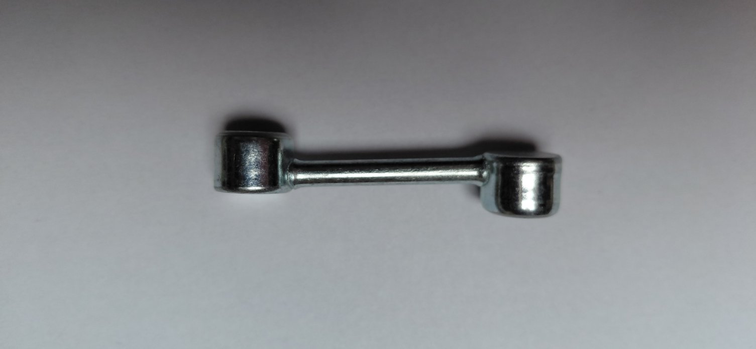

This arrived, photo was apparently stolen
Plastic insert is made from two halves and rattling, probably because there is no grease anywhere. Otherwise it looks solid especially for the price.
