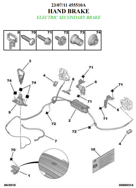

I think I have mentioned in the past, that the Peugeot 508 has a very similar looking parking brake (almost identical), but they are NOT the same and have different part numbers, so plausible why they are not communicating properly.

So there is still doubt then in this case - as you cannot be 100% sure the second hand one from another C5 is itself genuine! Citroen mechanics CANNOT determine the internal software / programming of the EPBs, so looks and part numbers on units as we know can be fake.
If you were to fork out the £1300 + on a new genuine Citroen EPB, I suspect you would NOT have any of the issues.
There's another post on this from another member being sold a puppy by a seller of a handbrake for either C5 and 508 saying they are the same but they are NOT the same and have different parts as said. If they were exactly the same, PSA would use an identical part number as they do on all other parts regardless of the marque.
All these issues appear to stem from aftermarket handbrake sellers or non Citroen genuine parts orders or second hand used parts from vehicles where the history of the part cannot be guaranteed as new or genuine themselves.

This will probably remove the parking brake fault/ anti rollback fault, and maintain manual operation of the EPB.
Yes, perhaps the current EPB is not the 'original' too.
Waiting to get lucky on the original EPB, as at 1300 pounds, that's 1/3 the cost of a C5 X7 in my country
asaf400
- Posts: 22
- Joined: 28 Jul 2022, 22:43
- x 9
Re: Citroen C5 2.0i 16v auto al4 handbrake problem
Yeah same here,AinurC5X7 wrote: 02 Oct 2023, 07:54 Should try to also remove the EPB ECU in the list of ECUs in the BSI configuration.
Waiting to get lucky on the original EPB, as at 1300 pounds, that's 1/3 the cost of a C5 X7 in my country![]()
Original PSA parts are between 2x and 6x the cost of aftermarket parts from any other manufacturer, Mapco, INA, Febi Bilstein, SKF, Valeo, BOSCH, Gates, Dayco, TOPRAN, etc..
Yeah, My dad doesn't like using PB, so if the problem comes back now, we will disable it all together,
I reckon that's done by changing the parameter "Secondary parking brake: Present + Rear" to Absent..
