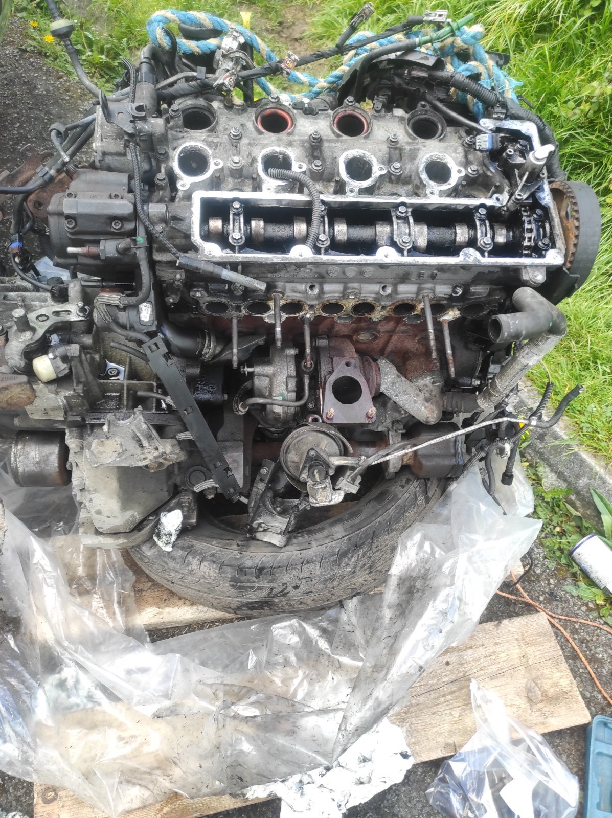

Ok started stripping the head there is an awful amount of ancillary equipment. Have exhaust manifold, egr& cooler, vacuum pump thermostat housing, removed. I also got the glow plugs out without too much drama.still to remove timing belt,fuel filter and housing, fuel pump, alternator. Then start pulling cams and lower intake manifold. It's a lot more work than on the mark 1.

Yeah big time Matt, I now know I just have the injector to deal with. I am going to do all the gaskets and seals and change out the coolant sensors while I am at it. They're awkward to get to with the engine in. The exhaust came off surprisingly easy, yet another bonus😁. Which worries me it's coming along too nicely. I am wondering if difficulty is waiting further in.🤔 either way I will keep posting. you can see where I am so far in the picture.

Darren, for some reason the photo is displaying correctly in the post but when I click on it the photo turns sideways. I notice that the photo is taken in portrait mode. Could you try taking the next photo in landscape to see if that cures the problem? I prefer landscape photos anyway.

Paul-R wrote: 02 May 2023, 09:03 Darren, for some reason the photo is displaying correctly in the post but when I click on it the photo turns sideways. I notice that the photo is taken in portrait mode. Could you try taking the next photo in landscape to see if that cures the problem? I prefer landscape photos anyway.
Fixed
Posts: 28631
x 5645
Re: Injectors misbehaving but trying to understand the numbers
darbuck wrote: 02 May 2023, 09:05Ok will do
Image fixed. It is mobile phones, but not all mobile phones.
Before uploading, use an image viewer, tilt the image 90° one way, then return it and re-save it, then upload.
Makes no difference if it is landscape or portrait, when zoomed it will rotate 90° anyway.

Well done but your suspicions re easy removal, does suggest somebody has been here before. The timing belt will be easy with the engine out.
Keep it up you're getting there.
