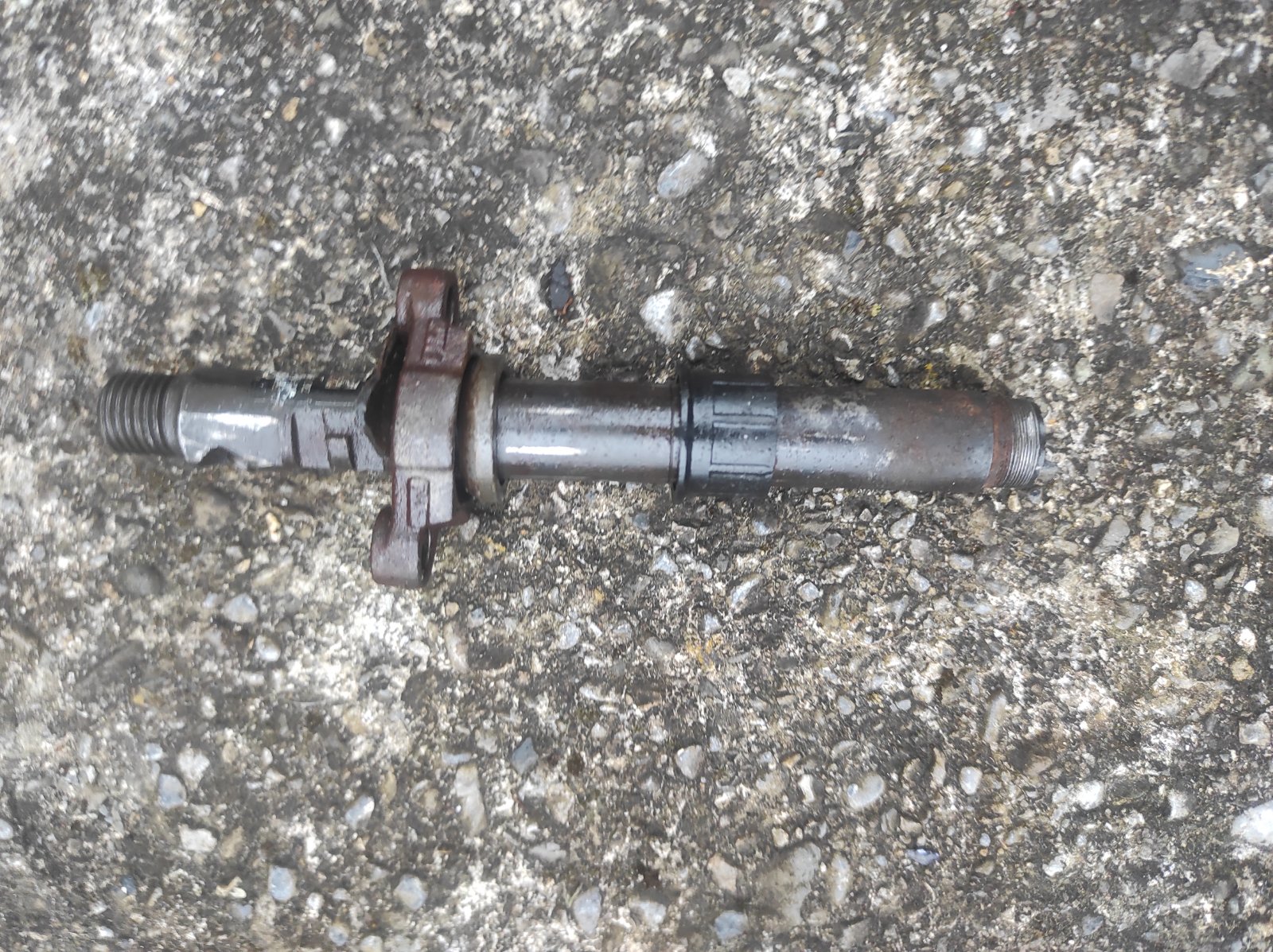

This is the injector I pulled last night it seems to have unscrewed the tip in the head. I bought a used set off eBay. Need to buy a head gasket for when I pull the head. This has just spiralled but I am starting to see light at the end of the tunnel.

KennyW
- Posts: 2615
- Joined: 17 Jan 2006, 21:22
- x 165
Re: Injectors misbehaving but trying to understand the numbers
Darren,
It looks like a previous owner has been there before and done some work but didn't resolve the problem they were looking for.
Do you know any of the previous work carried out on the engine ? This may be a good starting point to help you finish the job correctly.

darbuck
- Posts: 1612
- Joined: 25 May 2014, 16:45
- x 289

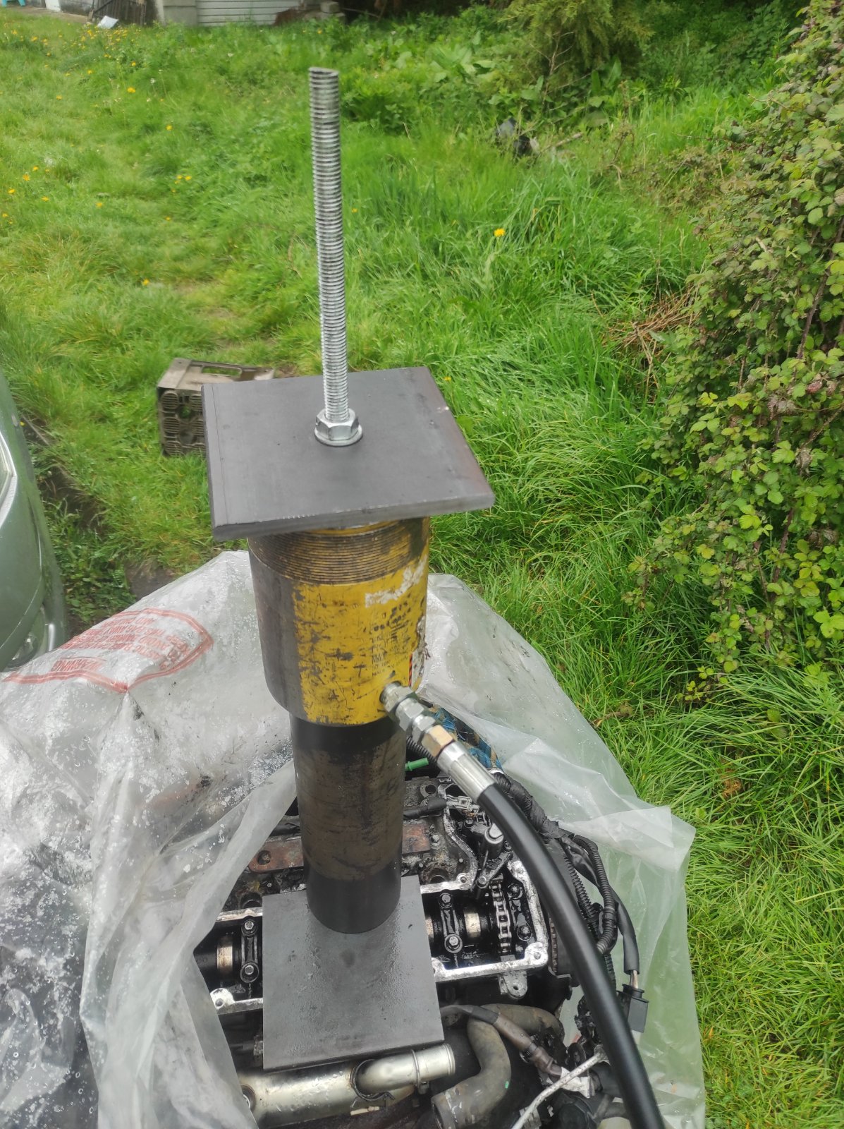

Hi Kenny, I asked when I bought the car but he was as vague as the service history. Should have walked away but it seemed ok. I'm at the last hurdle and I have set of much cleaner looking injectors to back in when I am done. I need to tap the last section and try and pull it again. what concerns me is the amount of rust on the injector bodies, is this common on these do you know. Its a lot of work to pull the injectors if you don't have a low profile slim ram. I now have it sussed how to pull them, if a slide hammer doesn't do it easily just get a ram or alternatively forget the slide hammer altogether I used a 14mm threaded rod a bit of 3in GB pipe two pieces of 1/2" plate steel one top and bottom I will take a few pics of the rig when I get a break in the weather. She will be a good car when I am finished but it is nearly a restoration project at this stage. I get the impression every penny that could be spared was, so not great the engine itself is ok but needs a bit of TLC. I did ask specifically if there had been any issues with injectors when buying and he said no, he seemed genuine enough but heinseit says different.

- Posts: 9386
- x 1939
I am so impressed by that!
KennyW
- Posts: 2615
- x 165
Impressive rig Darren,
I have no experience of the injectors on the later models. The only injectors I removed were on my Xantia 2.0 90 hp I had no problem there.
Kenny

darbuck
- Posts: 1612
- x 289
Hi lads yeah it's an absolute beast. I got a loan of the ram off a mate who got it off his mat who uses it to pull pins on trains. I knew it would pull injectors but I was afraid of what else it might pull with it. I pulled the injectors on my old mk 110 C5 years ago by hand simple job. Same on a 2.2 primera I had but these are an absolute pig to get out.they bowed to that though
. I just have the last 2 inches of the first one to remove now. I think I will need a 17 mm tap and a bit of 17 mm rod to pull it.failing that I will have to drill it out.
Darren
