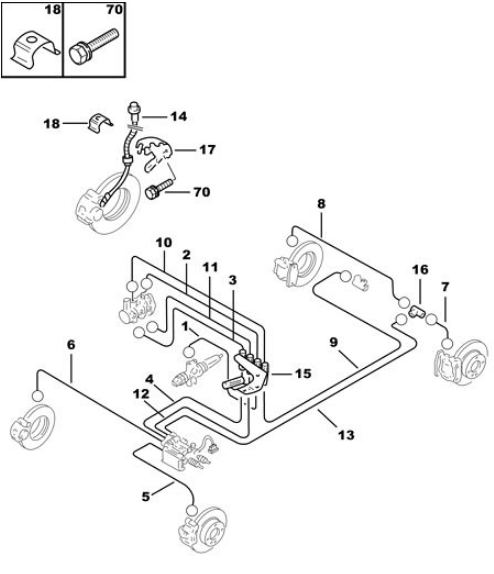

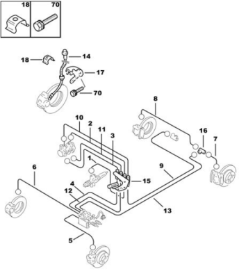

Sorry Marc but I don’t know how to link to a specific post. It was yours from yesterday at 15:31 entitled Brake PipingGiveMeABreak wrote: 28 Mar 2023, 16:11 Roger, as Mystic Meg is on holiday, can you please tell me which diagram you are referring to in the thread linked above as I have provided quite a few and I have already provided Header names for each of them? Better still, locate the relevant post in that thread and quote the post where I have provided the diagram, so I know which number (8).

Marc. This post. Thanks in advance
viewtopic.php?p=749957#p749957

In which case the answer is in the post already under the diagram.

I've moved all these posts out of the Official Parts thread to this thread as it's getting messy and the parts thread is strictly moderated. Please keep all further related posts here thanks. It may be as a result that some posts are out of synch - but essentially to answer Roger's last question in relation to number part (8):
I have stated under the relevant diagrams already provided in this thread which items are available.

Re: Hydraulic Leak 2.0HDi Xantia - STUPID QUESTION
Sorry Marc. I appreciate that part 8 isn’t available but I would like to know what length it is please? I cannot see that for the brake pipe.GiveMeABreak wrote: 28 Mar 2023, 21:17 I've moved all these posts out of the Official Parts thread to this thread as it's getting messy and the parts thread is strictly moderated. Please keep all further related posts here thanks. It may be as a result that some posts are out of synch - but essentially to answer Roger's last question in relation to number part (8):
It was only the suspension where you uploaded the part numbers matrices.
I thought I had double/tripled checked and cannot see it nor the part numbers for part 8. It might be available NOS somewhere you see. That’s my train of thought.
Thanks again

No worries - didn't include the length Roger, which is:
(8) part: 96106389, DIAM 3,5 L=2323 (no longer available).

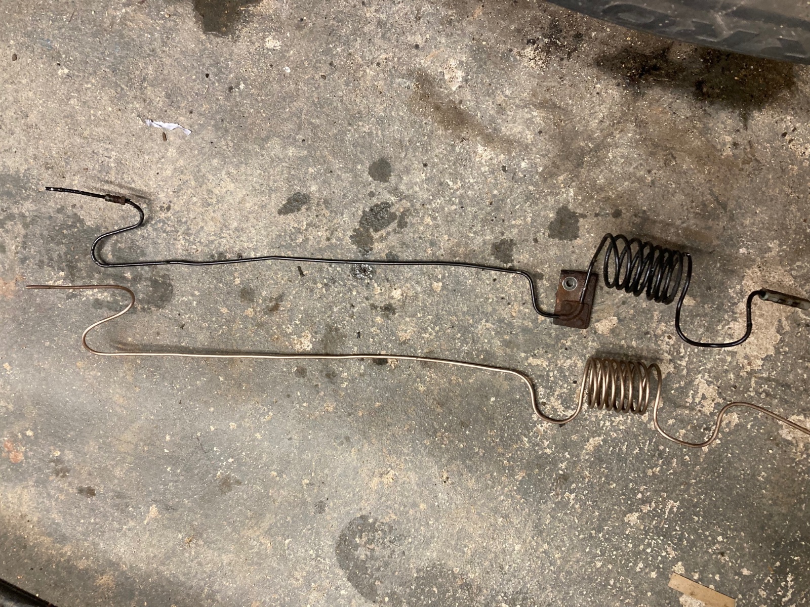

Jay. Have just given some brief thought to the pipe. I estimate there is probably 300-400mm of pipe to right of coil.
By simple calculation, those coils contain about 1100mm of pipe if 50mm diameter!!! OUCH!
Something for the weekend, Sir!
For your delectation, guys.
The bracket which holds it to the rear seat downstand has peened cap heads. Cannot be bother to do them tonight. Just want to get the pipe on.
