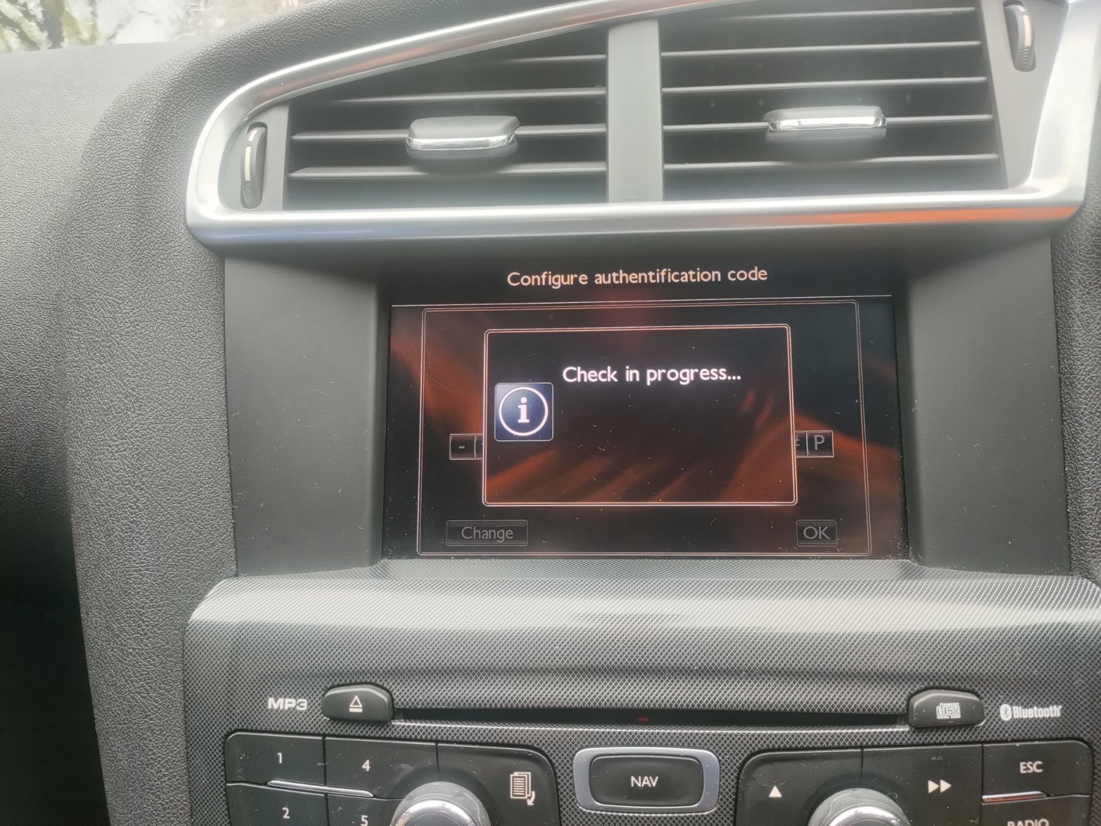

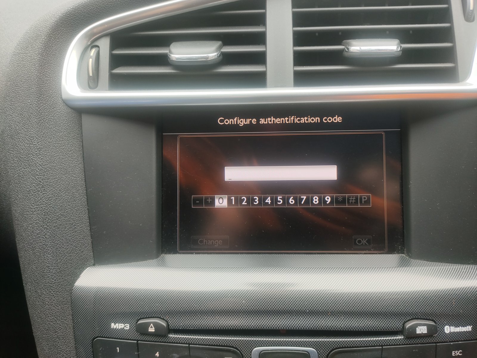

Quick update drove car today to Southampton for work. Left it 9 hours or so on start up I get this and then approx 20 seconds later I get the 2nd picture and then it reboots and just does the same.
Any ideas :)
Colin
x 6945
Re: Firmware/Map update advice needed
The first screen is as a result of the RT6 picking up your Bluetooth phone. I think on this system you chose a code using the screen, then enter the same code when it asks you on the phone screen. This should pair the phone to the RT6.
The second issue is separate and relates to navigation maps. Either the map update was aborted - mid install, that has caused corruption, or can be as a result of copying map data from one MicroSD card to another.
I suggest you sort the phone pairing first to get that message out the way, then try upgrading the navigation maps again.
I'm not sure where you ended up getting your maps, but make sure they are not corrupted.

Marc i think you maybe as usual 100% correct on the Bluetooth issue. During all the install etc i had no phone with Bluetooth enabled, even on the way to work with my work phone.
However my work phone was Bluetooth enabled on the way home as it was paired to the lorry and in my work bag :(
The upgrade was not maps but firmware from 2.05 to 2.80 on an original 13 year old SD card so still going down the route of SD card replacement and fresh install with user data on a USB stick ready to replace what has been lost.
