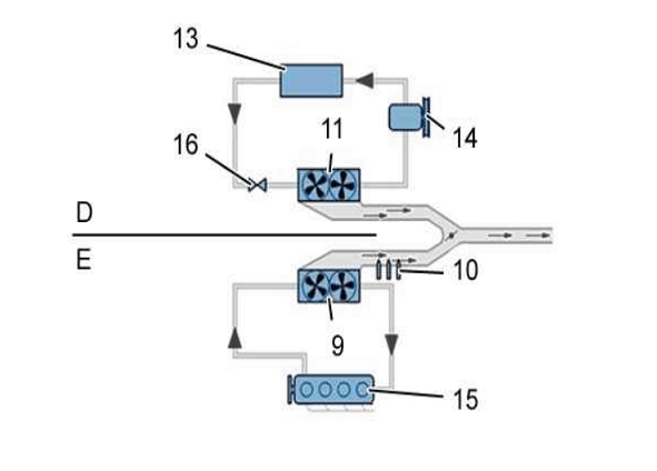

Obviously it's difficult for me to properly help from here, but if you have it at the dealer, then I would expect them to be able to find the issue - but as I said previously, it may be difficult to accurately diagnose the issue 100% because you are dealing with cool and hot air circuits and the distribution / mixing side of these 2 elements.
This is the 'Thermal Loop' of the system with Automatic Air Conditioning system:
"D" Cold Air Circuit.
"E" Warm Air Circuit.
(9) Heater Matrix.
(10) Passenger Compartment Air Heating Resistor (*).
(11) Air Conditioning Evaporator.
(13) Cooling Condensor.
(14) Air Conditioning Compressor.
(15) Internal Combustion Engine.
(16) Cooling Pressure Relief valve.

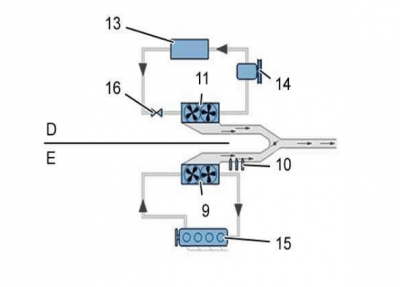

(9) Heater Matrix.

Re: C4 Picasso 2015 (B78 plate) Heating problems
Many thanks Marc you are very kind and helpful. I Will chip in some donation.

Excuse me for jumping in on this heater problem thread 2 years late, but the parts diagram posted by Givemeabreak, is the only reference I can find for the part I need replacing on my car, which is a 2011 LHD edition. See: the part numbered 14 on the diagram, the 2 identical dual-levered long arms are both perished and need replacing. Is there a part number for item 14?
