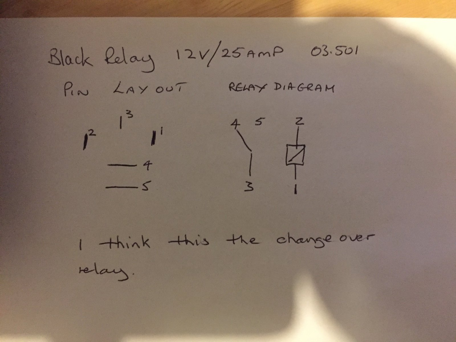

Re: Xantia A/C
Okay, I found one of my burnt relays with the numbers printed on the back at the pins.
I will post a diagram trying to explain the back of the relay
I hope this makes sense
Kenny
Can the photo be rotated 180 degrees please.
Kenny

KennyW
- Posts: 2615
- Joined: 17 Jan 2006, 21:22
- x 165
Re: Xantia A/C
Colin,
Further to the Peugeot planet diagram, I have the following:
From what I do think, the sender switch has a permanent 12 Volts on pin 1.
Shorting pin 1 to pin 2 sends 12 V to one relay to operate the low speed on both fans.
Shorting pin 1 to both pins 2 & 3 energises all 3 relays to spin both fans at the high speed.
Hopefully this will help.
There is a load of info on the dual fan and A/C which is all related but does not necessarily operate together.
Kenny
