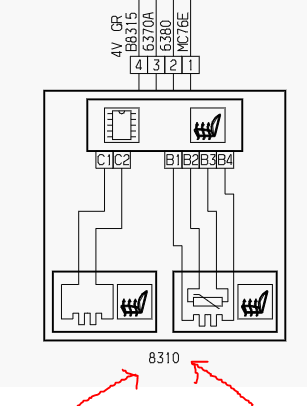

- x 6957
Re: Heated Seats stopped working C5 x7
Here are the resistances for the X7.
I can't understand your wiring numbering in your post.
From the wiring Diagram I put up, tell me the hardware number of the item that is shown underneath and then I can help with the connection designations, for example:
8310: Driver´s Heated Seat
I can then provide you with the connection info for the pins 1-4
| Vehicle | Seat / Backrest | Measuring Point Pin Number | Minimal Value | Maximal Value |
| C5 (X7) | Seat | 1 - 4 | 0,72? | 0,95? |
| C5 (X7) | Seat | 2 - 3 | 4 k? | 10 k? |
| C5 (X7) | Backrest | 1 - 2 | 0,79? | 1,05? |

I've this single plug module, i can't find it's pinout.
Pins I've numbered are done in relation to this plug in the picture below. So 1 is upper left corner, 2nd is empty, 10 is bottom right corner.
When it comes to the schema for one 8310. it has this single plug with 10 pins.
1. [4] so +12v
2. Empty
3. Pin [B2] of 8310 goes to the thermistor of the seat
4. I dont't know to which pin in 8302 goes
5. I dont't know to which pin in 8302 goes
6. [B4] of 8310 goes to the heater of the seat but also to the backrest
7. [B1] of 8310 goes to the heaterof the seat but also to the backrest
8. GND connected to 8302 and to 8310
9. [B3] goes to the thermistor of the seat
10. I don't know to which pin in 8302 goes
Because I found that pin 6,7 and 3 and 9 goes to the green plug:
And then to the seat, and there is no separate plug which goes to the backrest, I'm assuming that backrest is powered from the same plug.
1. [4] so +12v
2. Empty

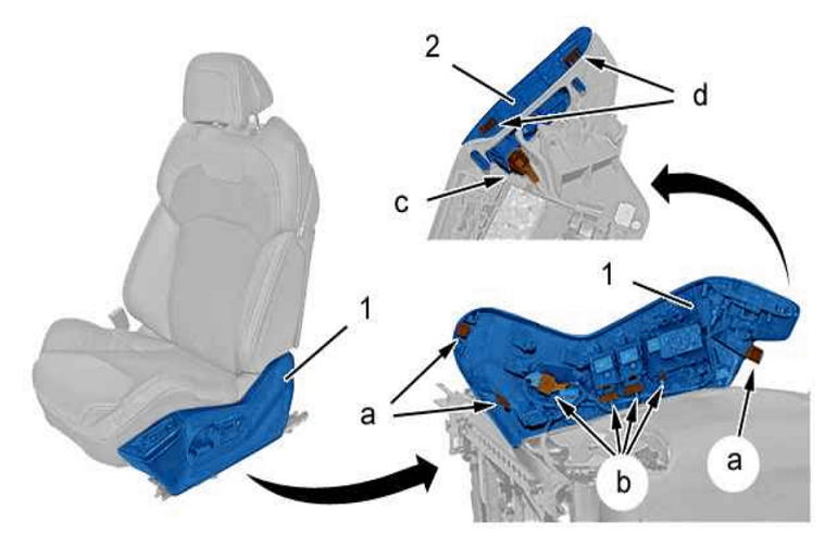

Just picking up on this old thread as I need to fault find parasitic drain on this circuit and I want to get the heated seat switches out of the seats, as part of that.
Marc posted the instructions/diagram below (you have to remove the side trim in order to remove the switch
because of how the plug fits into the switch)… It says to release clips a (x3) and then pull the side trim away.
I can release the single front clip and I think the lower of the two rear clips releases by just pulling up, but I can’t see how to release the top ‘a’ clip - in fact, I can’t even see or find that one!
Can someone who has done this (without breaking anything!) please shed any light?
GiveMeABreak wrote: 29 Sep 2019, 16:36 You might need to remove the front seat to get proper access to the seat side trim, then:
Unclip: The side trim (1) ( as "a"), using trim removal tools.
Disconnect the connectors ( as "b", "c").
Remove: The side trim (1).
Unclip the trim (2) ( as "d").
Remove the trim (2).

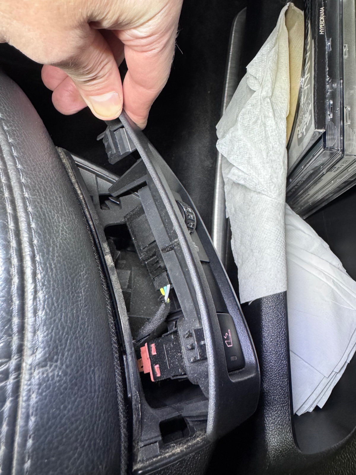

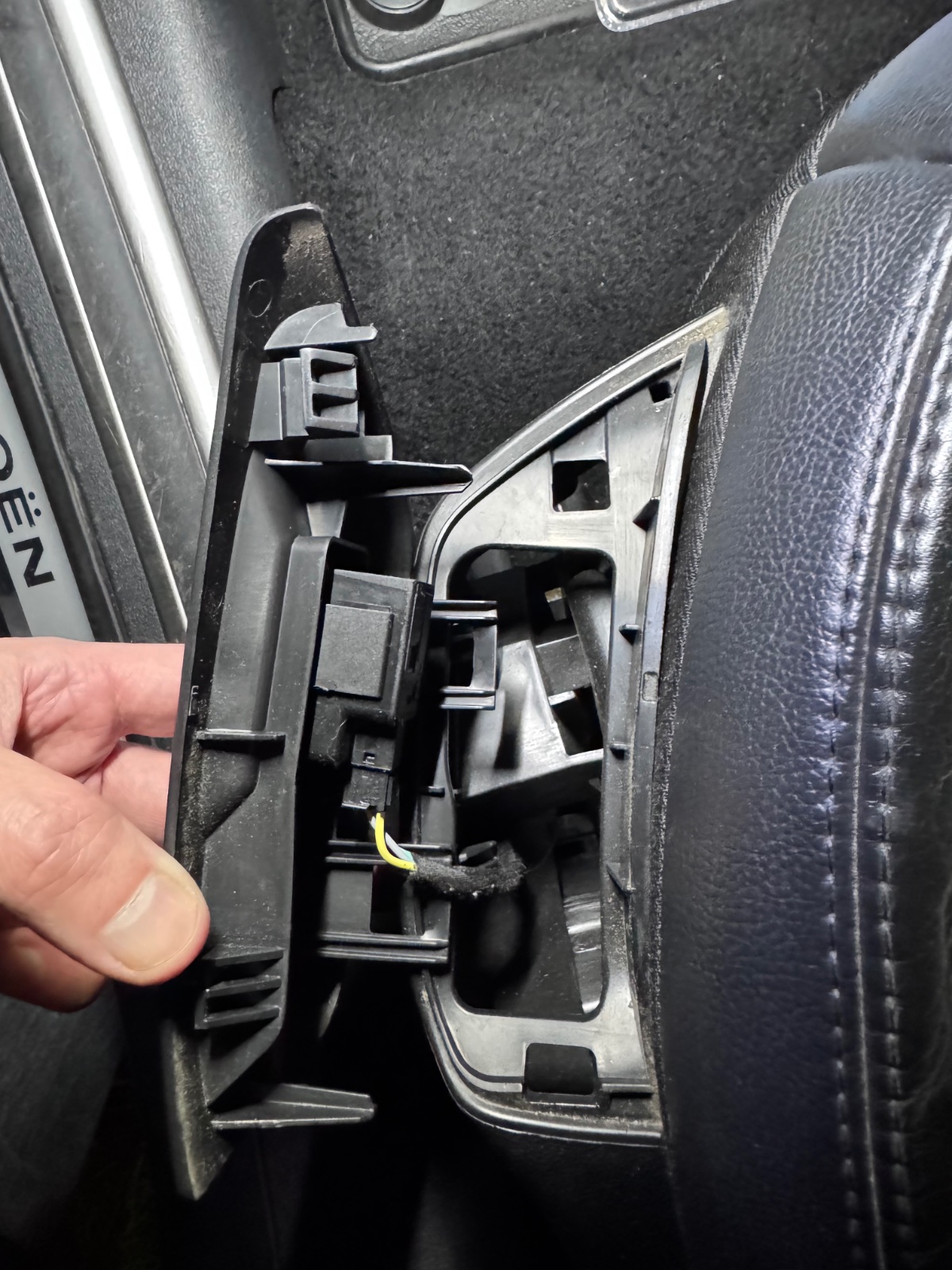

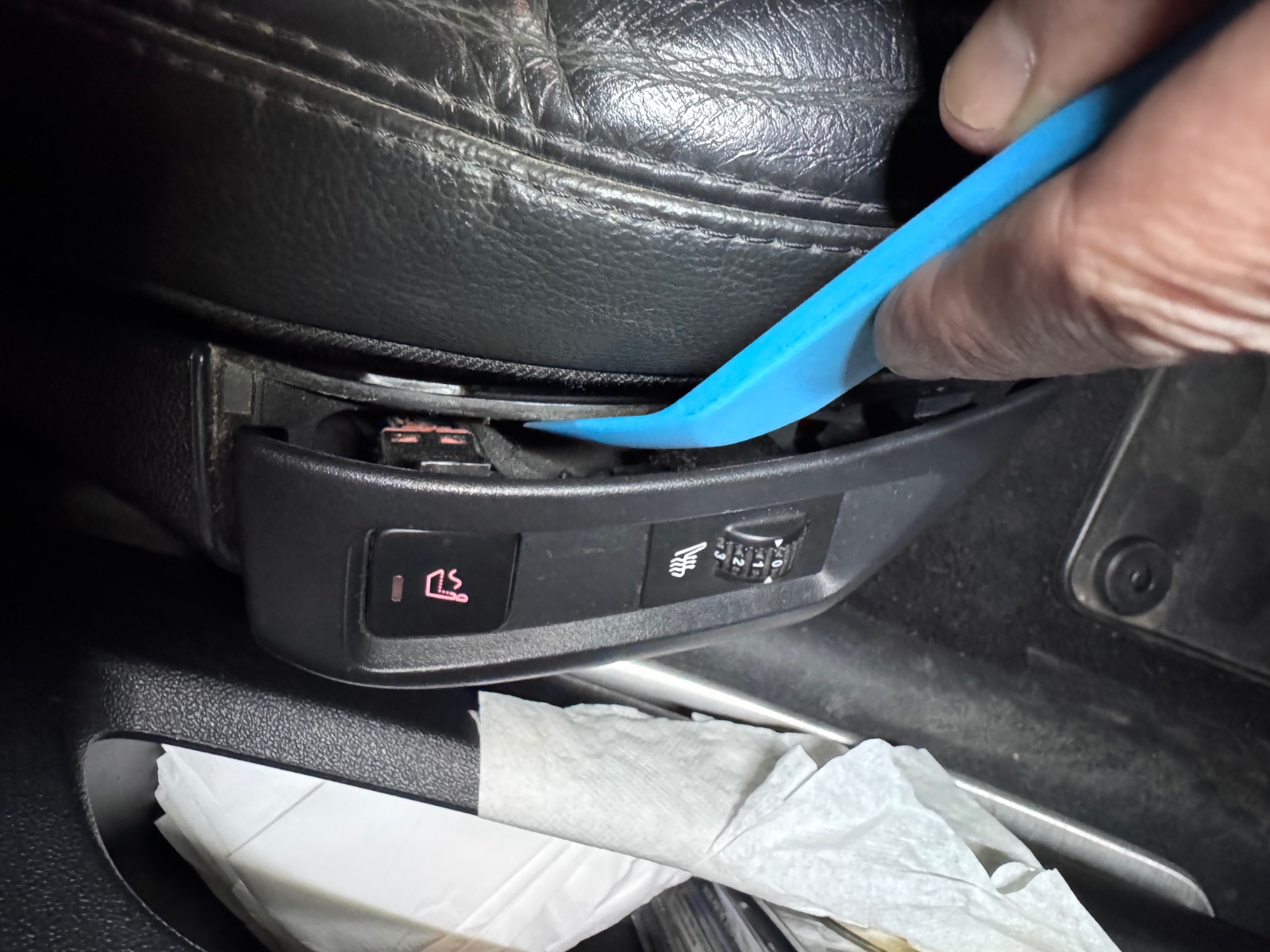

Managed to get the panel that holds just the heated seat switch and massage seat switch off.
It’s not ideal (it’s not meant to be removed this way) and it did bend a couple of the tabs unfortunately, but without breaking them…
You can reach the front clip with a hand between the seat squab cushion and the side of the panel, depress that with your finger (don’t press too hard or it will break) and that will lift the front out slightly clear from the side panel.
Then slide a plastic trim tool in (vertically) at the front in the gap you have just created and slide it along towards the back, to pull the inside of the side panel away from the panel, towards the seat squab, which completely releases the inside of the panel from the seat side trim. You cannot depress the rear tab with your fingers, peeling the side trim away from the panel is the only way it will work.
The outside of the panel is then still held in place by two clips lower down nearer the door, but it is possible to free it by tilting it away from the seat squab (towards the door opening) and reaching up behind the side panel on the seat to release the clips. Those clips are VERY thin so will likely bend unfortunately, which means they won’t hold it tightly in future.
The wire to the heated seat switch is ridiculously short, basically no slack.
A few pics below in case others find it helpful.
