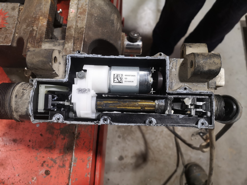

Hello!
Does anyone know where to get this gear?
Thanks!
Thanks!
- Attachments
- x 6957
Re: C5 X7 2.0 hdi auto electronic parking brake problem
Citroen only sell the complete handbrake control unit. You'll have to try and source one from a car dismantler I think - or buy a second hand one.

sorinp
- Posts: 3
- Joined: 10 Sep 2021, 15:24
https://www.drive2.ru/l/4856725/
I will try this option
- x 6957
Good luck with that! Seems a job, but if it works, great.
It's another reason to make sure the electronic handbrake is put in maintenance position before callipers are changed or any other maintenance using the diagnostic tool and also to disconnect the battery after doing so, to make sure that the handbrake is not automatically applied when the ignition is switched on before you take it back out of maintenance mode or this can lead to damage.
