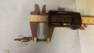

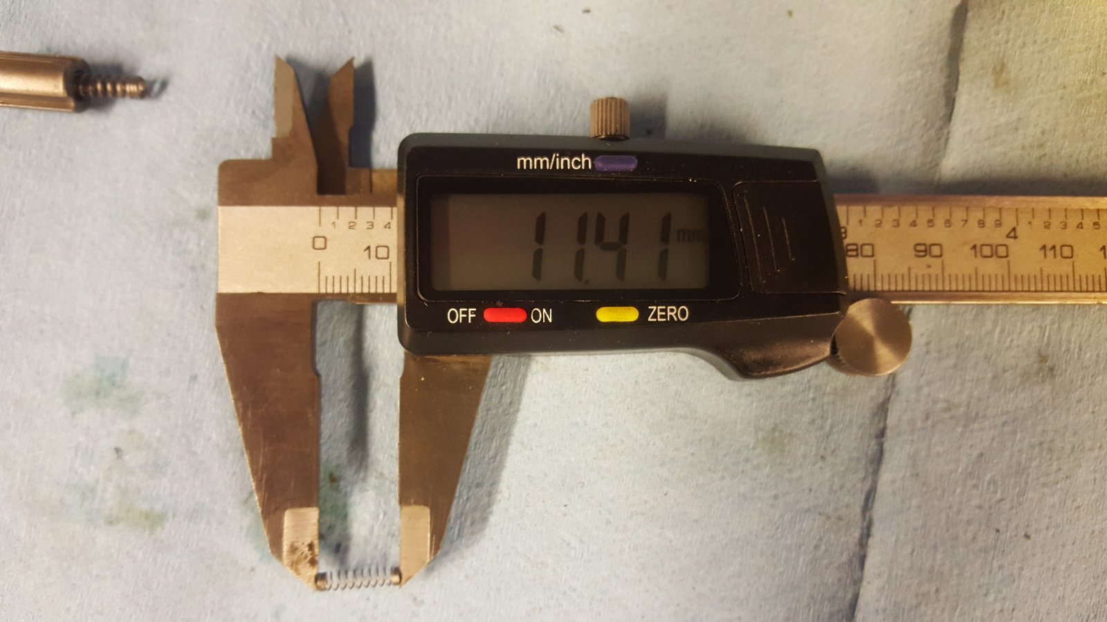

I've now had a look at the front electro valve. Fortunately it's relatively easy to remove from above although very tight.
So i removed the small spring and checked the length - it's a little over 9mm in length. I stretched it over a few times and checked the length each time and it is now 11.4 mm. I didn't want to go mad this time. I looked at the needle valve and cleaned it but cannot tell if it's worn at all. Or if the corresponding seat is worn. Reassembled with new locktite and primed up and running. No leaks so far. Bit of citaerobics and a few jabs of the accelerator to make the electro valve shuttle under pressure. Just to get everything settled back in.

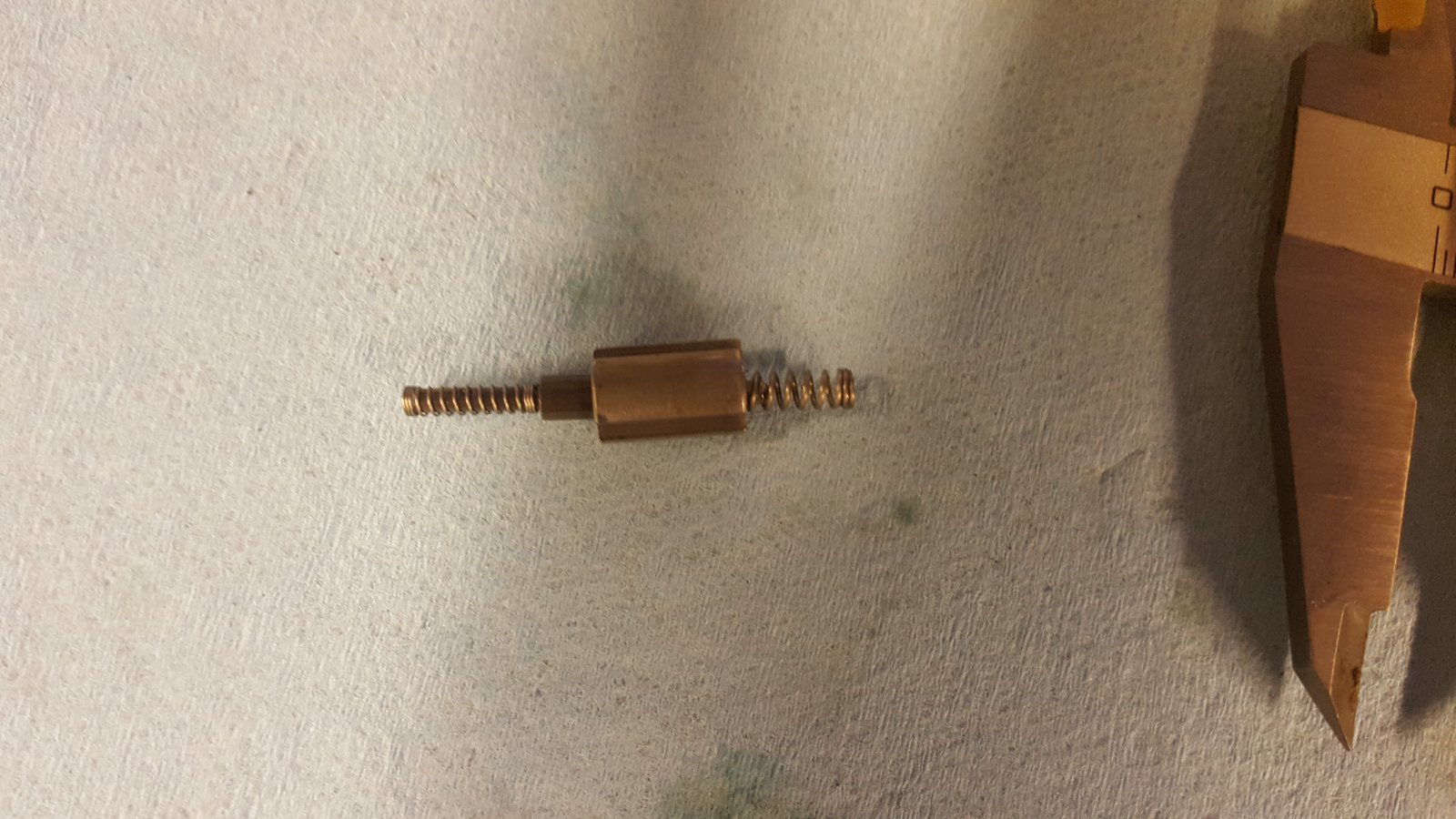

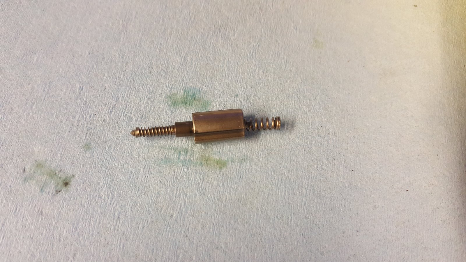

can see the little spring measurement before and the larger spring too. Two pictures show how the small spring sits in the needle valve before and after.
Strangely reminiscent of a paint gun valve.
