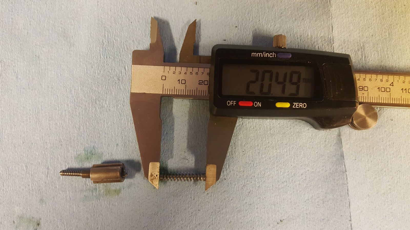

I've now had a look at the front electro valve. Fortunately it's relatively easy to remove from above although very tight.
So i removed the small spring and checked the length - it's a little over 9mm in length. I stretched it over a few times and checked the length each time and it is now 11.4 mm. I didn't want to go mad this time. I looked at the needle valve and cleaned it but cannot tell if it's worn at all. Or if the corresponding seat is worn. Reassembled with new locktite and primed up and running. No leaks so far. Bit of citaerobics and a few jabs of the accelerator to make the electro valve shuttle under pressure. Just to get everything settled back in.
Not driven yet but soft mode is there as is hard. Initial assessments of the regulator tick time isn't looking great - seems to still be quite fast although it might be very slightly improved.
I have a drive home later so will see what happens. Thanks for the help so far.

I've driven back home and found the front now rides a lot better.
The tick times however are still fast at 16 seconds in soft mode.
I used the modified master switch I fitted to override the ecu power and switch off the hydractive to switch it to hard mode while it's running and now i notice the tick time in hard mode is immediately up. I was getting between 35 to over a minute (it seemed to be increasing each time) so after 5 minutes i switched the ecu back on and immediately it returned to fast tick times of 16 seconds although strangely, this too improved to 21 seconds over the next few minutes timing it.
All I've done is stretch that little spring a bit. I might revisit this but will be after the chevrons rally now.

can see the little spring measurement before and the larger spring too. Two pictures show how the small spring sits in the needle valve before and after.

Mini contribution to this: After I got a new set of tyres a few weeks back I noticed no improvement to the strance 'wobbliness' at times even after the work I'd done recently to revamp the Hydractive Electro Valves.
Today however, I removed the 15mm wheel hub spacers from the rear wheels and the 3mm spacers fromt the front. It was like traveling back in time..... to when the car used to work properly.
25 mile journey later I'm convinced that the whole problem was caused by the wrong offset on the rear wheels. I think I had underestimated the effect of offset on the trailing arm arrangement. I thought trailing arms would be practically immune to badly chosen offset but there must be some aspect of, maybe, the fixed camber or something. I also think the wider rear track (although still 6mm narrower than the front) was giving too much of a mechanical advantage diagonally.
Anyway, the spacers shall now remain off!

Now you mention the altered offset, I recall that Xantia, XM and ZX all have "passive rear wheel steering", which I guess would be affected by altering the geometry of the arrangement.

Yes Chris, and for a white I was wondering how the passive rear steering stood up after all these years. I wondered if the flex mounts responsible for the set up might be failing. No real way to test it though. Anyway, honestly it is still feeling better after removing the spacers and looking at the car; to me it looks fine without them (I don't know what I was thinking fitting them ...)

Apologies to everyone who helped with this subject, particularly White Exec. Turned out there was a bush gone in the right-front lower suspension arm, lateral forces were shuffling it from side to side causing that cork-screwing... ! Sorted it all out and then not long after the car started running incredibly rough, only occasionally able to start it, so it has been parked up stationary other than when I have another go at getting it started. And... recently indulged and bought a low mileage Xantia X2 HDi so focusing on tweaking that to my liking at the mo...
