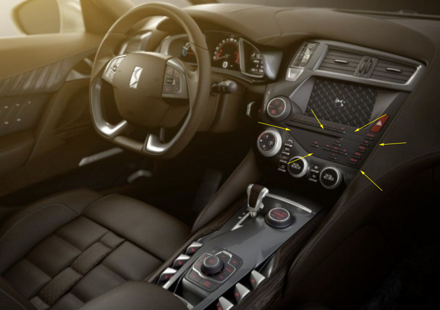

Sound job. A couple of tips - these units suffer from heat and there is not enough air surrounding the unit to cool them properly, so not saying you need to have frostbite on your chin, but a cooler cabin setting will help on longer journeys.
- Posts: 11011
- Joined: 09 Nov 2005, 22:03
- x 1481
Re: DS5 intermittent working satnav/radio
GiveMeABreak wrote: 19 Jul 2019, 17:32 Sound job. A couple of tips - these units suffer from heat and there is not enough air surrounding the unit to cool them properly, so not saying you need to have frostbite on your chin, but a cooler cabin setting will help on longer journeys.
Would it be worthwhile fitting a small 12V computer fan to improve the air circulation?
- x 6948
The issue on the DS5 Mike is that the RT6 is integrated behind the central fascia where I've arrowed. So the cooling really needs to be behind the central console. Not a lot of room to stick anything anywhere on the DS5 though
