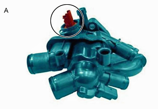

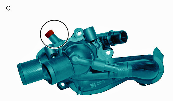

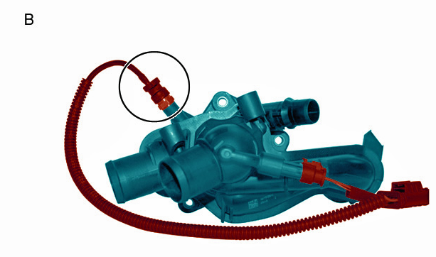

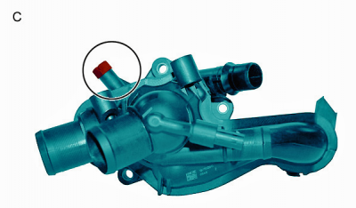

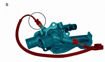

Hi Anthony, the was an issue with these outlet tanks that affected Euro 5 emission control standard EP engines - where there was an incident linked to the engine coolant temperature sensor.
So although you have a leak and may not have the related temperature sensor issues, as you have found a replacement unit is likely to be the modified type and this is where your problem may be in the connections. I have put a little info here on the modification for a C5 X7 with this engine type - that was typical of some of the EP engines used across the range.
Depending on the engine, there are different coolant outlet housing assemblies:
Naturally aspirated EP engines
Assembly of a coolant outlet housing with clipped engine coolant temperature sensor:
For models with version 'C' in the table, the repair was to fit the engine coolant temperature sensor in place of the bleed screw and this would then require the modified harness. This example was for the same issue on an X7 - but applied to other models. So I'm not sure a wiring diagram is going to help here if it is a matter of undertaking the modification.
- The number of outlets depends on the type of engine (naturally aspirated or turbocharged) and the gearbox (manual or automatic).
- The presence on the production assembly of a clipped or integrated engine coolant temperature sensor (This assembly may already have been modified in after sales)
- Manual gearbox, from RPO number 13540
- Automatic gearbox, from RPO number 13583
- Assembly of a coolant outlet housing with engine coolant temperature sensor installed in place of the bleed screw.
| "A": Coolant outlet housing with removable engine coolant temperature sensor installed next to the bleed screw: Fitting correct No operation is necessary. | "B": Coolant outlet housing with integrated engine coolant temperature sensor and engine coolant temperature sensor fitted with a wire installed in place of the bleed screw: Fitting correct, no operation is necessary. | "C": Coolant outlet housing with integrated engine coolant temperature sensor and bleed screw: Incorrect fitting, carry out the repair. |

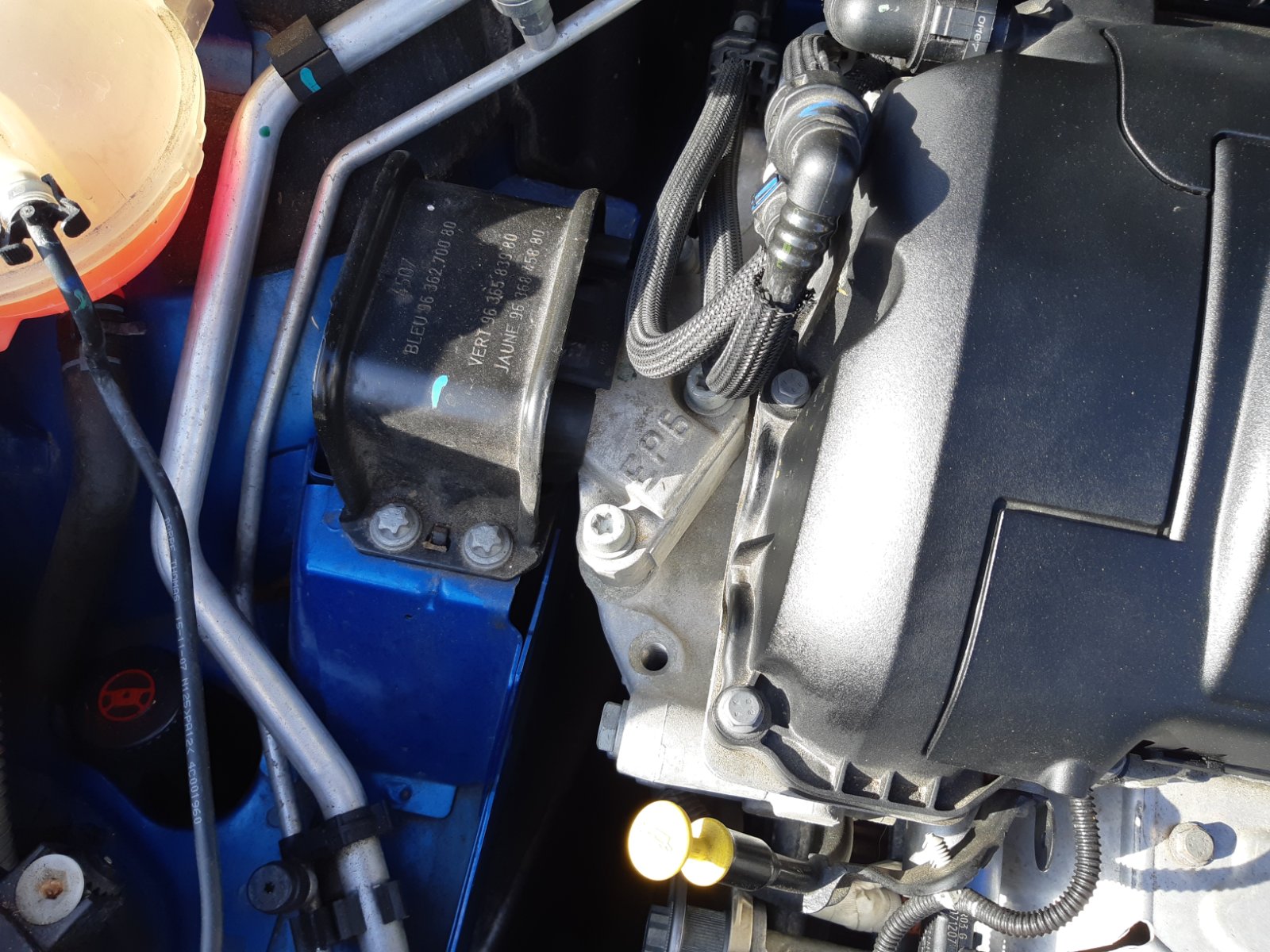

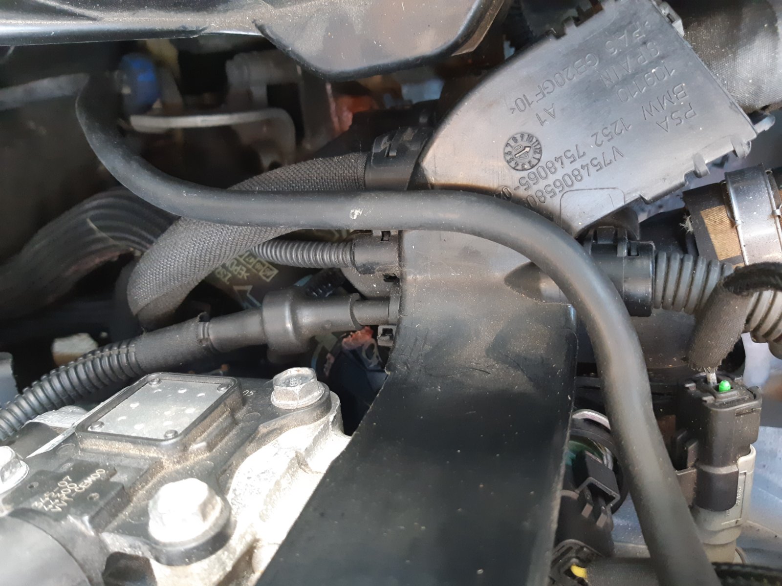

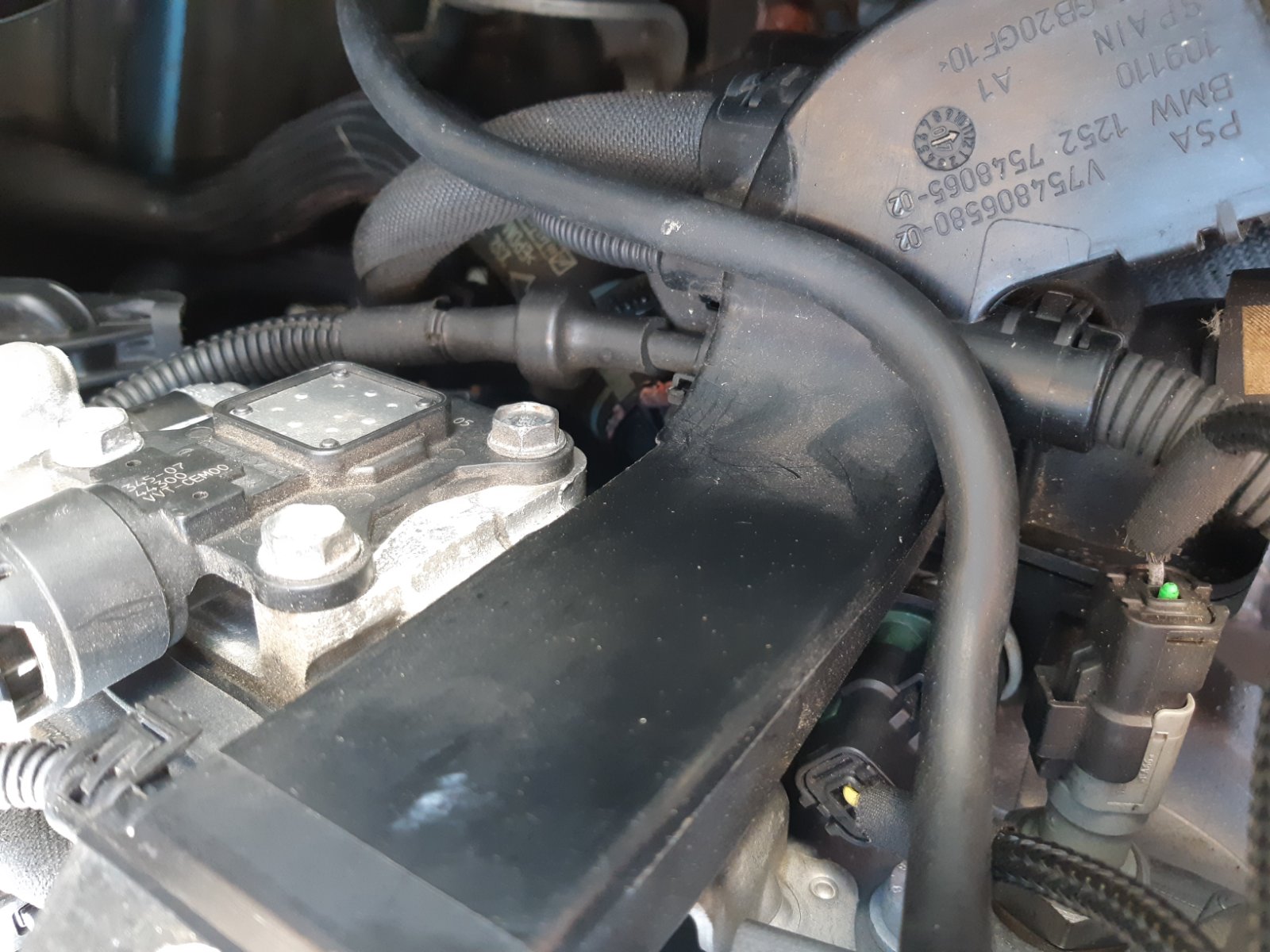

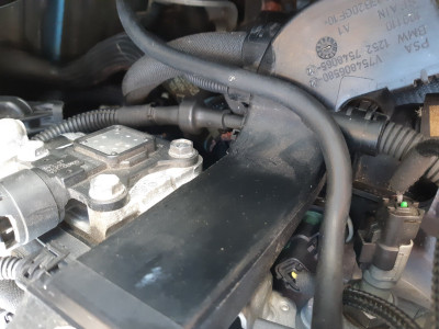

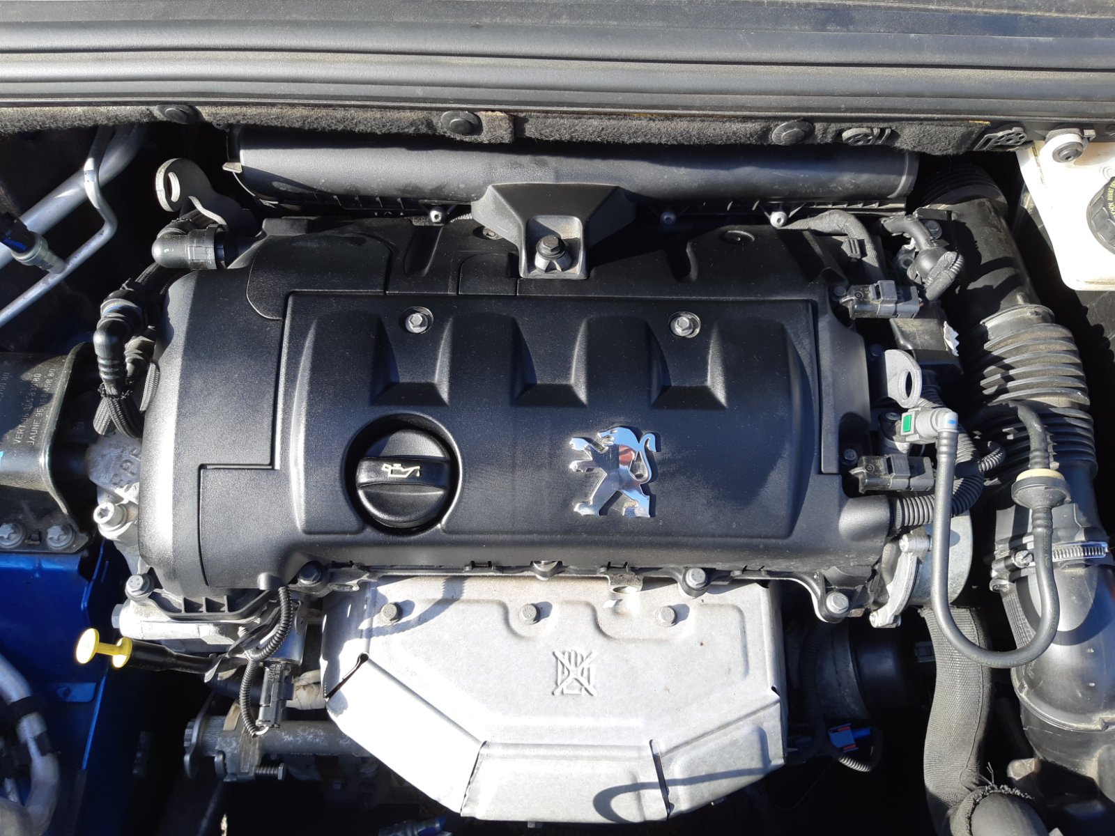

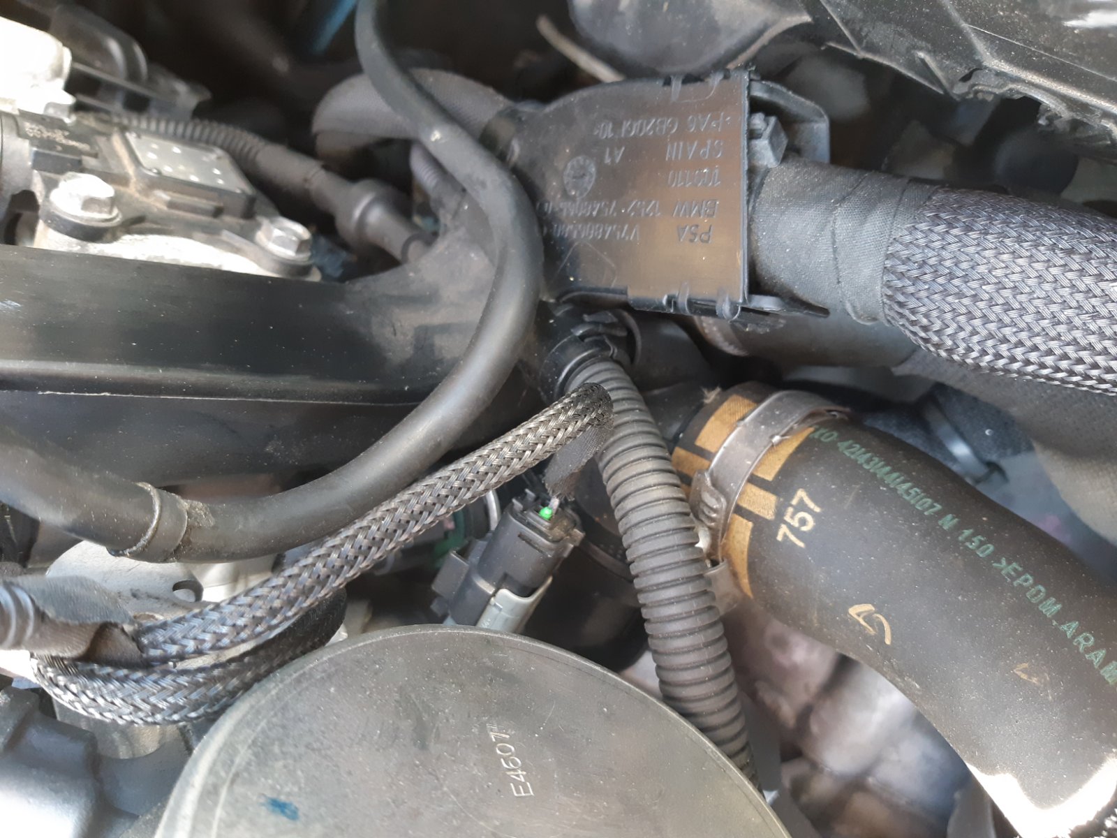

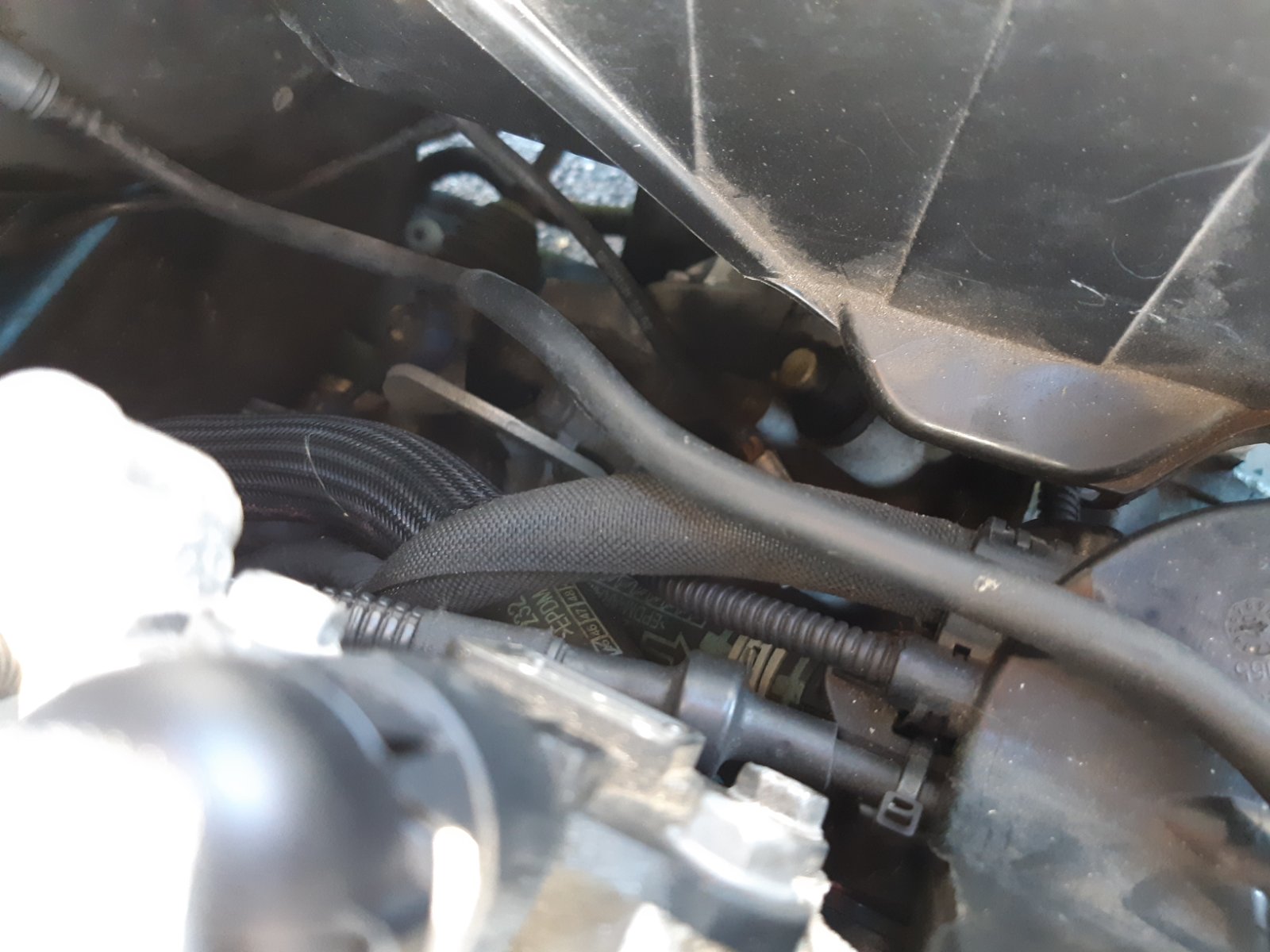

Hi there here are the pictures of my engine and thermostat. Also there is no bleed screw on it and the picture is of coolant sensor with a 2 pin plug which is vertical position.

Hi thanks Marc, version A thanks for pictures have found bleed screw hidden, and now have found extra 2 pin plug, doh what a donut. Thanks for everyone's help. I'll get new thermostat ordered, and also the rear pipe as I believe this fails quite frequently when replacing thermostat.

Well located Anthony - I must admit that's a pretty crammed engine bay!
