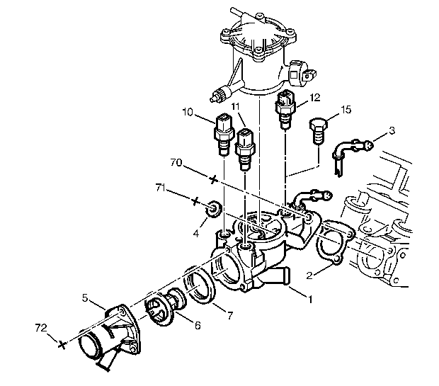

The question is would I have caused any damage, I am sure I checked the thermostat fitting into the housing as per other pictures and to be honest I can't remember what way I took it out now. Every picture here shows the thermostat fitted in the opposite direction. But funny enough the hot water is still coming through the top hose, so that tells me the thermostat is still opening. Even haynes manual shows the thermostat in the housing opposite to your pictures. And I am sure I did try the other way, but it wouldn't fit. This would be a nasty mistake and it's confusing. How do you upload pictures. Anyway I can only put it right now and hope for the best. Can anyone else shed some light on this please. Hey thanks for that Chris will do all this checking tomorrow. Really appreciate all the help.

The thermostat is shown the correct way round in the Citroen parts diagram.
It sits in the water outlet (from the engine block) housing, and the copper-steel 'piston' (waxstat) part of the thermostat always points into the hot water trying to get through it. The little opening disc/shutter points towards the radiator, and is the exit side of the 'stat.
To check that the 'stat is doing its stuff, with a cold engine, start up, and use your hand to feel the radiator hose leading away from the thermostat housing. It should stay cold for a good while, even though the engine block (and the cabin heater) are producing decent heat. After maybe 15 mins of running, the 'stat will begin to open, and warmth will emerge through the 'stat. If it gets progressively warm from the word go, then the 'stat is stuck open (or missing!).

Thanks Chris I thought I had put it in wrong for a moment, but if you look at Marcs diagrams all of the stats seem to be sitting the other way around. (ie) you can see clearly the triangler bridge peice protruding towards the housing. I know for certain on some Renault engines the thermostat faces the opposite way around spring facing water pump in lower bottom hose. So maybe I've just got another problem somewhere. Well will hopefully sort it out tomorrow if it dosent continue to snow.
