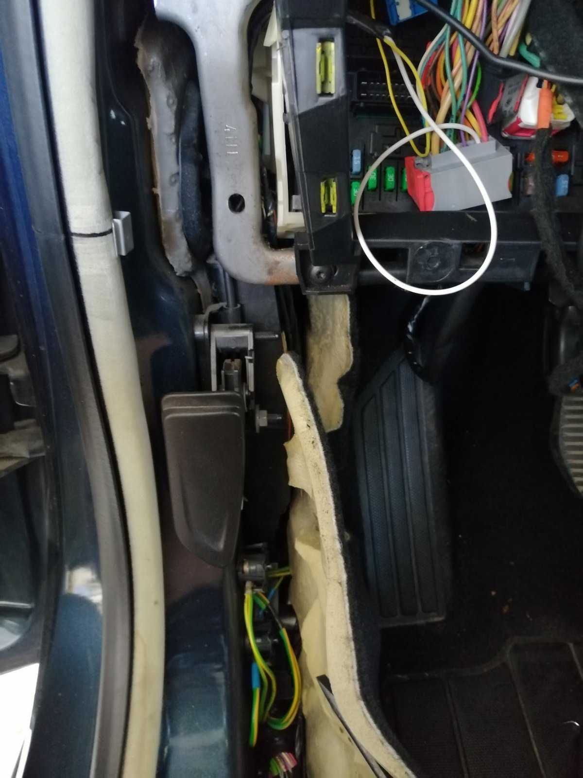

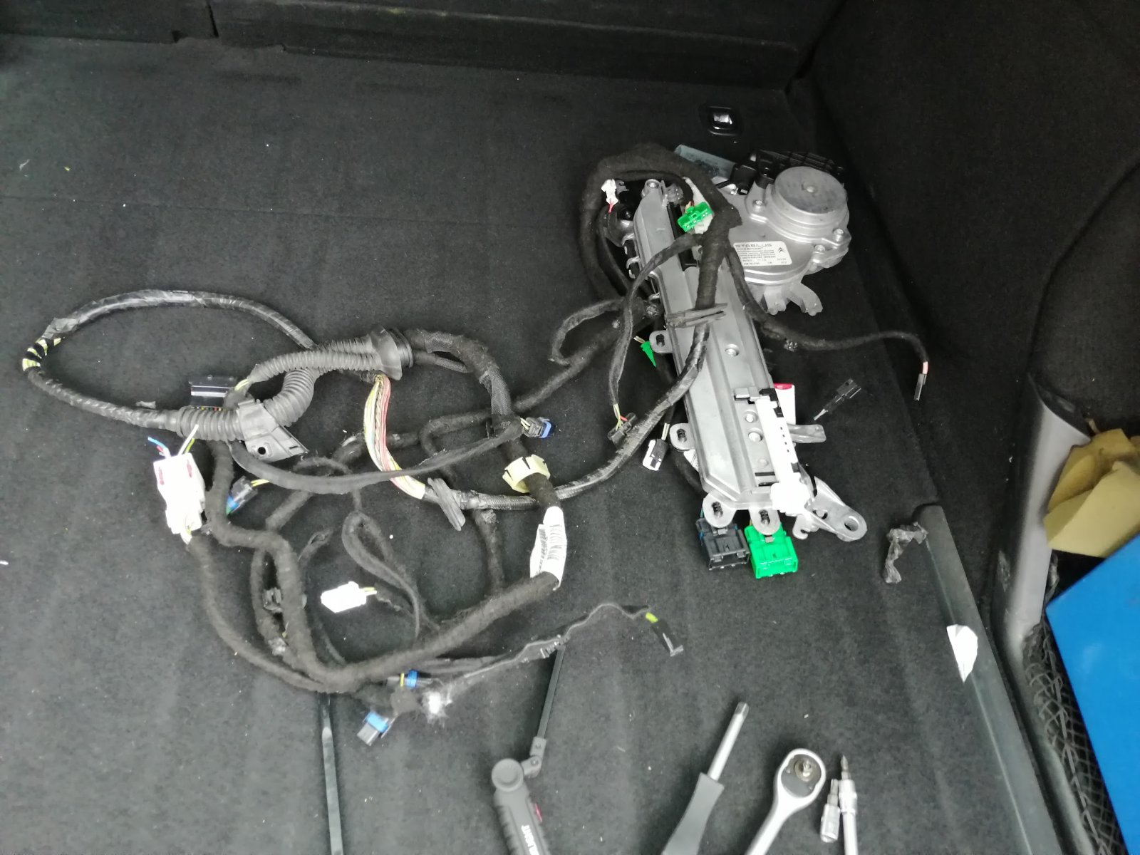

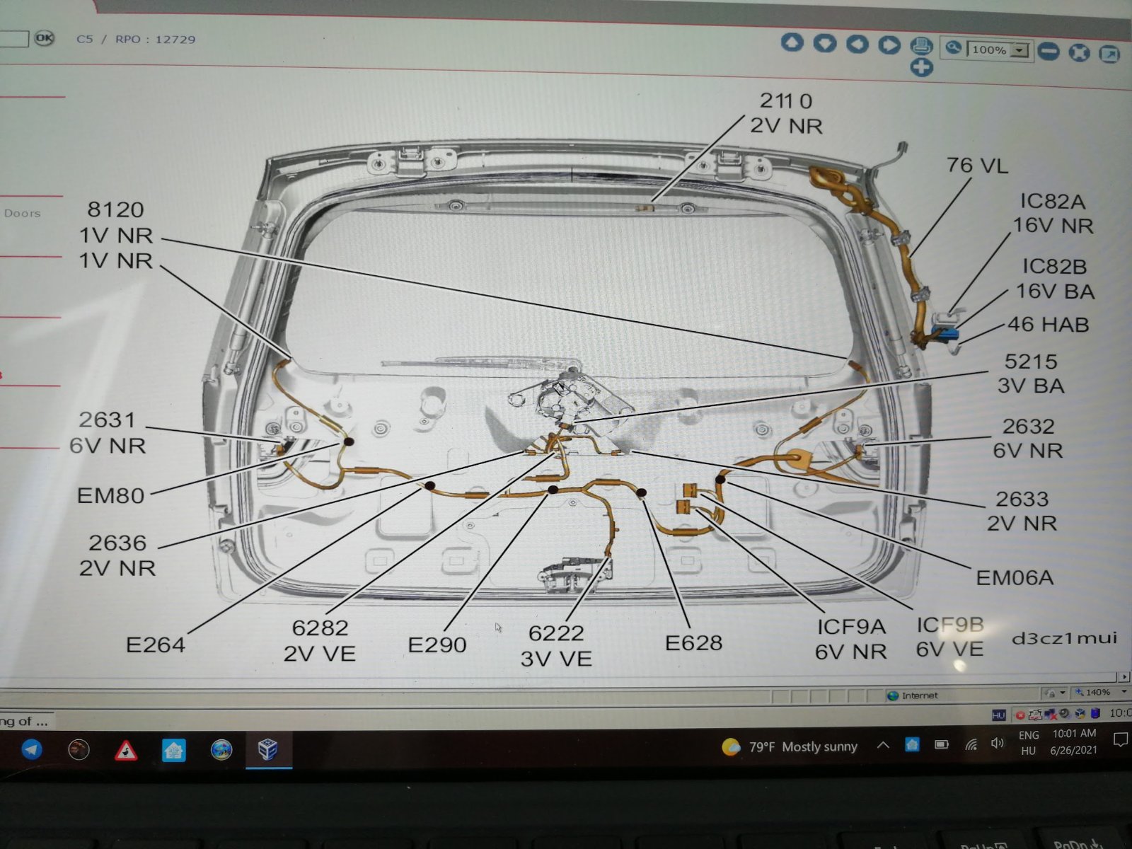

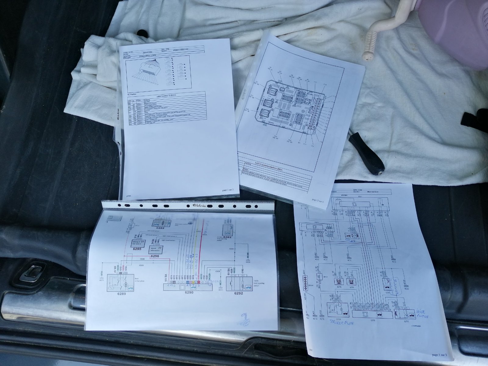

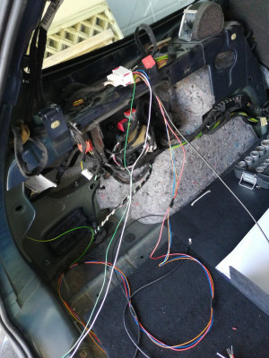

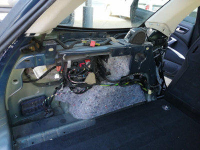

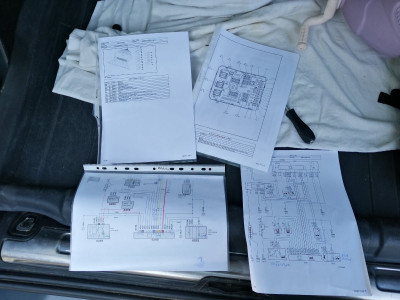

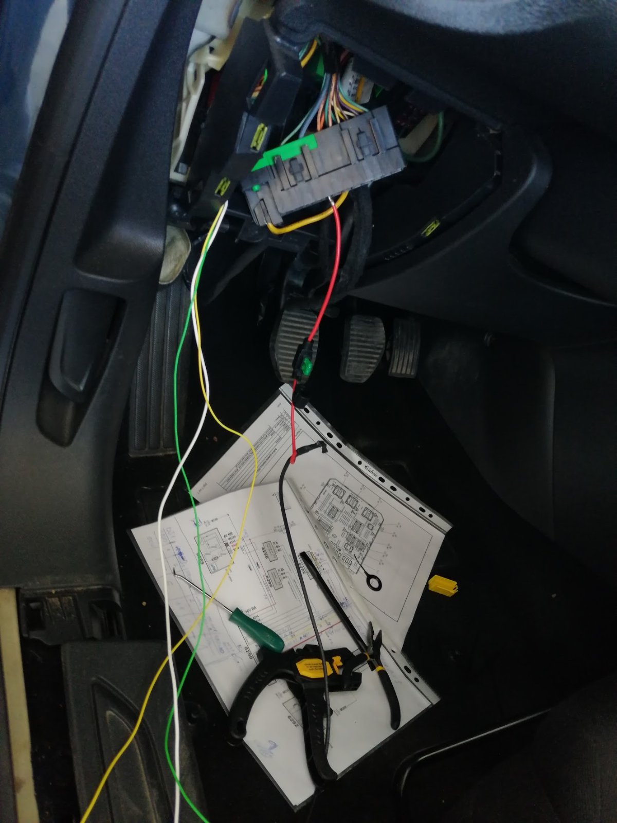

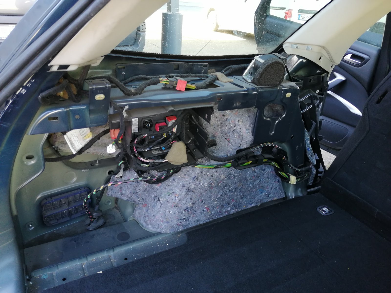

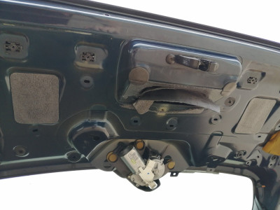

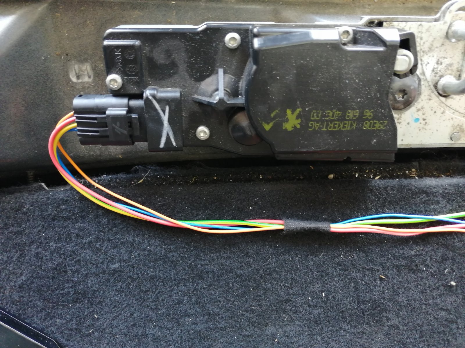

I'm... going to be brave here. I will do the electric tailgate retrofit on my friend 2008 tourer.
Marc, would you be kind and post up a wiring schematic from the tailgate ecu to the bsi?
I know the wiring goes on the left side of the trunk and theres two connector (that goes to the tailgate) above the v6 battery. (also a big harness besides the 2 connectors)
I have a whole rear electric tailgate on hand 8-)

Re: X7 electric tailgate
Unfortunately the wiring is by build date and options - so having checked already, you won't have the correct wiring looms to start with on a 2008 tourer compared to when the motorised versions came in - the looms are completely different.

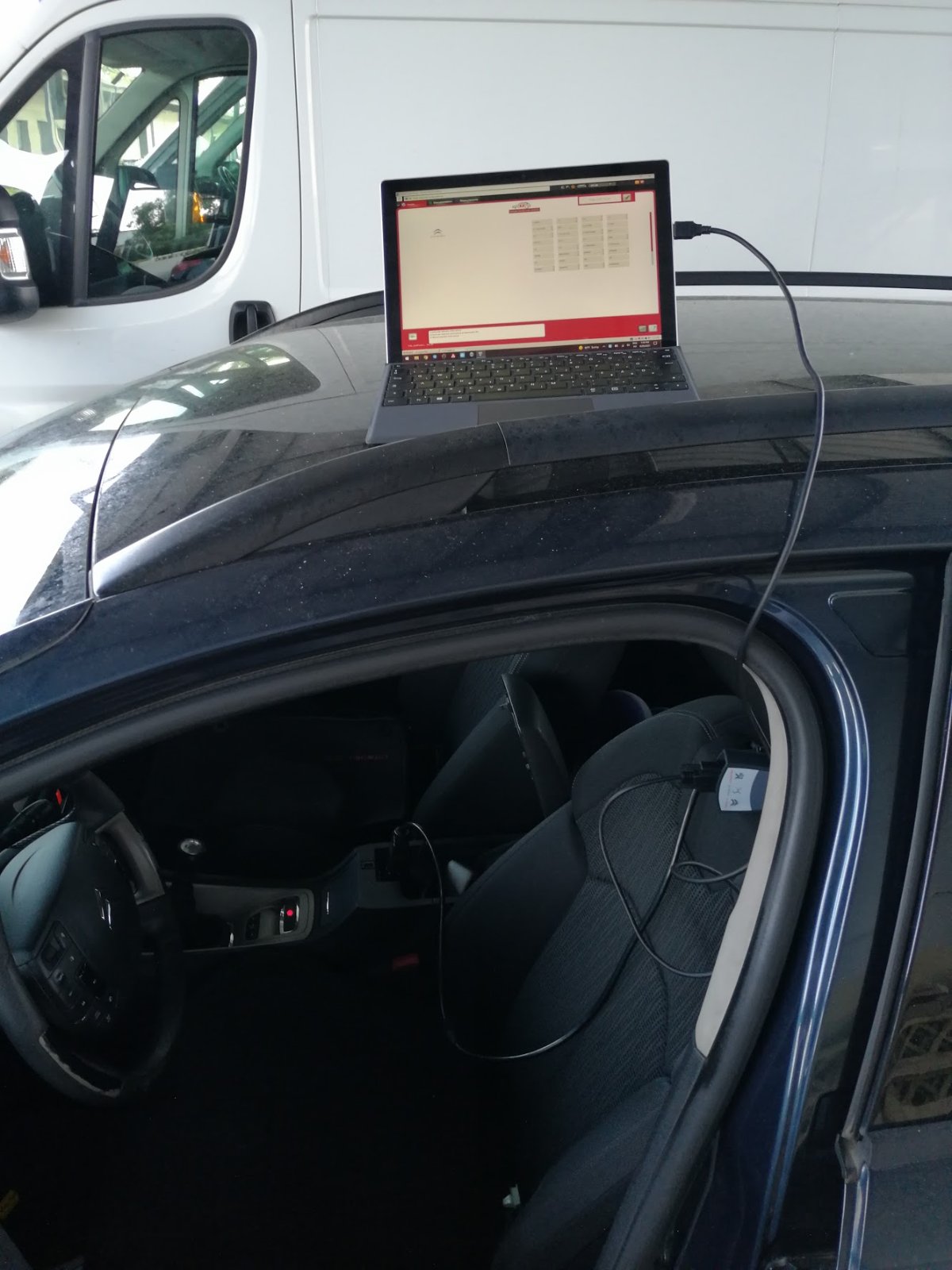

I have a 2012 tourer and I have the e-tailgate parts and wires sitting on my shelf. I got them when I got rear ended and the parts car replacement tailgate was electric. Is there ready connectors behind the plastics where I can connect these wires? I don't have the "foot lift" sensor, but is it neccesary? I have diagbox if programming is needed.

There’s no foot lift sensor. The motorised tailgate is opened and raised via the key fob middle button for originally equipped models. It is closed using the button on the tailgate.
But the question still remains - if you didn’t have the electric tailgate as original specification, then you will have a different wiring loom - both in the tailgate and in the various looks back to the BSI.

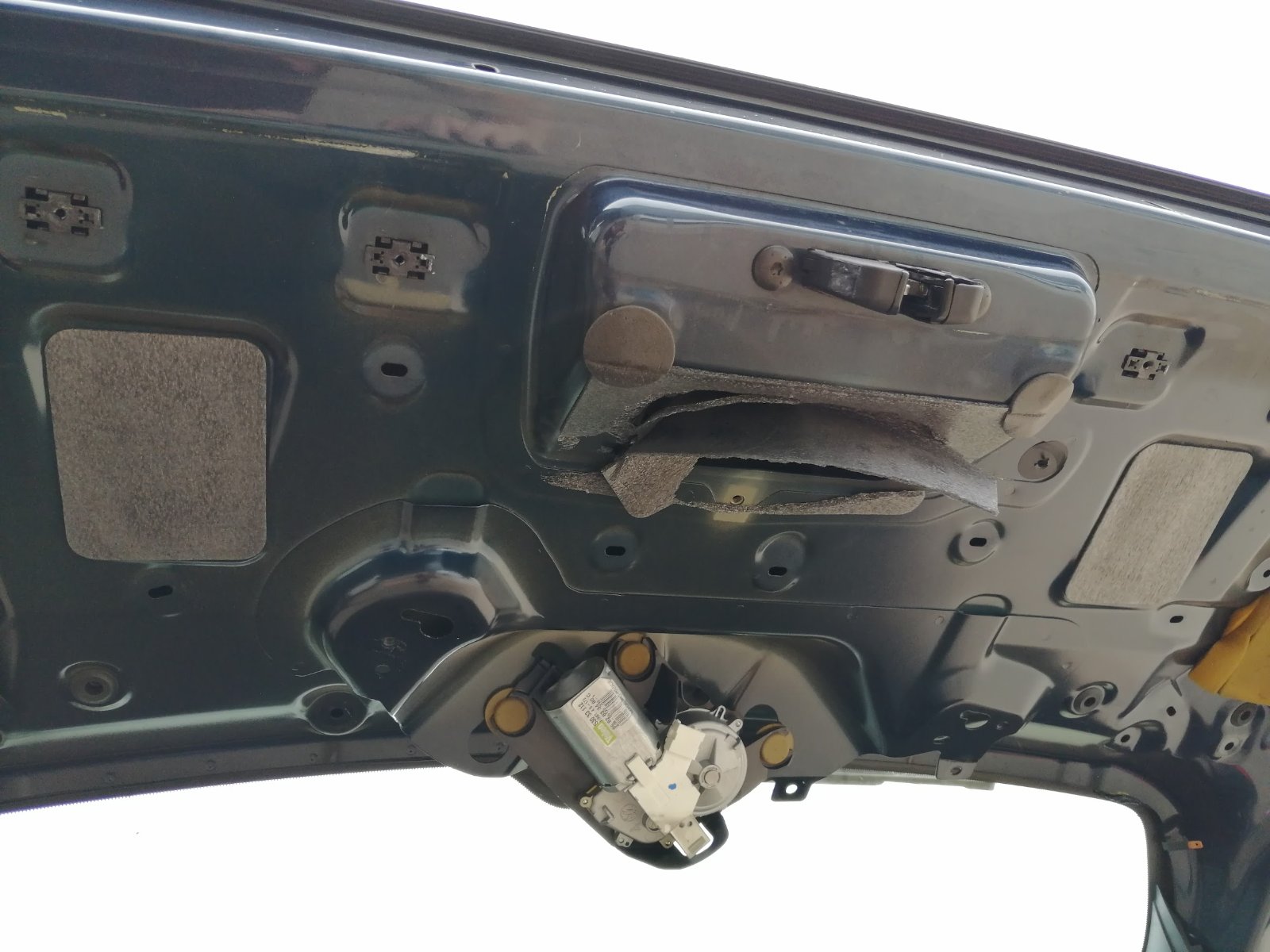

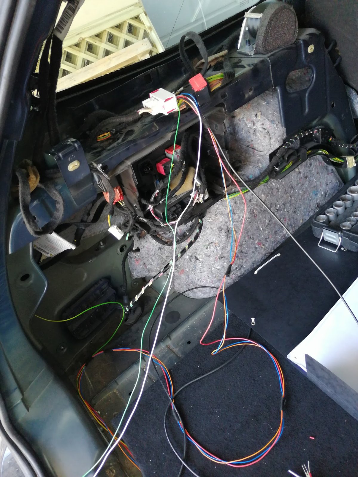

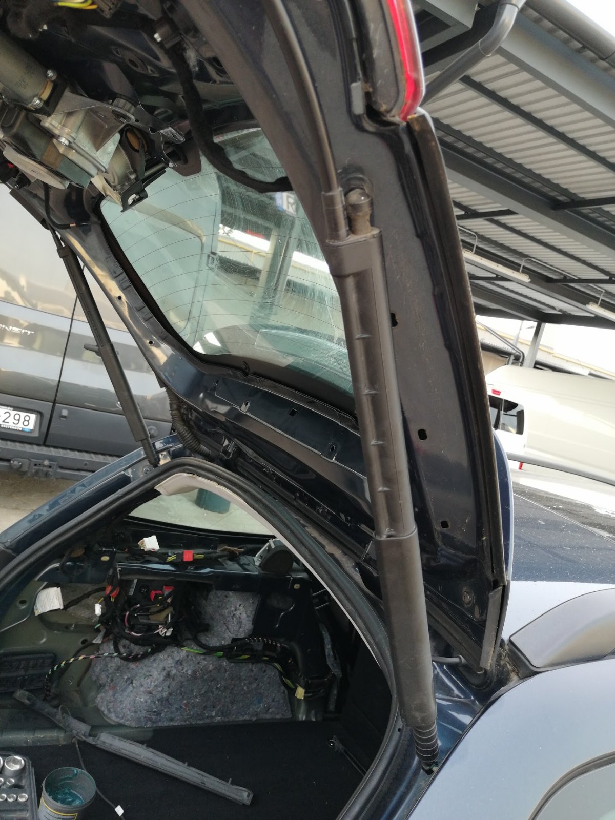

Well lads, i did the retrofit and it works :-D
Sadly i cant add video to this post

Mine came with this feature, i helped my friend dream come true with this.
It can open and close about 10-15 times before eco. Even after you can open and close like any normal gas strut tailgate.
