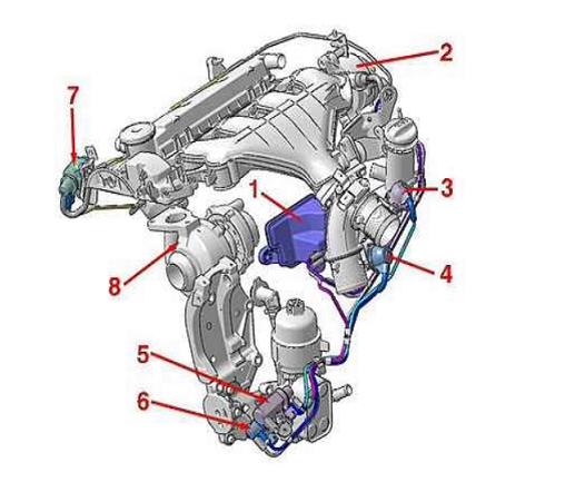

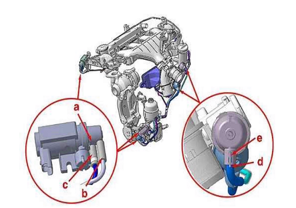

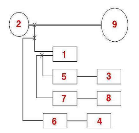

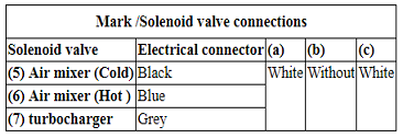

Gav - this may help identify some of the parts:-
| (1) Vacuum reservoir. (2) vacuum pump. (3) Air mixer (Cold). (4) Air mixer (Hot ). (5) Solenoid valve - Air mixer (Cold). (6) Solenoid valve - Air mixer (Hot ). (7) Solenoid valve - turbocharger. (8) turbocharger. (9) Brake servo. | (1) Vacuum reservoir. (2) vacuum pump. (3) Air mixer (Cold). (4) Air mixer (Hot ). (5) Solenoid valve - Air mixer (Cold). (6) Solenoid valve - Air mixer (Hot ). (7) Solenoid valve - turbocharger. (8) turbocharger. (9) Brake servo. |
| The vacuum pipes are clipped at: Oil filter Lifting eye (Left hand ) Fuel pipe clip support Inlet valve cover Solenoid valve bracket - turbocharger | Connections to the solenoid valves : Sleeves (b) without marking for the vacuum feed pipes Sleeves (c) with white marking for the doser controls The sleeves (c) must be connected in relation to the coloured marking (a) of the solenoid valves. The coloured marking of the sleeves (d) must be aligned with the dosers groove (e). |
