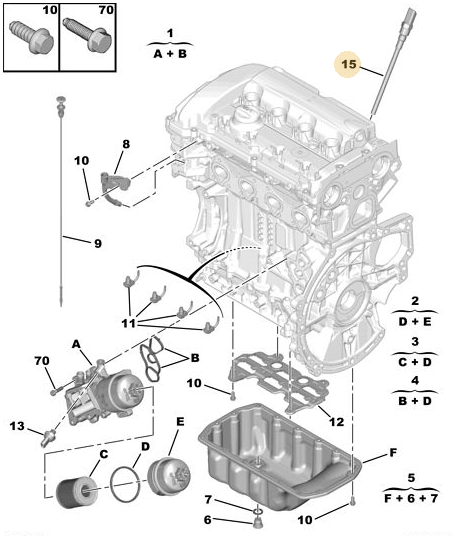

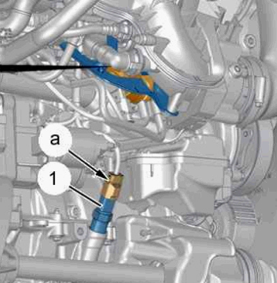

Hi
Does anyone know where to find the engine oil level sensor?
I have recently changed oil and my car is showing 'check engine oil level' and 'engine oil level incorrect'.
I put 4,25l in as it is stated in the book, so I am clueless.
Thanks

Have you checked the level using the dipstick?
The warnings that you are seeing are probably because the oil level is too high.
x 6957
Re: C5 2010 1,6 THP aut. deceleration noise
Item 15 should be the engine oil level and temperature sensor which is at the back of the engine. But as Mike says - always check using dipstick in level ground.
