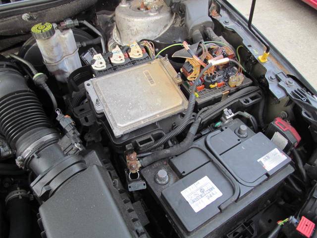

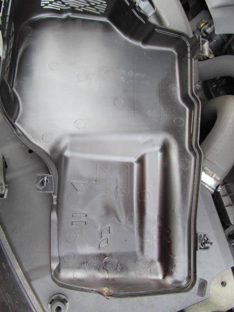

.. and as some of you also are good at getting clues from pictures, here are the other 3 the dealer took:-

Sezza wrote: 07 Apr 2018, 18:07 .. and as some of you also are good at getting clues from pictures, here are the other 3 the dealer took:-
We’ll just have to wait now Sarah, and see what the outcome is. We can’t really do anymore from pictures. The tech was correct, as per my recent post- the BSI is no longer available unfortunately, unless Citroen can source an alternative, or agree to for a second hand one after it has been virginised by a third party.

I'd really like to see the underside of that fuse box... potentially start to track down exactly what's happened. Maybe even give a better idea of what systems might have survived...
If it were my car I'd look to get a new or used fusebox, repair the obviously frazzled wiring, and see whether the BSI etc have survived. It's not impossible...just virtually impossible to find out without doing a lot of detective work.
It doesn't look at a glance like there's too massive an amount of wiring damage - it looks mostly to be local heating damage near the connectors rather than "the full several hundred amps from the battery have been sent through this wire" type damage. The loom will need to be changed to properly fix it...but for the purposes of testing trimming things back and sticking new connectors on should be possible.
My gut feeling on this is that the "event" has been local to the fusebox...a dodgy contact has overheated and then caused a short between a 12V bus line and ground, which has then caused the smoke and melting. The fact that the fusebox is made of self extinguishing plastic is why the whole thing didn't go up.
