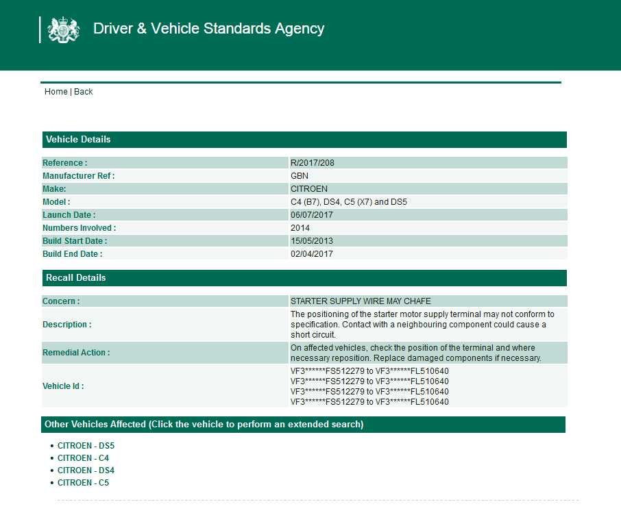

Not related to the OPs car, but a similar fault (short circuit / overheat) seems to be on the recalls list.....
- x 6957
Re: Citroen C5 VTR 160 HDi fuse box spontanously melted
Interesting to know, Bobins, but unfortunately - in the above example, they are using Peugeot VIN references (VF3**************[VIN obfuscated, can be read by forum staff]) - so no good for checking you Citroen VIN.
