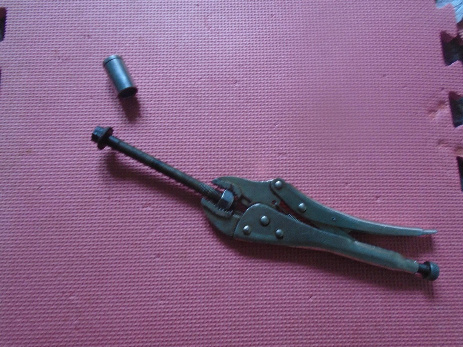

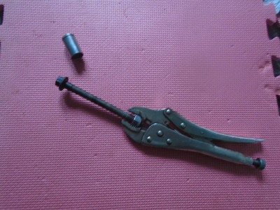

When you say you've had a go at it with a screwdriver - I presume you mean you've put the socket in a vice and walloped the head of the bolt through the socket, and not tried to pry them apart around the circumference ?

bobins wrote: 25 Aug 2020, 18:27 When you say you've had a go at it with a screwdriver - I presume you mean you've put the socket in a vice and walloped the head of the bolt through the socket, and not tried to pry them apart around the circumference ?
Anyway you can think of I have done with screwdriver and hammer. Access to one of those heavy duty bench vices would probably have completed the job but the small clip on vice I have any major force just forces the socket out of the jaws.

Will the socket drop into the piece of scaff tube you've got ? Just thinking about a bit of extra leverage so you can a bit more brutal with it.

bobins wrote: 25 Aug 2020, 19:07 Will the socket drop into the piece of scaff tube you've got ? Just thinking about a bit of extra leverage so you can a bit more brutal with it.
The socket is only 15mm the scaffold pole is more like 40mm. With a simple bolt without the collar around it you could maybe get some action around the rim of the socket. I think the strategy will be a visit to the agricultural engineers see if they have a match in their stocks, if not see if Nissan have a bolt in stock, order one up anyway, and reassemble using Mick's method, and get the socket off the bolt when its done up.

Re: Bargain Basement Motoring
That looks easy to me, use it like a hammer i.e. hold the threaded bit and whack something using the socket as the hammer head turning it as you go.

Gibbo2286 wrote: 26 Aug 2020, 09:29 That looks easy to me, use it like a hammer i.e. hold the threaded bit and whack something using the socket as the hammer head turning it as you go.
WEll I'm sure you have made that work many times Gibbo...thanks for the tip, got to be the edge of the socket I take it, using it like a hammer banging a nail in would just force it on. I'm heading for the agricultural engineers first, I would like to replace the bolt.

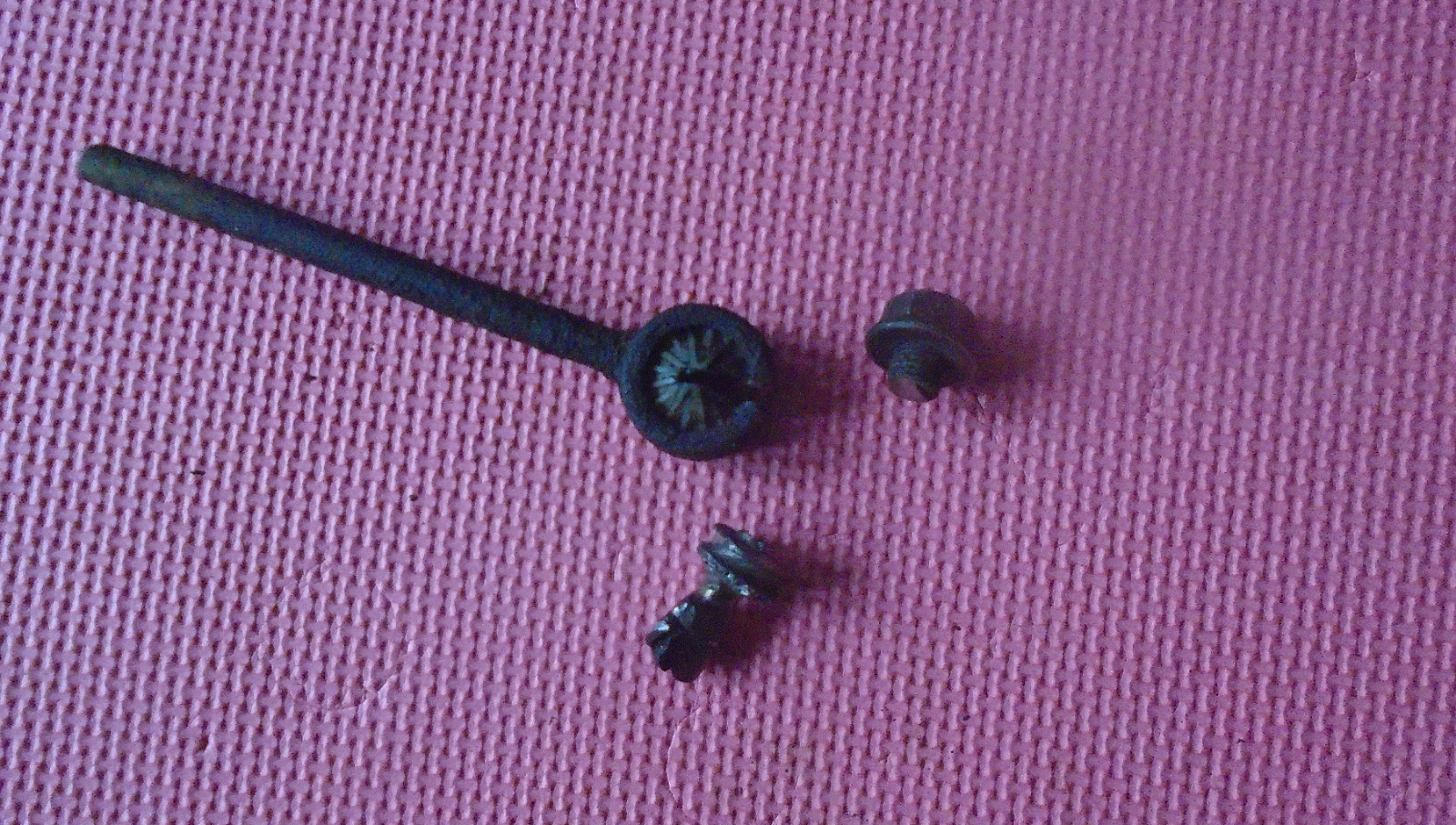

One little thing to do before reassembly got underway.......the bottom part of the drop link where it attaches to the anti-roll bar.
again carefully removed
dont bother with spanners and allen keys only the grinder will ever get these off (IMHO)

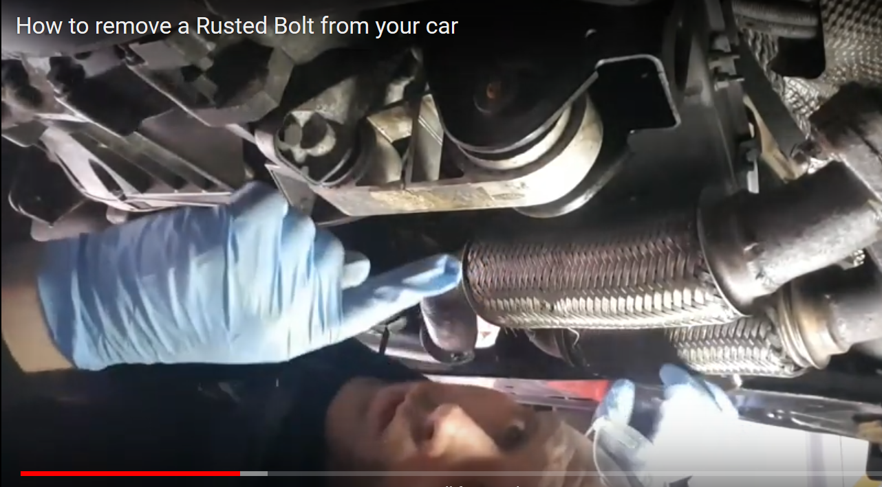

I have watched the odd "remove a rusty bolt" video but when I saw this bloke and the position he was in, and realising that on occasions I have done exactly that sort of thing myself, I thought think once think twice, pay someone to do it!
I have now done a starter motor, discs and pads, full exhaust, coil spring, and lower arm on the BB Micra all in their way straightforward jobs made awful by rusty nuts and bolts. The Airbag fixing was a cleaner job altogether.
https://www.youtube.com/watch?v=a5eloHPqWpU
