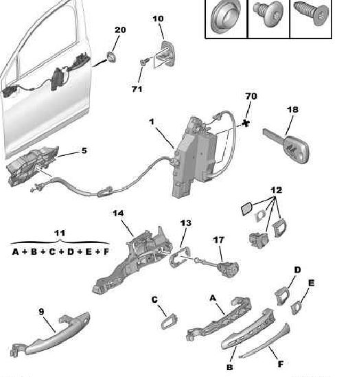

Ok so here are the parts:- Item 1 in the diagram
Original Part Numbers:
Right Side 9136 EG
Left Side: 9135 CX
Replacement Part Numbers:
Right Side: RP 9800618580
Left Side: RP 9800618480

Unread post by centurus2400 »
Thank you most kindly :-D
