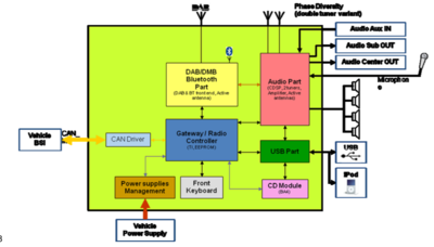

Radio Controller: Texas Instrument TMS 470DSP:
DSP: NXP Dirana2 SAF 7730
Bluetooth & DAB Host: Analog Device BF525
Bluetooth controller: CSR BlueCoreC6 Rom
Operating Temp: -20°C to +70°C
System consists of Hardware modules with embedded software
System is composed of 4 main modules:
  • Radio Controller is master module of the system, it is called Host; It drives AM/FM tuner for analogue radio features
  • Audio processor based on a car Digital Signal Processor; also to provide audio settings and ambiance
  • Multimedia controller for CD, USB and iPod features;
    Bluetooth Core is included in ADI BF 525 processor connected to Host processor, it is called CoDSP. It includes BT stack and profiles (provided by a 3 party supplier iAnywhere). It is connected to a HCI controller to provide BT connectivity features
  • DAB Core (optional) is also included in ADI BF 525 processor. It is connected to DAB tuner to provide radio digital features.

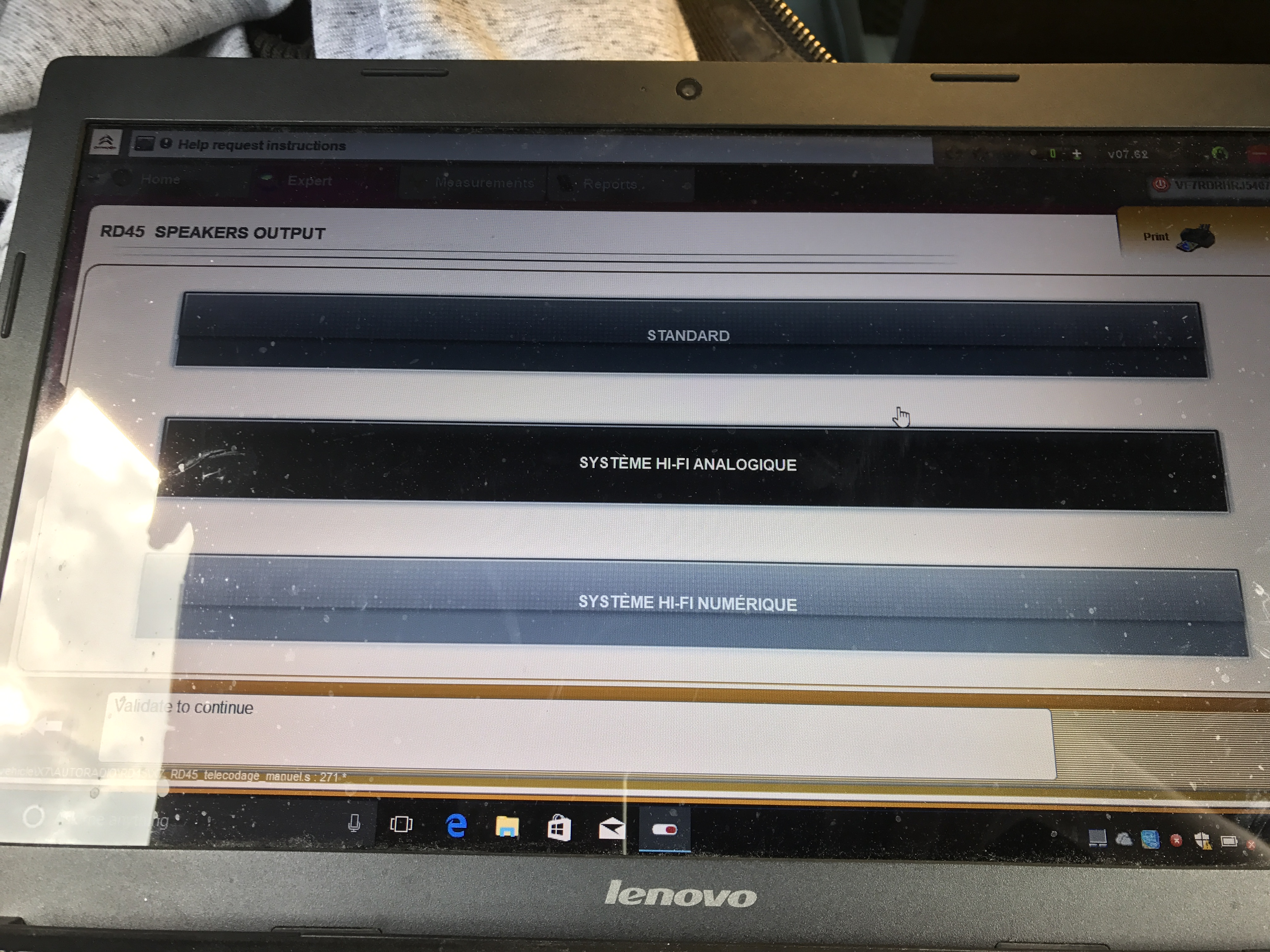

4x23W sounds about righ to me, I'd really like to upgrade to an external amplifier ideally as I'm happy witht the other features of the RD45, especially the Siri function for my iPhone. And luckily I don't seem to have any issues with the Bluetooth streaming
I'd rather not have to use speaker to line level connectors to be honest, thats why I was investigating the possibility of a line level out from the RD45 in Diagbox.

This is the menu that seems to allude to a line level out on the RD45.
System Hi-Fi Analogique....
I haven't plucked up the courage to change it from standard yet to see :oops:

I'm not sure what would happen either - but my guess would be they either will or won't work Elis - Go on, I dare you!

That's interesting. Maybe it is used for activating subwoofer? I believe that there is no subwoofer in standard version of sound equipment - that is why you have to activate it... Who knows... :)

In my mind, the "analogique" option would output line level not speaker level outputs for the four speakers....
If that’s true then i can buy "quad lock extension cable" and cut the speaker wires interposing an amplifier in the middle....simple
I'm guessing the "hi-fi numerique" refers to the proper JBL optional amp package that’s has audio delivered over the CAN? ( that’s a complete guess btw)
The lexia has been put away for today haha, when I have more courage I'll give it a go :-D
