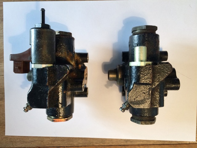

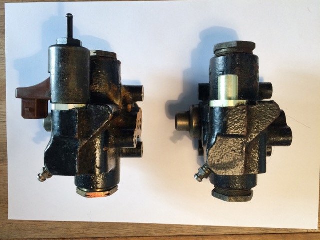

Hello, I was thinking to join the party regarding this upgrade ;)

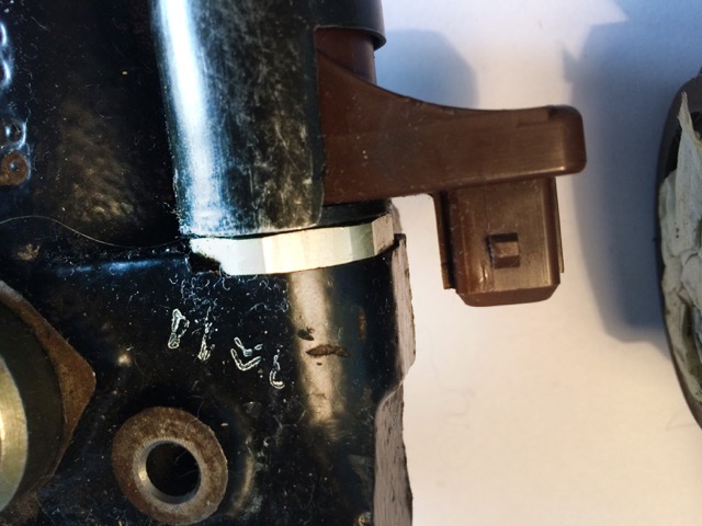

I have just bought two Xantia units and are preparing to fit these to my XM 2,5 Break -95mod.

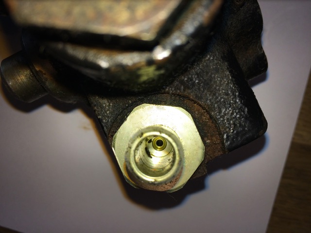

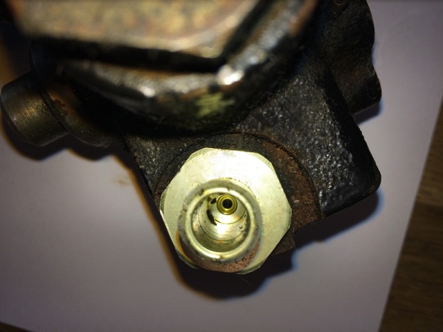

- What tool do I use to unscrew the hydractive valve ? Can it be unscrewed as a whole unit ? It is not much space for a flat spanner, hardly 1 mm at the back of the nut.
- Where can one find the O-ring seals, what size and what material are they made from ?
Regards
Lars
Norway
Posts: 54901
x 8265
Re: Evolution: Xantia Hydractive Suspension Regulation - Info
Welcome Lars :D
You only have half of the Hydractive electrovalve in the block there in the fourth picture...
In the case of the complete valve I use a 16mm socket on the top hexagon by the leakoff spigot and hope it unscrews the whole valve. Fi, however the base stays in the block and the the other half comes apart - as in the fourth picture - I then use a ground down deep 24mm socket. The edges of the socket need to be ground quite thin so the socket will fit.
If the valve separates into two halves when trying to remove it then do not worry but take care to note very carefully the sequence of how the internal components fit. If you don't then I can supply a picture to show how it goes back together.
I do not know the O ring sizes but i do know the larger of the two green ones is the same size as under the hydraulic pump piston covers. The small one is not available as a part but a kit of assorted O rings should provide a suitable one. Just check it is safe for use with LHM.
If the O rings look OK they should be OK to re-use... I've rarely had to replace one.
Hope that helps...

Yes, follow Jim's advice on unscrewing the EV.
I was lucky, and found that the end/top black hex nut unscrewed the complete EV on both old and new valves. If I remember rightly, the two halves of the EV are actually glued together during manufacture, and getting them apart is normally extremely difficult or almost impossible.
You should be able to reuse the original green O-rings, which are unlikely to be damaged.
I guess you are going to reuse your original EVs from the car in the 'new' late-tupe Xantia valves. That's what I did, knowing my own EVs were working fine.
Undoing the top hexagon usually allows you to remove the complete electro valve unit. The two halves the unit consists of are indeed glued together, as Chris says. When working on one of those newer hydractive blocks a few months ago when trying to remove the EV from the block it came apart with a bit of force. The other half stayed stuck in the block. I used a punch and a hammer to undo it.

Presumably the punch and hammer destroyed the bottom hex as it is only soft alloy ? I would consider that a last resort to remove a faulty one not a way to remove a good one.
The bottom and top half of the electrovalve are threadlocked internally - as long as the threadlock holds you can undo it via the hex at the top. If it breaks free a face ground socket is needed. A spanner usually won't work on the bottom hex and will just round it off as it is so thin and soft.
Not at all. It was a strike well placed and it just left a small notch :-D

Today I fitted the later type of hydractive valve to the rear of my XM. Contrary to Chris's advice I did the job lying on the floor with the car on axle stands. This made things a little more awkward.
One thing that Chris does not seem to have mentioned is that on the XM, the mounting bracket for the rear valve needs to have a corner cut off to allow the bleed nipple on the later valve to fit.
