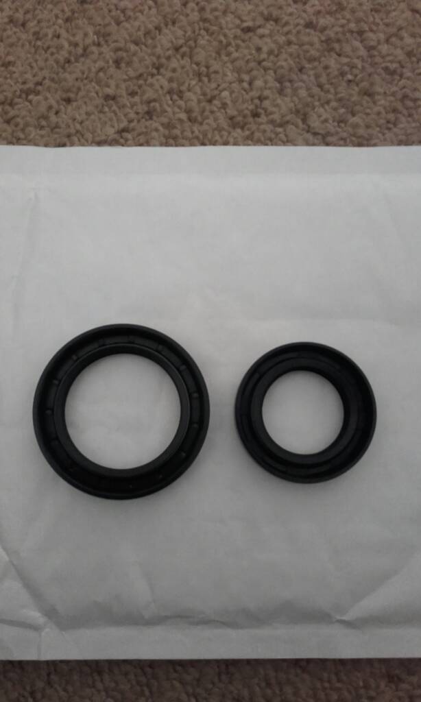

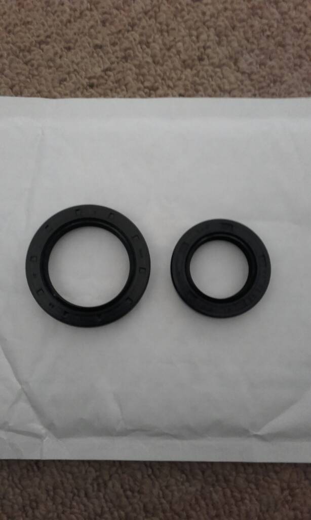

Still waiting for the clutch to come. Meantime do these driveshaft seals look correct?ImageImage

Those seals look right to me Davie, they are different sizes so that's OK...

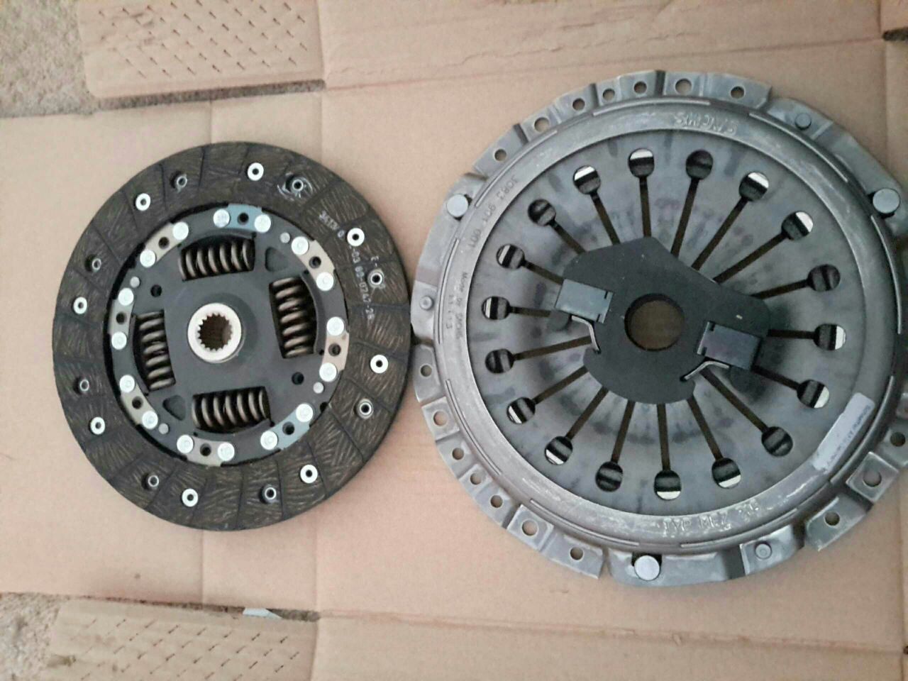

It is here. I thought it was a 3 piece clutch kit, but there is only 2 pieces unless the bearing already on the pressure plate is counted as piece 3Image

No, no , no that's wrong Davie, that's NOT a TCT clutch!!!
The TCT clutch MUST be a three-part as the release bearing is not clicked into the diaphragm until the very end when it's all back together using a special tool..
That looks a little like a 1.9TD Pull clutch to me and even then the release bearing looks a bit wrong...

^^ what he said...it's a wrong un unfortunately! Who did it come from?

Fxxk Fxxk Fxxk!!!!!!!!!!! It's a clutch for a 2.0 16v 150hp. That's what comes up when I put in my reg number. It's from Mr Auto. There is one for a 2.0 turbo 147 which is a different part number. When I get on their website, which has a glitch just now I will get a label to print off to take this one to the post office to return, and get to order the correct one which is £40 more expensive. Right now I am very irritated and stressed.

8V Davie ... oops. Not wanting to stress you any further.

The correct clutch for a 2.0 8v turbo 147hp now ordered. I had to get a day when Mr auto computers went down just to fxxx my head over. I'm not great with technology at the best of times and worse when stressed.
