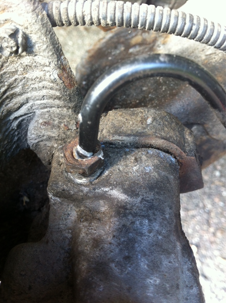

Brake line appears to be twisting as we're undoing the 11mm bolt, is this normal or are we doing it wrong?

Looks like time to stop now Ben, maybe ask your garage on Monday. It shouldn't twist like that, looking at your picture the pipe doesn't look straight and the corrosion isn't helping matters. Sometimes you have to untwist the caliper rather than unscrew the fitting. As the stud is broken it gets a bit more difficult. The chances of having to replace a portion of the solid brake pipe are increasing considerably for you. I think it will now save you time and aggrivation to back off and seek help or you could end up with a split brake pipe which is no fun, even if you have the flaring tool.

Pipe corroded fast into the threaded fitting - that's another place that drenching with release oil will help.
It is probably weakened now and will eventually fracture even if it comes out more or less whole.
I ended up replacing every pipe - brake and suspension - on my GS due to that. Lots of fun and the pipes cost more than I paid for the car.
It started with a brake disc (rear) that needed replacing.
You may be able to cut that pipe and put a repair piece in - likely a workshop job as it will need a flaring tool. Fortunately the C5 - I am reasonably certain - uses standard brake pipes rather than the previous dedicated Citroen ones.

It's more the pipe thats a concern Ben. If you want to do it yourself it's not actually that hard but you will need to get hold of a flaring tool, a cutting tool, pipe, an end fitting and an inline fitting. I don't know the sizes for the C5, but someone will.
I wouldn't worry about a calliper yet if it's not leaking. Often the corrosion can be chiselled off and the calliper side sanded smooth. You are likely going to have to wait for the flaring tool etc though so it may be wise to order a calliper just in case.
Where are you up to now? Is the second bolt all the way out?

On the other bolt front, we were hoping if we could get the brake hose off, we could hopefully get the caliper off, then get the bolt out by hammering it or so, however it just won't budge, you can turn it either way. We tried using a grip to try to pull whilst turning the bolt, but it just doesn't seem to want to move any further out. You can turn it either way with a torque wrench, but still not a spanner. I don't want to whack it forward with a hammer just in case the thread on the arm is corroded so wouldn't want to damage that. I have tried giving it a tap with the hammer from the sides though to no avail. Did buy something similar to the Aston super wrench today, but never got the caliper off to try it out on the sheared bolt.
Is it worth trying to do the brake hose back up again? Or would that potentially snap it?

I think your options on the remaining bolt are:
1. Heat
2. Impact wrench
3. Hammering outwards
4. Heat combined with either of the other 2.
I'd focus on the bolt first as it's in the way of the next steps. If you're unscrewing it and it won't come outwards the threads are undone. It's the rot and thread lock between the calliper and the bolt stopping it moving. The rot is white stuff caused by galvanic corrosion rather than your traditional rust and hammering out should do no harm.
Once it's out you may as well just undo the fitting or cut the pipe accepting that it's worth replacing now and makes life easier. No harm doing it back up right now, but if it's not leaking I'd be inclined to leave it alone.
The calliper will need persuading off a bit, probably a decent tap with a soft hammer.
Then onto the broken stud, heat on the thread bit and your new grip should remove that relatively easily compared to with the calliper there.
The pipe repair should be a nice job for you after all of this, the flareing tool is quite satisfying to use.
The caliper shouldn't be terribly hard to clean up. If you can get that bolt out you'll be able to assess it yourself before ordering another.
