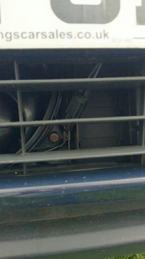

Second - Check the cooling fan and... Seized.
I could force it over, then I would get about 30 degrees free run and it would seize again. It's not catching on the housing, it's the bearing/motor part that's mechanically seizing.

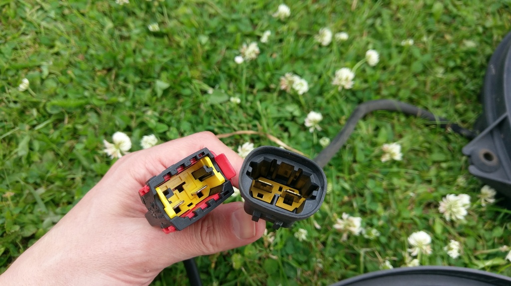

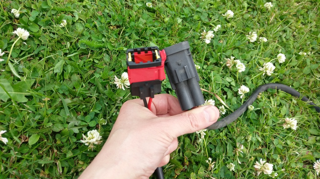

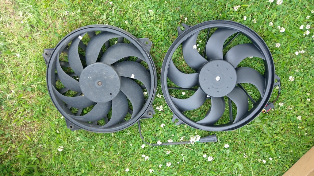

Yesterday I set about fitting it and... #-o it's the wrong one :roll:
Wrong number of mounting points (3 vice 4)
And wrong electrical connector;
The details (photo and part drawing) on the website are correct, part number on the box is even right. looks like the wrong item packed in the box by the oem. Frustrating... Have to see what they can turn up for me next week.

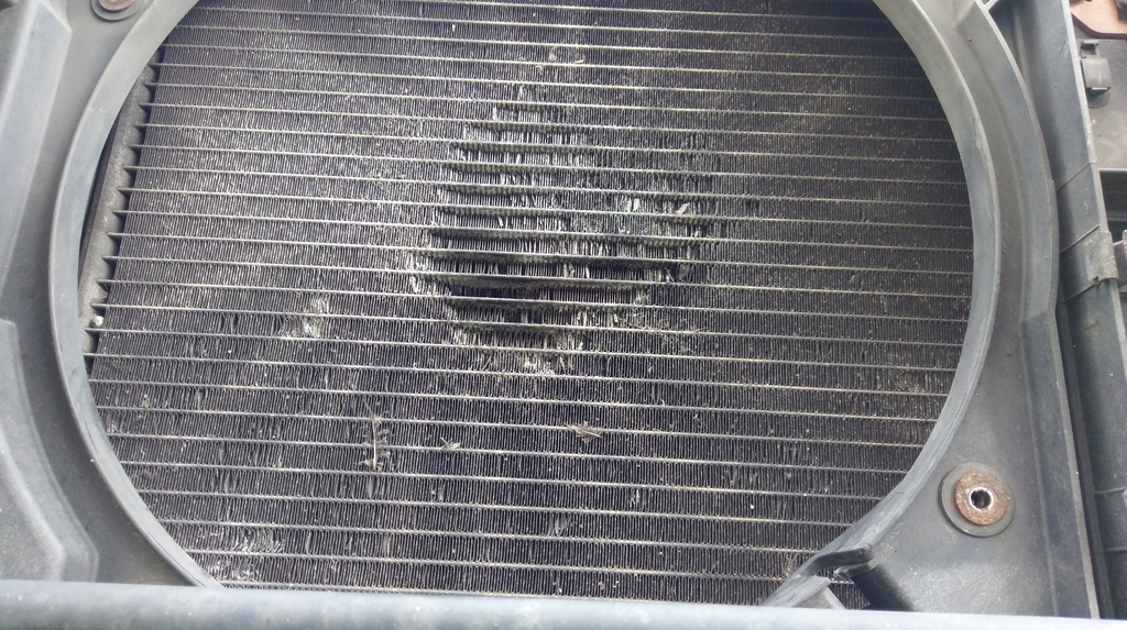

Took the opportunity to change the second hid bulb though (pax side is a nightmare without taking the headlight unit out of the car) clean out the rad area and vac the condenser fins clean though. Condenser isn't in great shape where it sat behind the fan motor. I guess it gets no air flow there, so just ices up continually, which will do the aluminium no good.

The condenser runs hot, so it won't be icing up.....

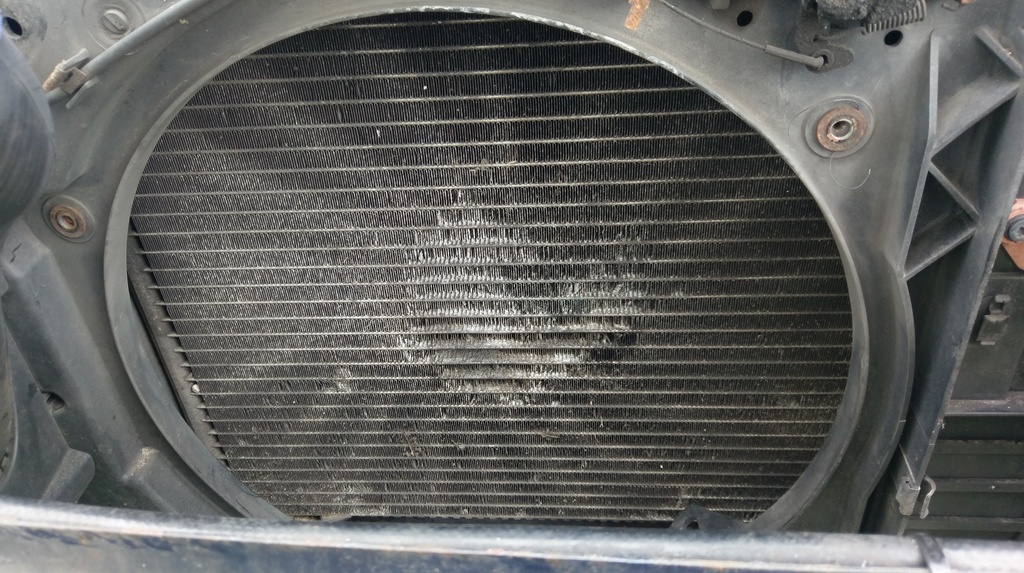

Yes, you are right... I was thinking of building a/c systems when they work as a heat pump (run in reverse to provide heat as well as cool). In which case, I'm a bit lost as to why it's corroded behind the fan boss then! :-k maybe no air/rain flow means road salt doesn't get cleared away from it, so that builds up instead?

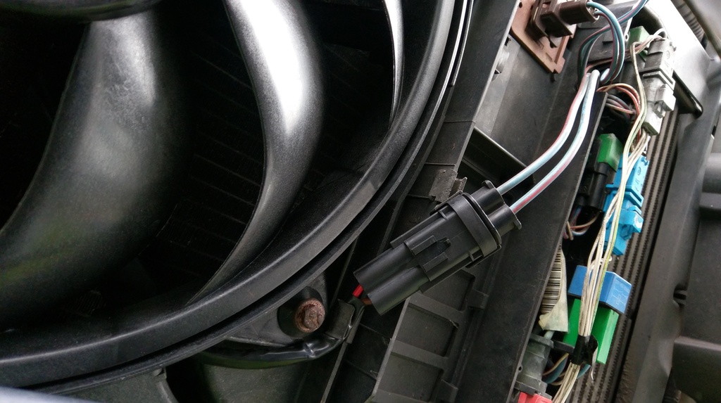

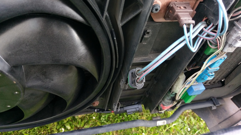

Fan fitted fine and the correct connector, but as someone else mentioned recently, the tails for the plug were a lot shorter, so it's not possible to refit the plug correctly on its original mountings.
This shows the length of the new plug at the bottom, taking the route it should and the top plug on the car side, pulled down further than it should be - big gap still;

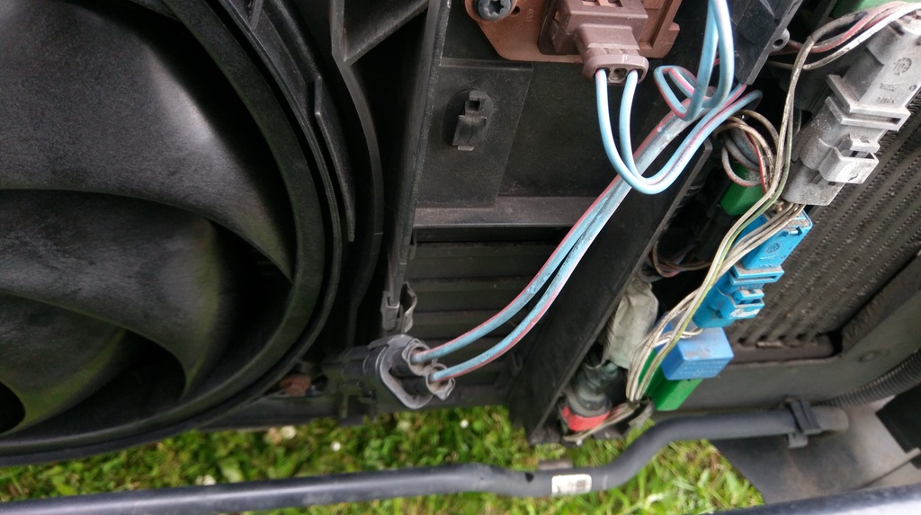

Only solution was to further re-route the top part (re-route under the only wires where it comes out from the Relay box) and the bottom half, where it comes out of the fan frame onto the front panel;
I was able to move one of the cable clips so that it least the bottom part was still held and not completely flapping about;
It's far from ideal. Cables aren't pulled bar tight, but still too tight for my liking, plus the plug is now exposed to the open part of the grille and not secured (itself) to the front panel;
The only proper solution is to extend the wires, but it was starting to rain, so I wasn't in the mood to be getting on with that... I have cut the full length of the plug/cable off the old motor so I can use that to solder on and extend someday in the future.
