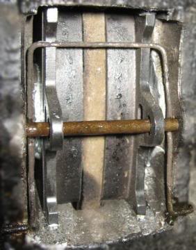

You can start by checking the condition of the brake pads. Fronts first and then rear ones.
Front:
- Check if both pads have about same thickness remaining,
- Traces of any unusual carving, grooves formed on the disk
- Is the caliper sliding easily. If not some brake grease under the seal.
Rear:
- In addition to above first two items, check if the top parts of the brake pads are touching each other.
The pads might be carved like a profile of upside down "L" letter. This happened once with mine.
Finally brake bleeding would do fine, especially the rear dead ends will be free of air bubbles.
