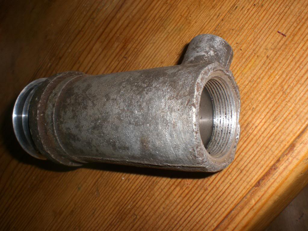

Sorted the drip. I had accidentally punctured the rubber seal right at the pin end which was causing it to weep slightly. I've cleaned it up, used self amalgamating tape and a couple of zip ties and that seems to have fixed it for now... I'm sure its just hiding more problems .. but its only got to last about 7 or 8 days till the others arrive.
I've been thinking about Richards idea to mill a suitable collar for the size of the cylinder and then mill the cylinder down and weld the collar on...That would be much more sensible than building up the aluminium with a weld as I had done...probably less heat as well.

More thoughts on the puller - you only need one eyebolt of course, and just hook it into the loop. Depending on the thread, you might need to use a spacer (eg a socket) against the bar, and you also probably want to be able to hold the eyebolt against rotating, otherwise it will just go round and twist the pin eye off.

c.morewood wrote:Sorted the drip.
Excellent :-D
c.morewood wrote:I've been thinking about Richards idea to mill a suitable collar for the size of the cylinder and then mill the cylinder down and weld the collar on...That would be much more sensible than building up the aluminium with a weld as I had done...probably less heat as well.
Happily, Neil (Newcastle Falcon) has donated two scrap cylinders to me for the purpose of experimentation and trying out this idea...
I shall report back in due course :wink:

I was wondering how to test the repair, Jim. You don't want to be removing cylinders to do a test! Came up with an idea - fit a sphere, put some LHM inthe ram and then stick it in your bench press 8-) This will allow you to squeeze the ram up and apply the pressure to the seal. You will of course need to block the inlet port, but this could be done with a soldered up pipe - or better still a pressure gauge as that will allow you monitor the pressure so you don't overpressure it :lol: You will of course need both bits of the cylinder to do this....
