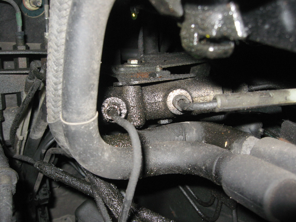

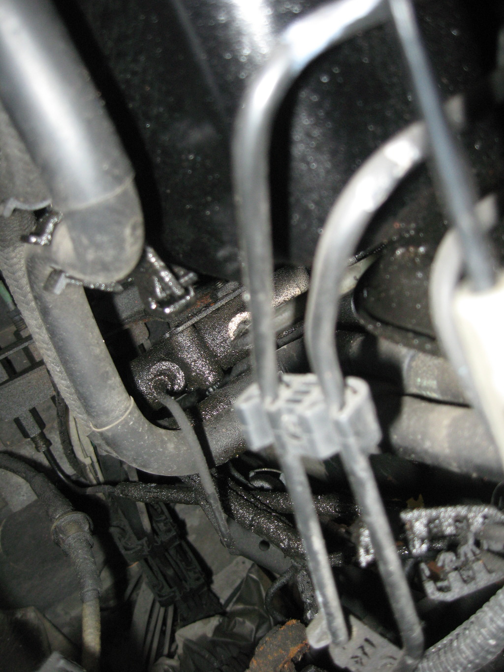

Right then im guessing that this is the safety valve and the pipe I want is a 9mm underneath? ( haven't quite found that yet), is it defo underneath and is it the only 9mm?
closer
Best way of getting to pipe? remove lhm tank? there isn't much access from beneath. (in fact I think the car has sunk even lower??!! I now have to wiggle underneath) But i'll go have another look from the wheel side rather than central.
thanks
edit
removed air filter housing properly again. Pipe leading from air filter housing around engine is cracked..and has oil in (turbo leakage again? as there was oil in other pipe too?? I swear it sounds fine when running!).
closer

are you sure its the pipe leaking, as the unit those pipes go into looks like the anti sink valve,
and they are famous for leaking at the O ring under the end cap
Regards, malcolm.

Re: Sinker xantia scrap or keep, bosch fuel pump issues...
no pipe is ok except stuck/seized on pressure reg as above due to someone over tightening and rounding hence trying to get it off at safety valve end.
is this the safety valve? if so then I needs to disconect the pipe at that end and remove as part of the pressure reg then measure and get a new pipe (assuming you cant find a new pipe on service citroen!) lol im guessing they've been discontinued.
doesn't appear to be any leaks around the above component though difficult to tell as someone's been sloppy at refilling the tank!
thanks
thanks

i still think the unit shown in your picy's is the anti sink valve not the safety valve,
the safety valve has a pressure sensor screwed into one end, as that is what puts the hydraulic warning lamp out once system pressure is reached

i couldnt remember were the safety valve is situated on a XANT but Paul ( citroenxm ) described were it is in his post towards the top of this thread,
he said if you look under the wheel arch you can see it below the hydraulic tank,
the safety valve is just under the tank, so the S/V must be a bit further down,
i hope you aint cut the wrong pipe/s
the screen shot dose not show the curly sections but they are in there in reality
which rubber pipe are you trying to get off?????

did you fit the seal into the reg first, or did you try fitting the seal onto the pipe first, the later is wrong,
the other thing can stop the metal spout at the end of citroen hydraulic pipes going into there socket is, if on removing them you slightly bent the spout between the start of the thread on the flare nut and the tip of this spout,
if this happens to me i find a ring spanner that fits onto the spout but not over the flare nut thread, and use this to ease the spout stright and inperfect line with the thread on the flare nut,
not so easy on 6.35 pipe as it is on 3.5
sorry i wernt sat at me complicator waiting for your shouts for help
, but i had to got and collect her who thinks she should be obeyed from work
