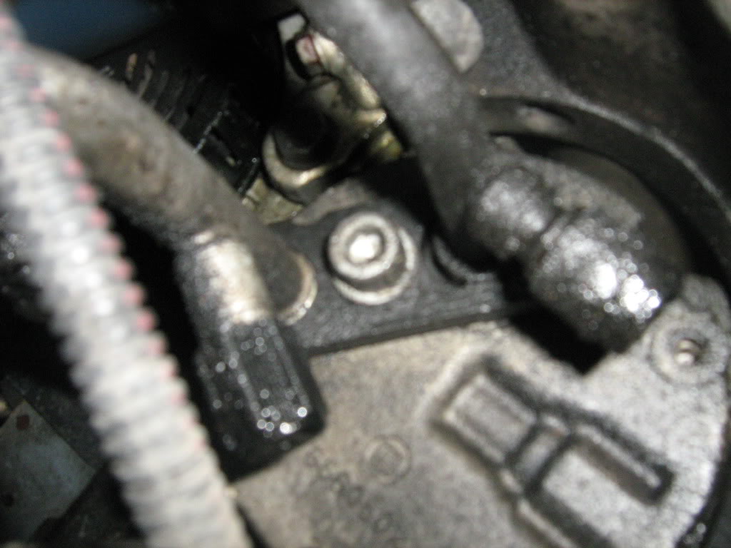

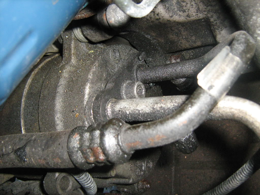

Hi Guys
here's photo's of my a/c comp from the rear
This is a delphi 1135290
Kenny
Sorry guys faux pas will sort it on my return
Kenny

Fixed the images (although they're huge!)
Naughty photobucket.
So 5290 is Delphi plate, and 5253 is Delphi screw on.
I would hazzard a guess that 5290 and Sanden, despite being both plates, might not be interchangable.
Unless we find that Sanden comes in both flavours.

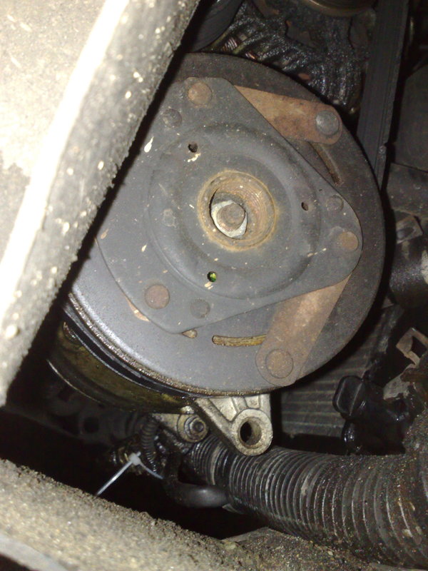

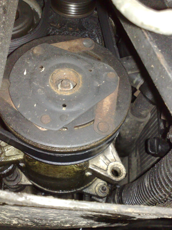

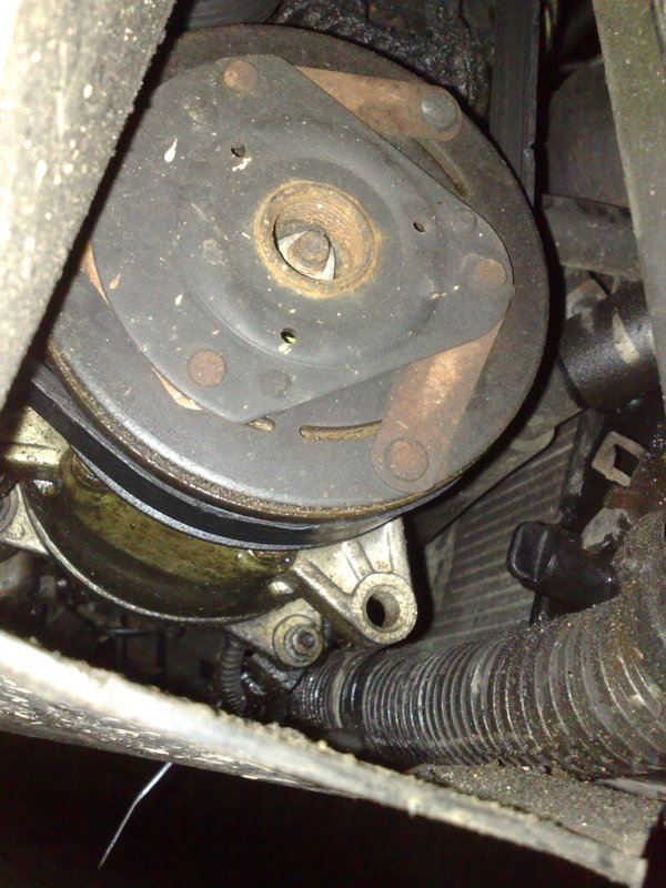

ugh, I can be such a fool sometimes...
Right these are the correct pictures:

oh, hang-on.. in my haste have I got the right bit?... one sec...

yup, sorry. I thought that looked completely wrong while posting.
Right.
Re posted back up with correct pictures
Right.

Booooooooo-yeah!!
Cool. We're still leaning towards a Delphi unit then with the triangular shaped plate.
In. Your. Face Kool-Aid man!!
(sorry, I was hoping we were going toward Delphi as I've already ordered the 1710mm belt for the three point alternator and delphi combination as I needed to get it on-time for weekend)
