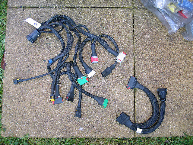

Just as an aside, the lexia references a harness tester function. Anyone seen or used this, I'm assuming it came as an expensive add on to the workstation. Maybe it could have helped. What exactly is it? My lexia came with so many cables that I haven't really got a clue about, perhaps I have the functionality without realising .... I recently discovered that I DO have a battery cable to power the unit after months of using it by running it off its own internal battery for 10mins at a time, doh!!

superloopy1 wrote:Just as an aside, the lexia references a harness tester function. Anyone seen or used this, I'm assuming it came as an expensive add on to the workstation. Maybe it could have helped. What exactly is it?
Its an additional tester on top of the standard Lexia either by way of a manual tester looking similar to an old telephone exchange or an automatic one as fitted to Lexia 2 in the basestation. You then need numerous harnesses dependant upon what you are testing, it allows you to test the wiring/resistances etc relevant to the ECU. You then need the original Citoren workshop manual for the relevant ECU to see what the original values are, useful as it allows you to test items which may be suffering from a duff connection that doesn't show up when you pull the connector apart. It also allows you to test every component directly from the ECU. I have both versions of the harness tester and a full set of leads but have rarely if ever used them other than 'playing'.
Its an additional tester on top of the standard Lexia either by way of a manual tester looking similar to an old telephone exchange or an automatic one as fitted to Lexia 2 in the basestation. You then need numerous harnesses dependant upon what you are testing, it allows you to test the wiring/resistances etc relevant to the ECU. You then need the original Citroën workshop manual for the relevant ECU to see what the original values are, useful as it allows you to test items which may be suffering from a duff connection that doesn't show up when you pull the connector apart. It also allows you to test every component directly from the ECU. I have both versions of the harness tester and a full set of leads but have rarely if ever used them other than 'playing'.
Where does the harness tester component 'live' on a Lexia 2 and what does the harness tester leadset look like i wonder?

superloopy1 wrote:Where does the harness tester component 'live' on a Lexia 2 and what does the harness tester leadset look like i wonder?
It lives under the platform the Lexia sits on, the connectors are on the back, two large round sockets which connect to a 'Y' shaped lead that connects to another lead such as one of these for instance;

I've got a harness tester :) , i've just checked.
Now then, is this going to be of any use to me in the longer term given that i've also got a rat's nest of cables which mean little or nothing to me and i've got no ecu manuals that you refer to.
Any info on what to expect if i connect it up and how do i start playing with it, seems a nifty little gizmo to have if i can get some knowledge to go alongside. The cables do have reference numbers on them, any chance you have a cross reference to what's what?

superloopy1 wrote:I've got a harness tester :) , i've just checked.
Have you got the 'Y' shaped harness? You need that to connect the tester to the relevant breakout harness then connect that to the ECU. IIRC you'll need a 55 pin harness for an Activa which without checking I think has a blue block? The relevant engine manual will have around 10 pages of info. Let me know if you have the 'Y' harness and the one to connect to your ECU and I can dig out the relevant info from the manuals.

DickieG wrote: Have you got the 'Y' shaped harness? You need that to connect the tester to the relevant breakout harness then connect that to the ECU. IIRC you'll need a 55 pin harness for an Activa which without checking I think has a blue block? The relevant engine manual will have around 10 pages of info. Let me know if you have the 'Y' harness and the one to connect to your ECU and I can dig out the relevant info from the manuals.
Richard
I've checked and do have the ecu breakout box, numbered 4126-T 55, and it's blue!
Not so sure about the 'Y' harness though, what's that like? Is it in your picture?
I've got a lead about 3metres long which is double ended, yes?
I'd appreciate a picture so that i can take another look in the rats nest of cables :shock:
What facilities does the harness tester give you? You'll see from the previous post that I haven't got a clue how to go about this but i am learning slowly. I can even make sense of the circuit diagrams moreorless :wink:
